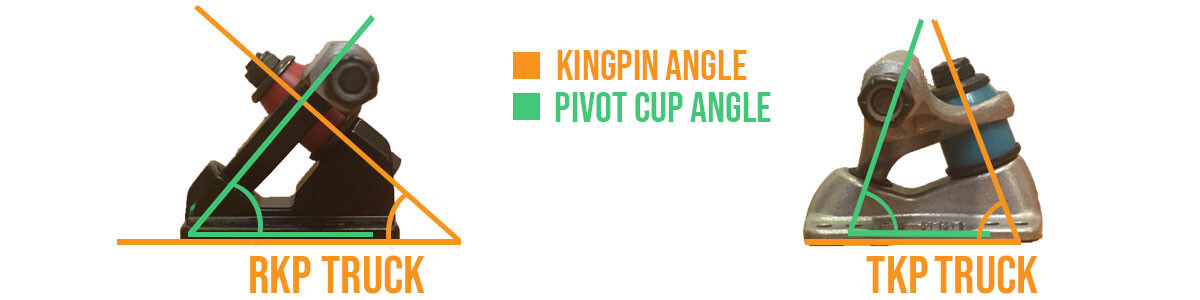

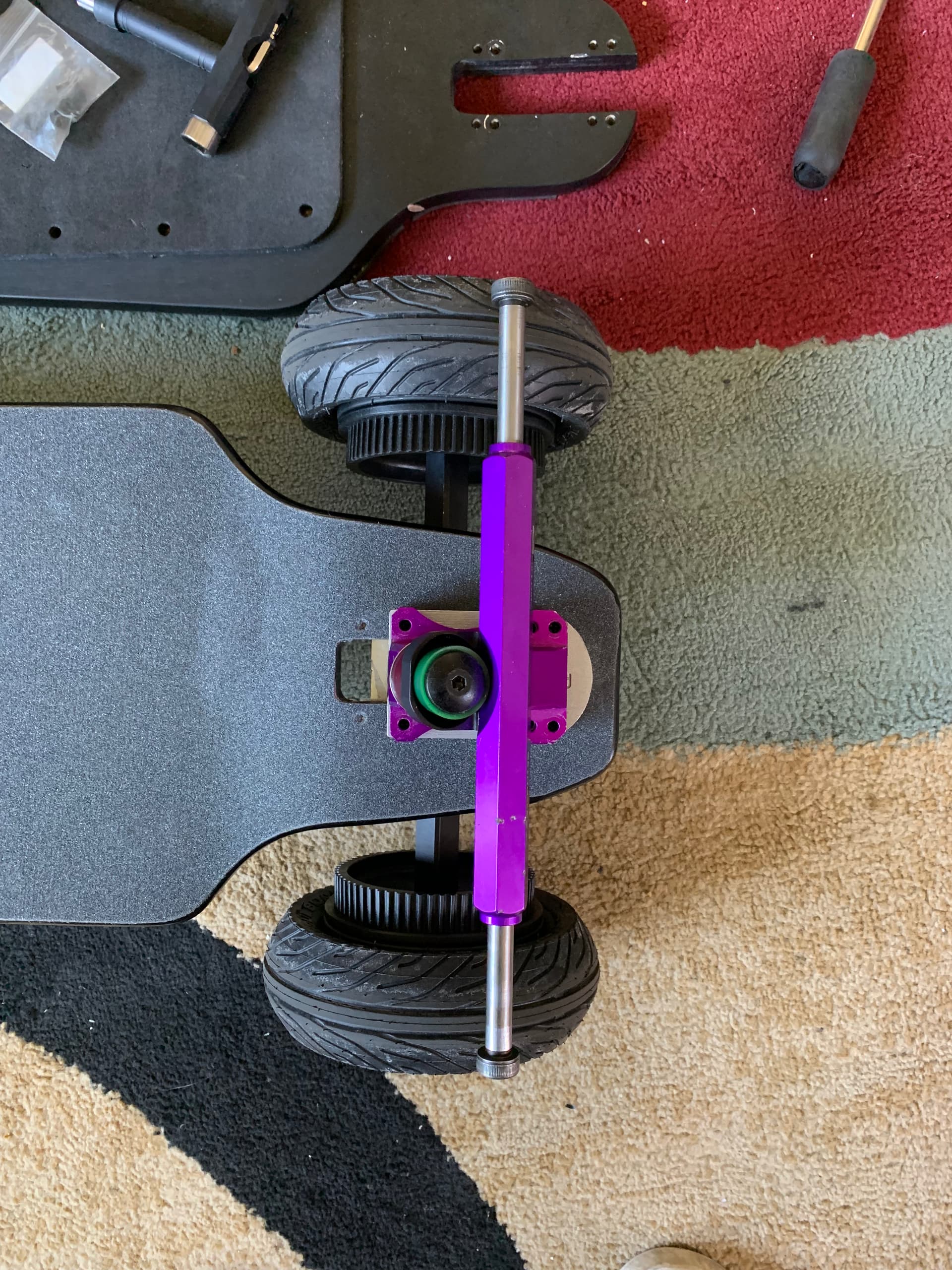

Have you ever wondered why evolve and all the similar prebuiltboards use double kingpin or tkp instead of reverse kingpin trucks?
It’s because RKP trucks murder your wheelbase. You lose ~1.5” on each side, even with Paris baseplates.
Welcome to wheel bite, shoe bite, motor mounting hell.

Yes. But the other huge reason IMHO is “marketing”. Two kingpins must be better than one, right? I’m legitimately surprised there aren’t any 3KP out yet. Because it doesn’t actually matter what’s better, it only matters what sells better.
throw some rod ends on and you got a deal
Why exactly is that a problem? if you want a longer wheelbase, just get a longer board lol.
It’s not so much about wanting a longer board. I’m just pointing out the issues that RKPs run into when you want to do drop thru mounting, regardless of how long your board is. The axle is much closer to the inside mounting holes with RKP, and a longer board can’t address that.
