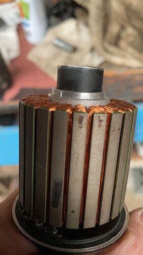

Mhhh dude, I thought it was a solid axle through the whole hanger :thinking:

Defiantly come apart, I put a bearing retainer on the Id and od of the big bearing and the small. Otherwise the stator slides in and out,
Was looking at puting a shim between the stator and the smaller bearing

Yes, they can come apart, but they are not sold as self-serviceable and the method to get them open is not reasonable unless you’re very determined to fix an unserviceable product
At EOD though we’re talking about the motor falling off a completely assembled product, advertised as just bolt on, without any maintenance advisement, I personally also thought the axle was one piece making this impossible.

Yes I was determined to fix.
@torqueboards are the motor parts - bearings, stator, rotor loctite together to stop movement, as there appears to be nothing stopping the rotor sliding a couple mm over the stator, leaving the windings almost rubbing on the end plates of the motor case.
I have reassembled with loctite 609 and it appears to be stable now.
What about a shim between stator and the small bearing, to make the entire assembly non compressible. Then when the wheel nuts are tightened all it’s doing is pushing the entire wheel /motor onto the axel?

@Kram720 I’m assuming you got the very first version released? If I’m understanding you correctly. Last few versions this was fixed.
@worldismine772 We do apply red loctite. It is also possible to break the loctite seal as well and/or the loctite seal didn’t set in time. Will include more details on maintenance. As I said, I’m sorry it happened to you glad you are okay. Injuries are no joke. Please do check your board even if it is our QC that has failed.
