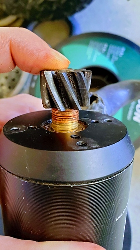

Agreed. I wasn’t told that helical gears need to ditch the circlip and stack washers to prevent slipping can syndrome.

Really, it should be one perfectly sized washer but who’s got a lathe and aluminum stock tube laying around?
Not me :weary:
:raised_hands:
no 3D printer though
Yeah yeah, rub it in. Lathe is high on my list of tools to add to my workshop.
It’s just the tool costs that come with it that make me wince
I found that 10mm bearing spacers work pretty well. Still might need a lathe to get the right length.
