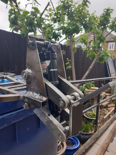

so i actually had a good bit of the project lying around, i have a good few ammo cans lying around, and what you know i had the fat 50 cal perfect for the battery box. it had some dents and a hole in the bottom. hammer, anvil, welder made it watertight again.
chassis is made from 5/8" steel tube (same stuff as my trucks) and picked up some second hand snowboard binding for cheap
at this point Jens posted his build thread and i got a bit deflated for continuing this build. but then i found my love for mud and made the first part of the ‘A’ frames.(3mm steel)
also you’ll notice the first version of the links, these are made from 15mm thick steel and are hefty af.
picked some second hand rockshox for cheap, one needs rebuilding, other one works great
finally ‘finished’ the links, please don’t look at them welds (i haven’t welded in a couple months)
i currently have some bushes and some shaft collars on order to finish up the ‘A’ frames and link system, then onto trucks and rockshox mounting :crazy_face:

Semi fixed the rockshox, got a rebuild kit for them and got the links and shocks mounted and working :grin::grin::grin:

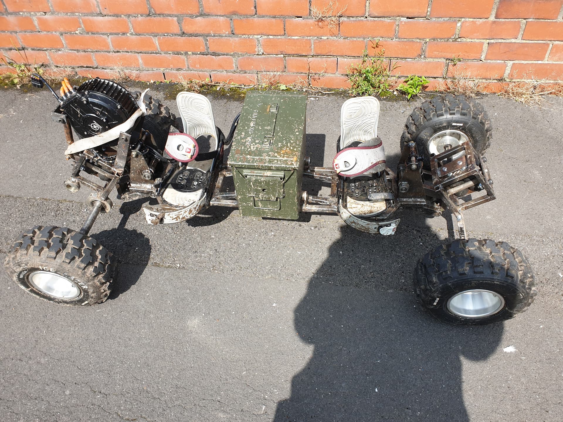

She’s big, she’s thicc and heavy as fuck
motor upgrade to a qs165 v2
iso 08b changed to iso 10b
3 stage ratio changed to single stage
battery box mounted
had to strap it to the roof to save space
Holy hell this is the best mtb i have riden, if anyone wants one contact @NoWind .
Got a couple small issues which shoul be an easy fix.
