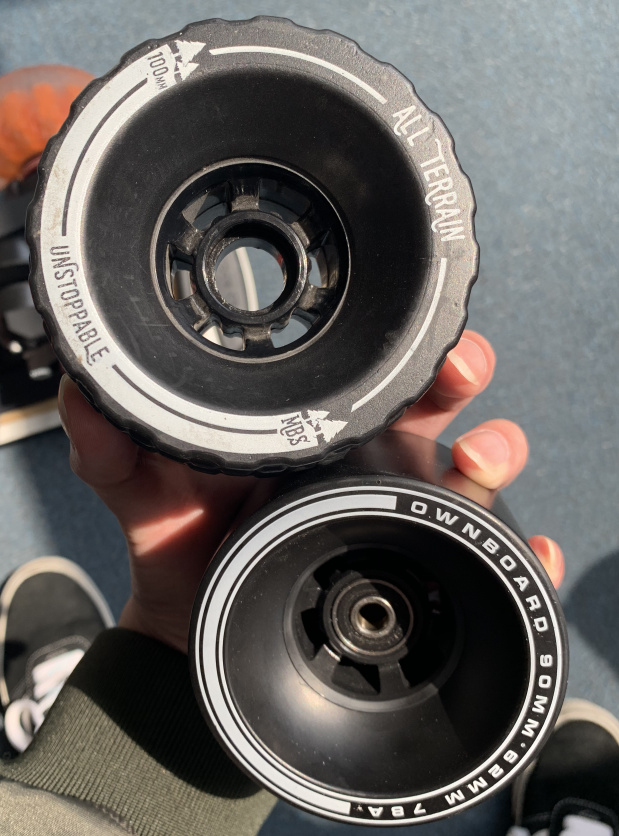

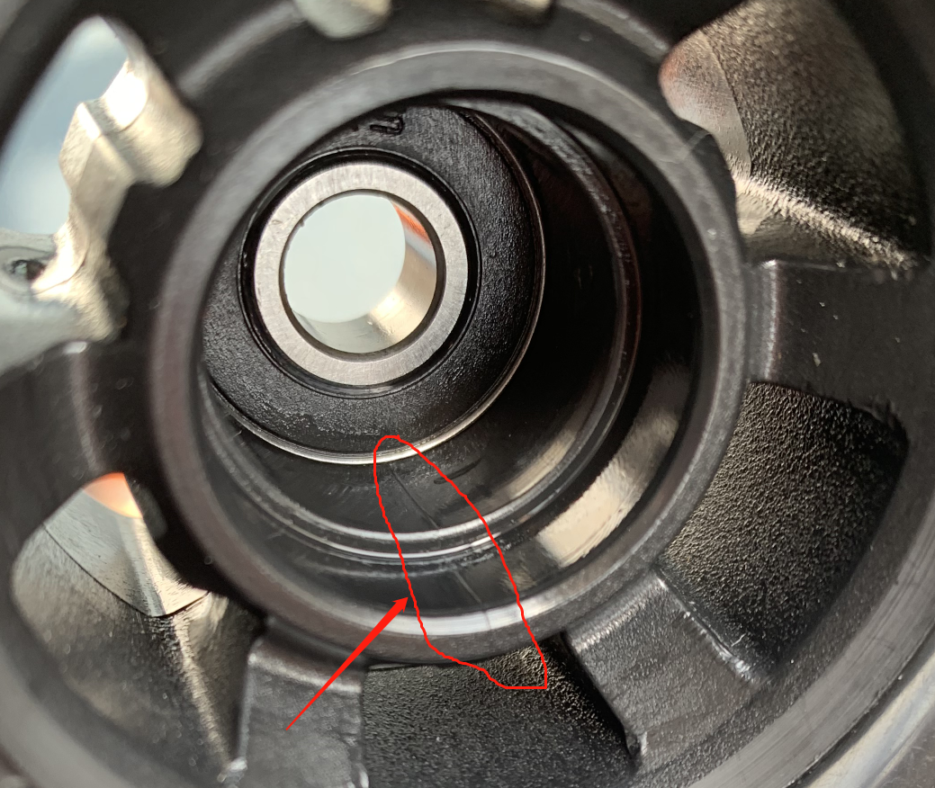

Kato owned mold factory on our street,and he had experience of building molds of plastic products,also he is also an eboard owner (I am riding eboard because of his recommending).So during these days we had did some research about the ā€œcrackā€.We had checked some wheels we both have for now,and you can see the pictures,both Ownboard wheel and MBS 100mm wheel,the same ABEC core and while take off the bearing ,there is a ā€œcrackā€ ,similar to the most of posts on Cloudwheel club to complain,but take a good look at them, a continuous straight line across the whole wheel core,did not looks like a crack happen while changing or riding.
So we are considering while the crack happen on changing or riding,firstly it will be irregular,can not be a straight line.And it will be reach to some area of core,can not be cross the whole of it.Kato said considering from the mold,it is weld line for this kind of products. The production of this injection line is related to the temperature and flow rate when the mold is poured.So they are also reasons caused some products had that weld line,but some don’t.And it is very common for the plastic products.
Due to this point,I hope you guys can check again for your Cloudwheel.(Specially if you bought the second hand Cloudwheel,like Rafael did)I understand that the safety is an important point for all of us,but maybe we misunderstanding the weld line to be ā€œcrackā€. So I’m here to remind to all of you guys.In my experience,I use Cloudwheel with ABEC pulley (56 teeth),and riding for at least 500km,still going strong and no issues.
This is not crack! This is seam line from injection mould tool!

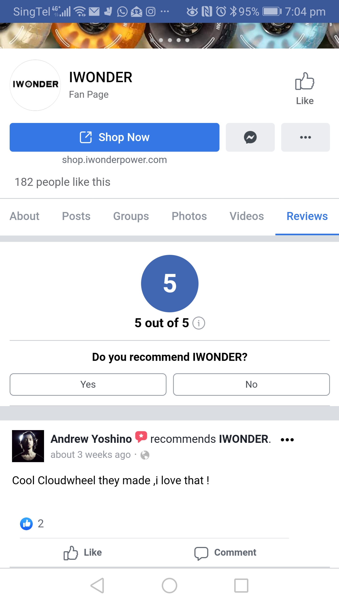

@AndrewYoshinoare are you affiliated with iwonder?
Of course not,i bought Cloudwheel for my board.I saw that issue and some points from @jeffwuneo ,much interested in that.So i want to clear it out.

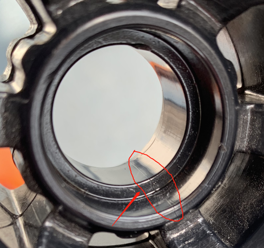

Here’s a better shot of mine.
I think red circle might be crack,but 2 blue circles i do not know which one is weld line,can’t see it clearly from picture.

@BillGordon yup your in crack city…
And weld line or cast interface, it still shouldn’t separate there.
