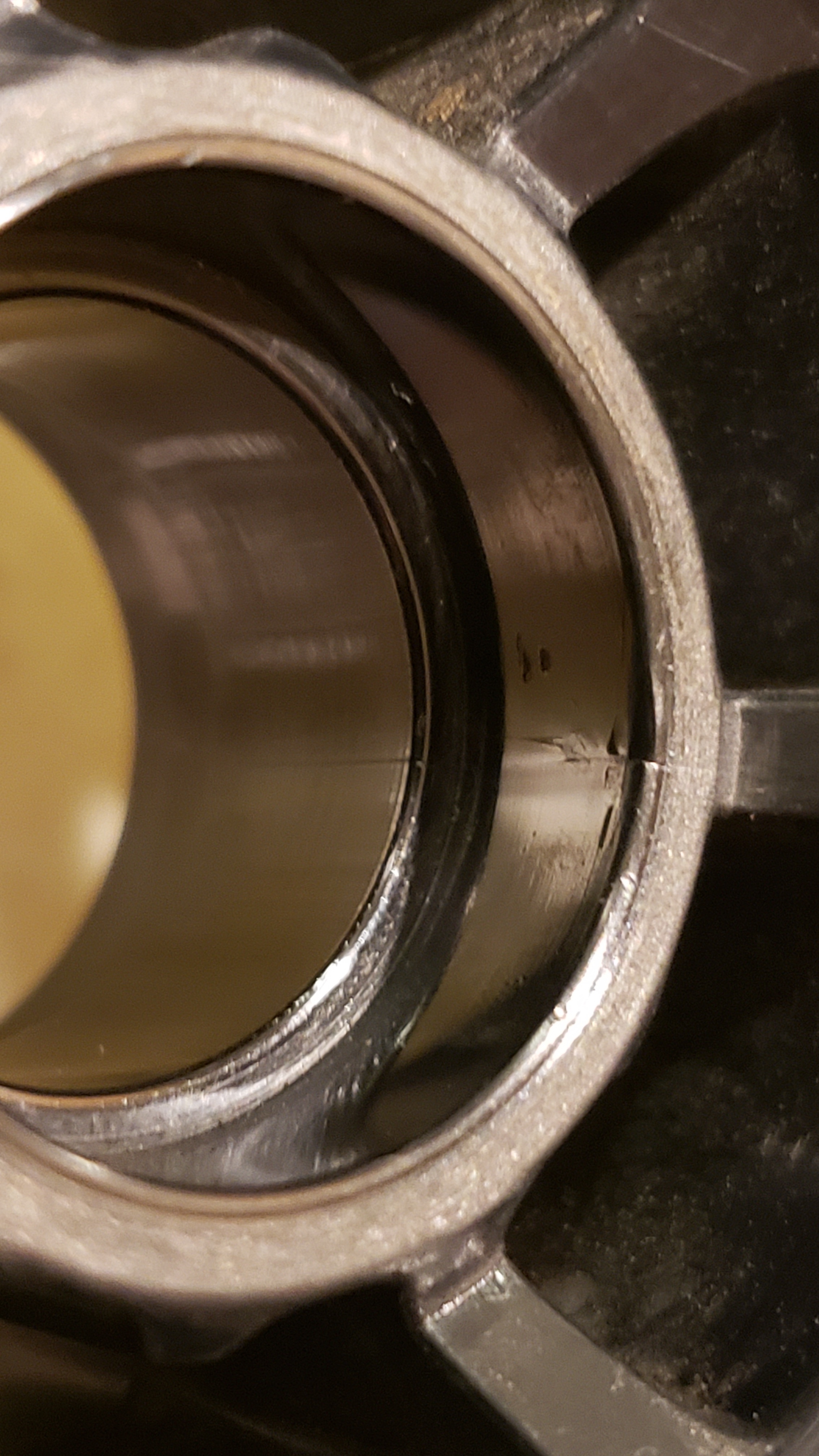

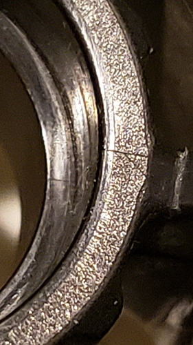

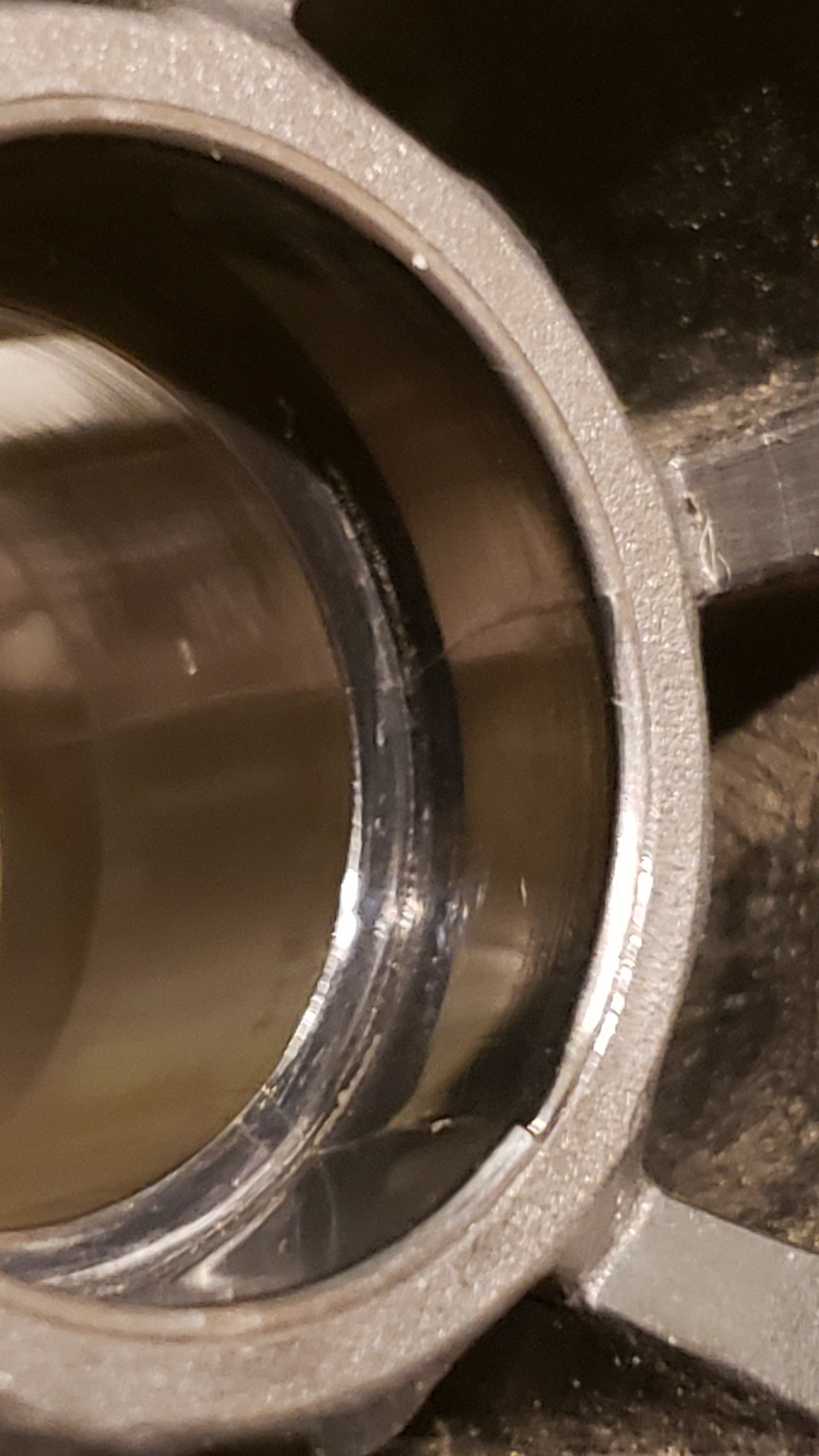

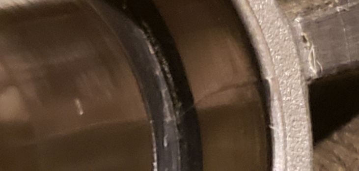

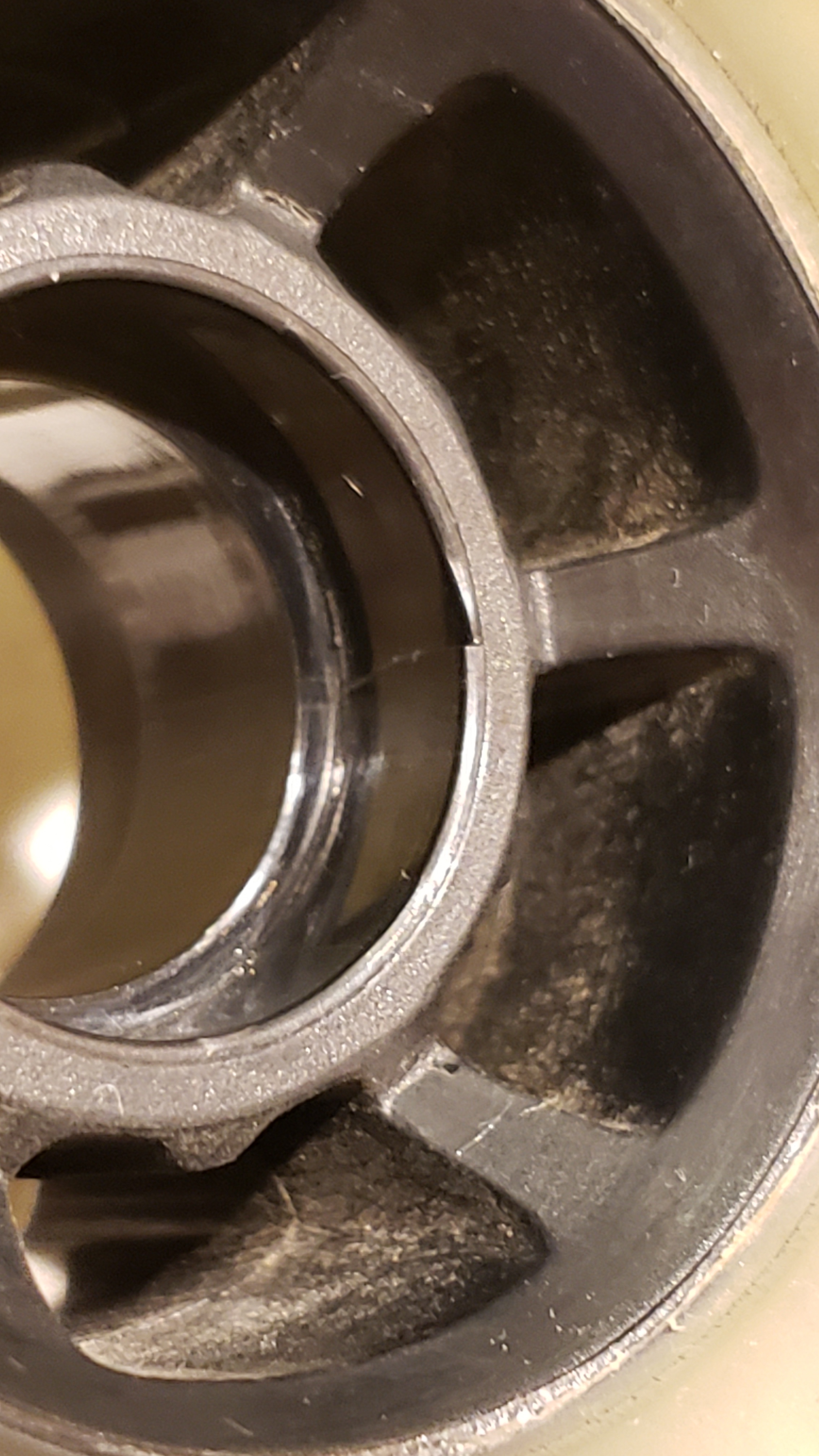

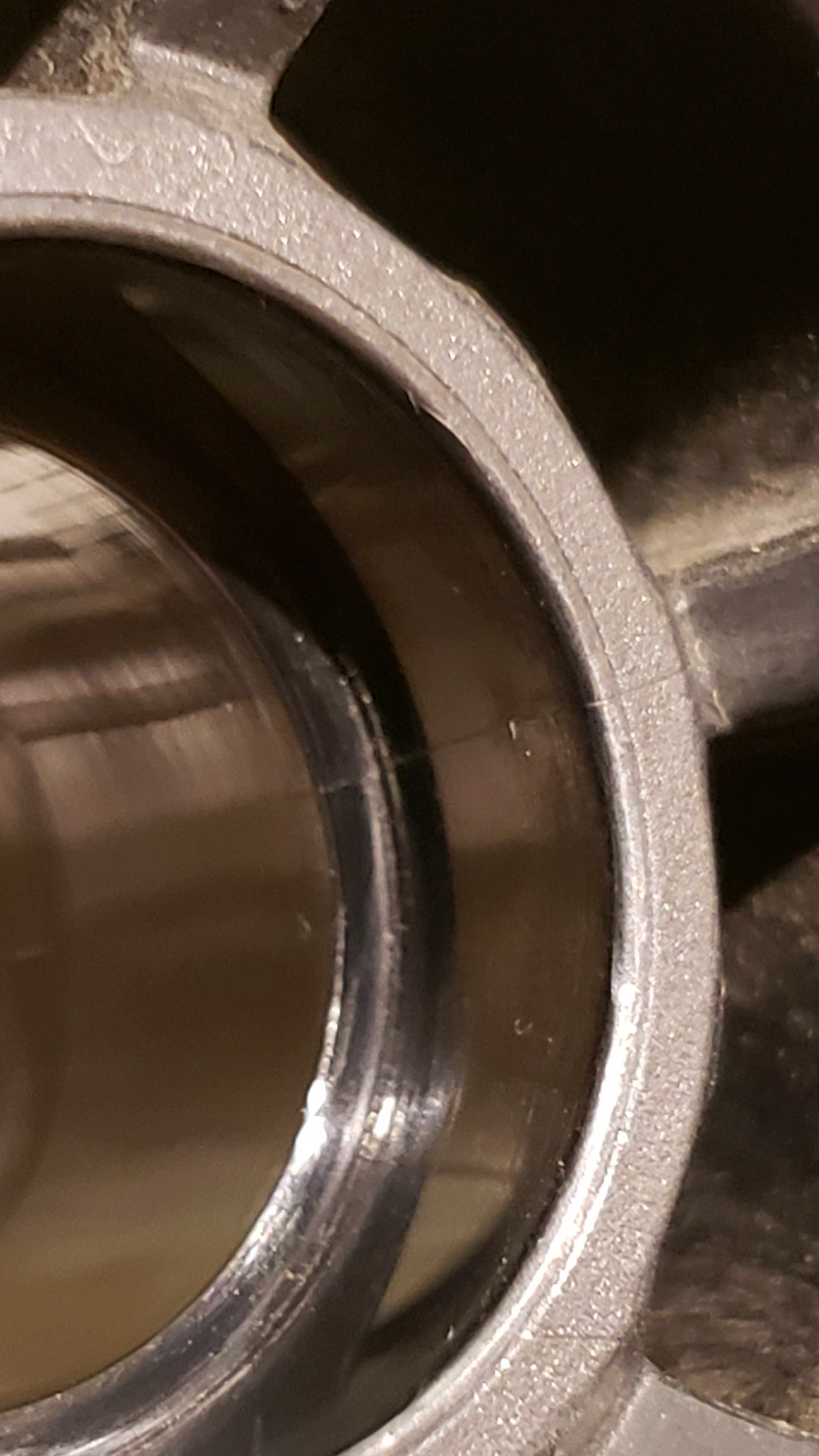

I wish I had a better way to get these images. But this is just zooming in ony cell phone.
And I do believe a couple of the other wheels have hair line cracks.
Some may be just parting lines.
I could not tell anything was just looking at them. Had to use my phone camera.
I am curious as to what I will do with the new ones I am getting Friday…
Nice pictures. It looks like the cracks might be fairly advanced on the interior before they become visible at the surface.
So that’s an added concern.

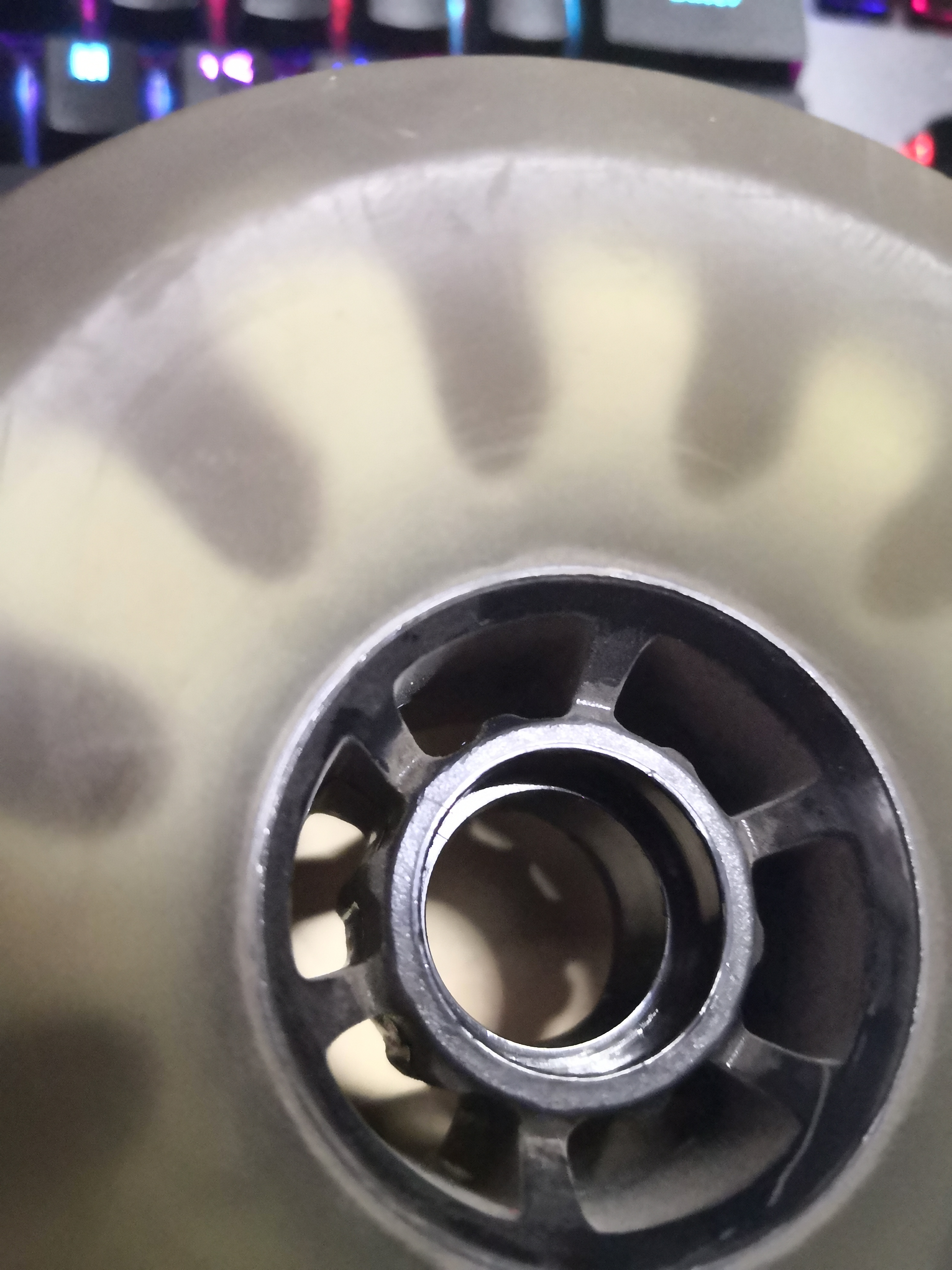

Did a more thorough inspection. Found one at 10:00 in this wheel. And, of course, it’s the one with the goofy shifted foam.

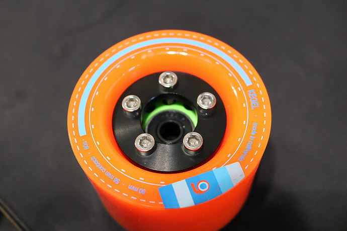

I’m so done with abec cores like a month back. @stayfocus18 you need the proper amount of spokes for kegel core, doubt that will work too well.
they sell a similar pulley on their site
Yes, but that config is suited for the smaller wheels. The amount of torque to turn TB110s is a lot more - unless you wish to get TB90s
will look at something else then… never used kegel wheels

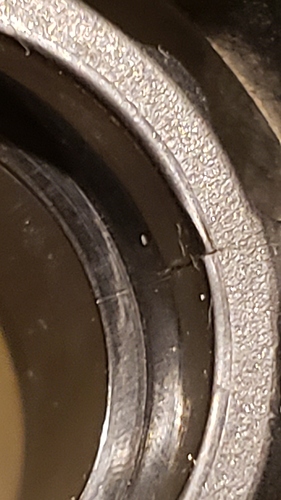

Bill, the last thing I wanted to see at this time of the day was a picture of your crack
Yeah that is not a crack from material, that is a bad mold injection or a mold artifact. Some of those may not even be cracked but could develop into a crack because the bad injection left a stress riser there. They need to go back and carefully look at their tooling.
Wooosh. The plot thickens. Crack porn in here… as an inspector, i love this stuff. Lol
