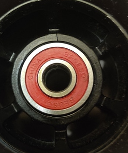

I assume you are referring to this picture from @AlanZhou (zero kilometers)
This picture seem to confirm that unreinforced plastics lack the strength, resilience and other properties needed to hold a metal part in place.

Regardless of how it cracked so early, the fact that it happened seems to confirm that the the unreinforced Polycarbonate/ABS blend is extremely inadequate.
I’m not sure why you say it is not a material strength issue. Maybey you are trying to say that there are probems with the manufacturing process like the temperature of the plastic, the cool down process, etc. OK, that may be true also. I suppose if you have poor manufacturing processes that the failure rate will be high regardless of the material choices. Is that what you are trying to say?
Ive had many sets of abec clones and genuine abec’s and this is the only set to crack like shown in my picture.
I believe abec cores are adquate for the wheel size and I don’t think kegal core is necessary.

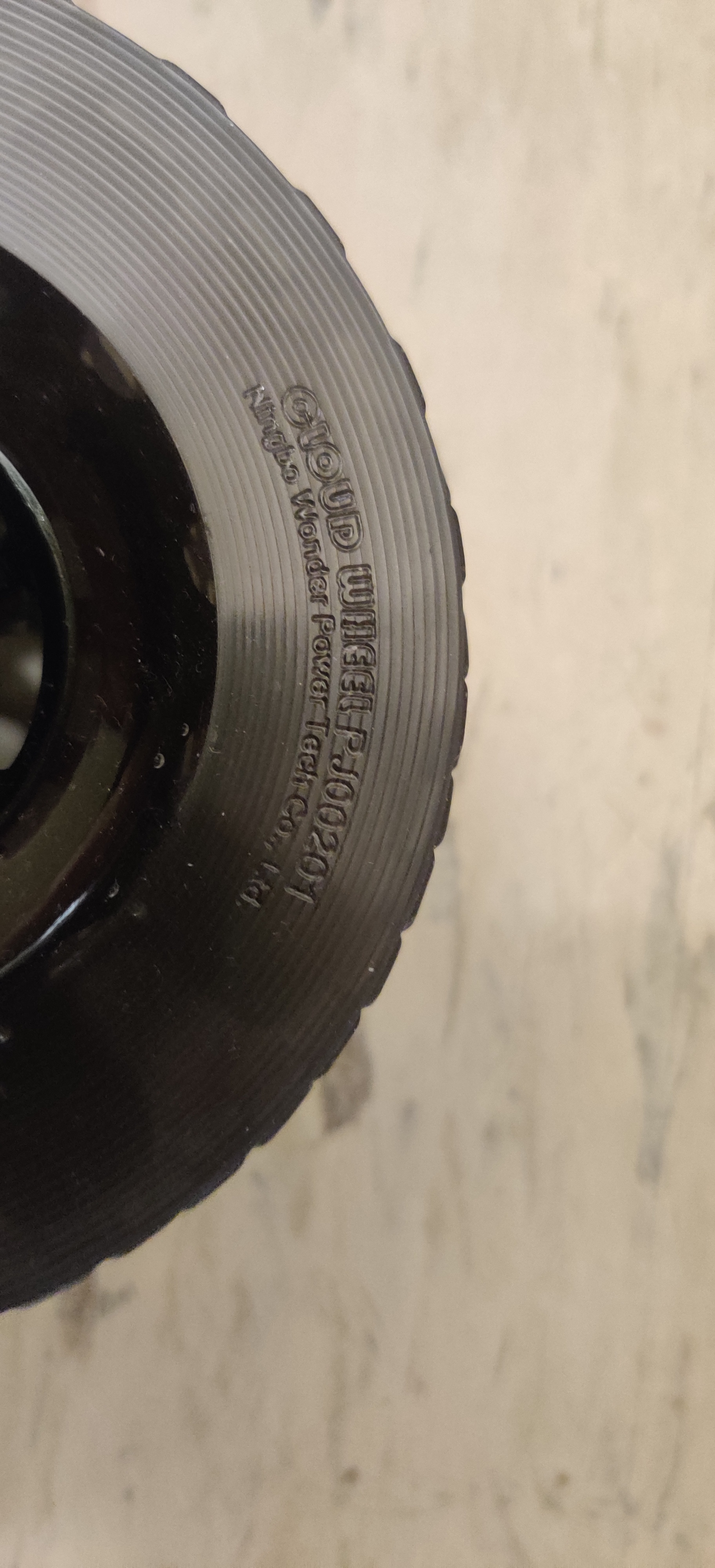

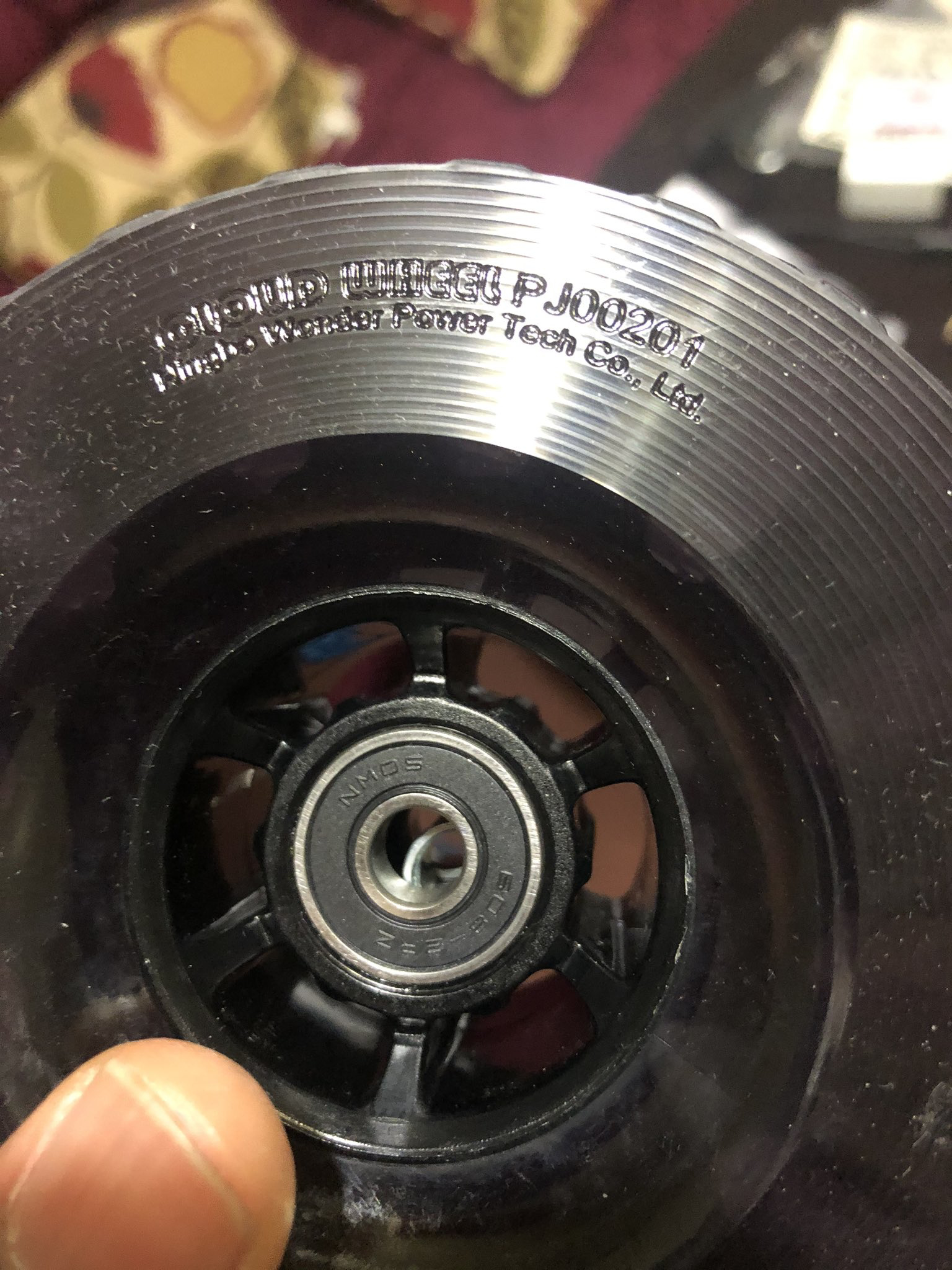

you mind showing the serial on the wheels?
I’m guessing this is the serial?

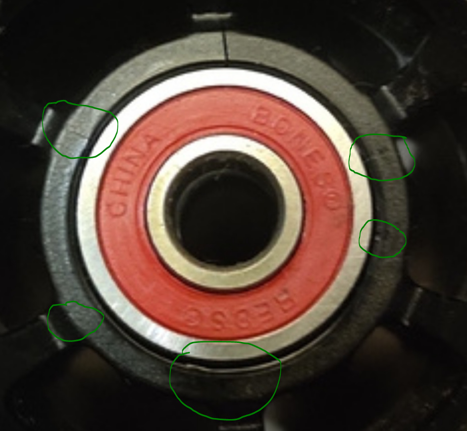

I thought it was material at the very beginning, from the picture of total failure. Then all the hairline cracks start showing up, and that is when I realized the common pattern, the cracks only start right in line with a spoke. This points now to not material strength (you would think that the spoke area has more strength). IF it was the bearing expanding the material and cracking it, it would happen in an area where the shell is not being reinforced by spokes behind it. What this points to is the spokes are actually pulling on the inner shell, creating additional stress at those points. This shows the core was not molded properly. Perhaps if done right, the material itself would have no problem.
I thought so but apparently not…
They would have a batch # rather than a serial, that looks like a batch #, same batch as @AlanZhou

Got paranoid, and started to look for hairline cracks… I have two wheels that I haven’t even touched yet, so still with the factory-fitted bearings, and I can see a hairline crack in the bearing seating on both of those wheels. I wish I had a microscope to look at it better or to capture that on photo… But yeah, that’s not super reassuring.
Batch # PJ00205
your paranoia triggered mine… I checked the other wheels under a light and i can see the hairline cracks in 1 of the other wheel… these are going back… smfh not worth the risk.

By the way there is an other number stamped out in the core (where the bearing spacer sits). Remove bearings and turn the wheel until you see it. Mine says Yz01-03

I agree with you that the manufacturing outcome is extremely poor. The wheel pictures from @AlanZhou had cracks on both sides. The front side in particular seemed to have multiple imperfections.
My best guess is that this particular unit shrank a lot. When the bearings were pushed into place, the plastic cracked because the plastic is not resilient enough to streach and there is no fiber reinforcement to prevent or slow down the propegation of cracks.
The reason the plastic shrank so much could be either the quality of plastic or the temperatures used during the injection molding. One theory might be that they overheated the plastic before it was injected or the mold was not hot enough so the plastic cooled too quickly as it was injected. Another theory could be that the plastic is poor quality or that the PC/ABS mixture was inconsistent.
