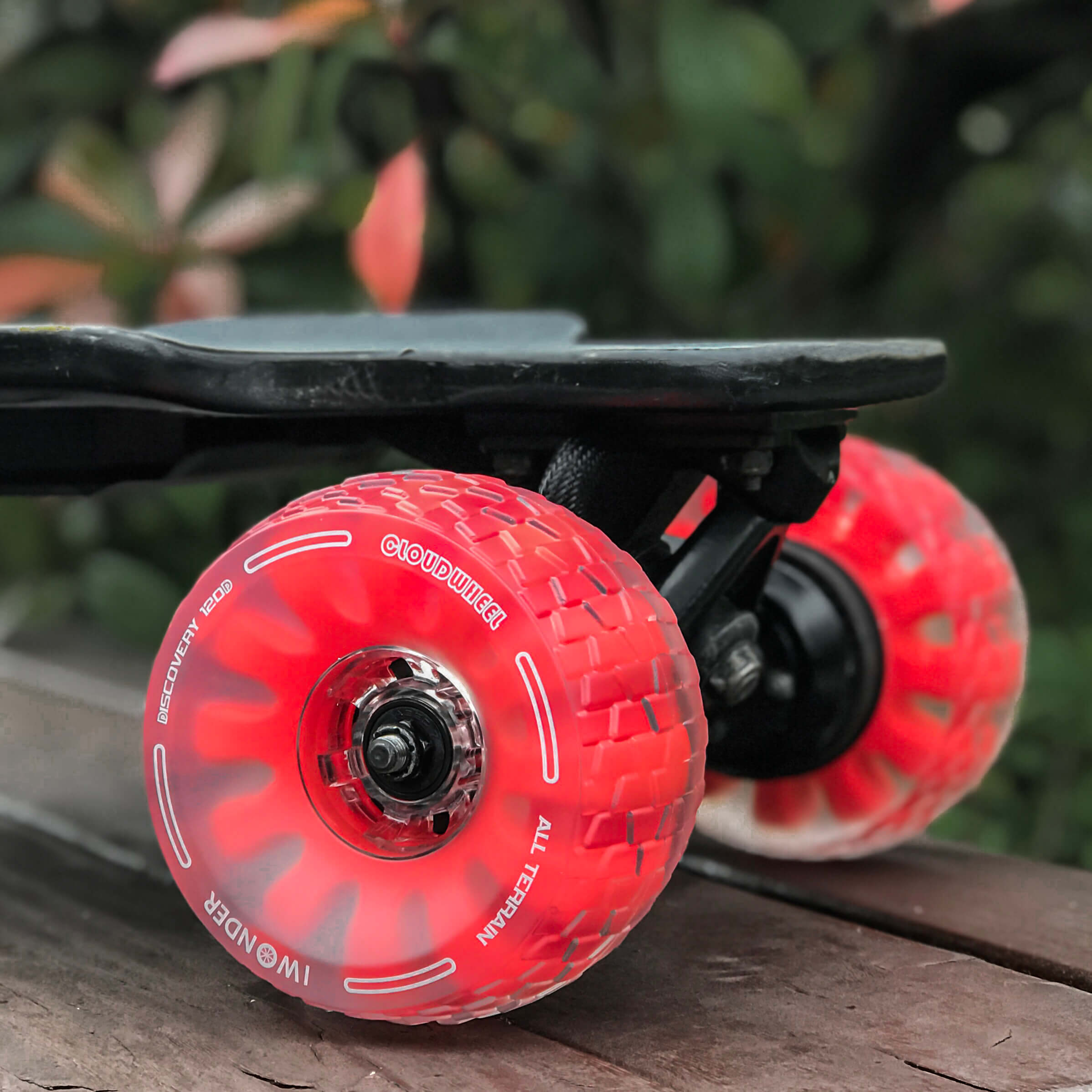

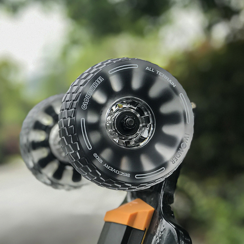

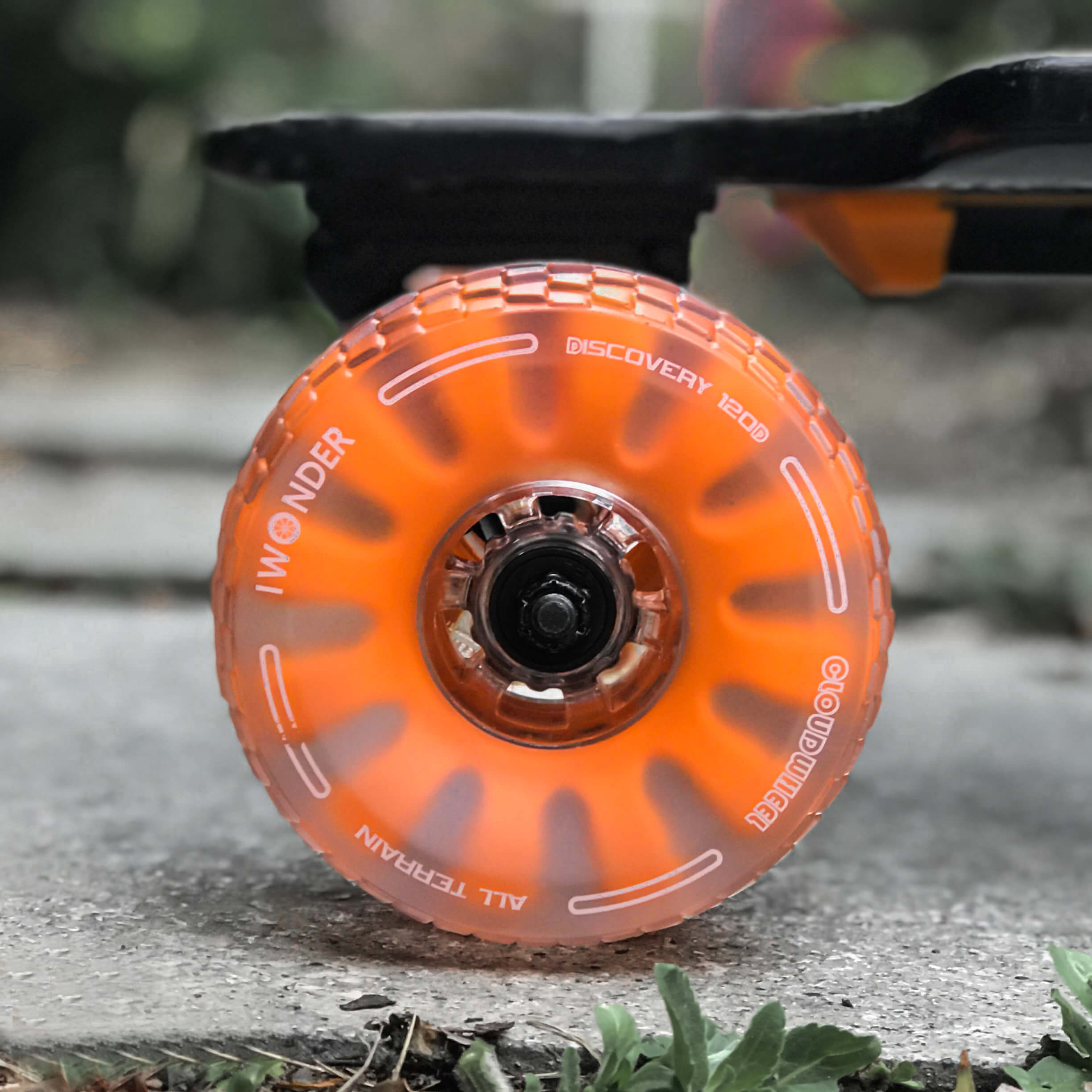

The wheel in your photo is not our latest discovery version,we are new wheels is transparent hub.
The thick black spokes are the earliest products customized by the customers, not our latest launch, nor the version between the thin spokes and the discovery version

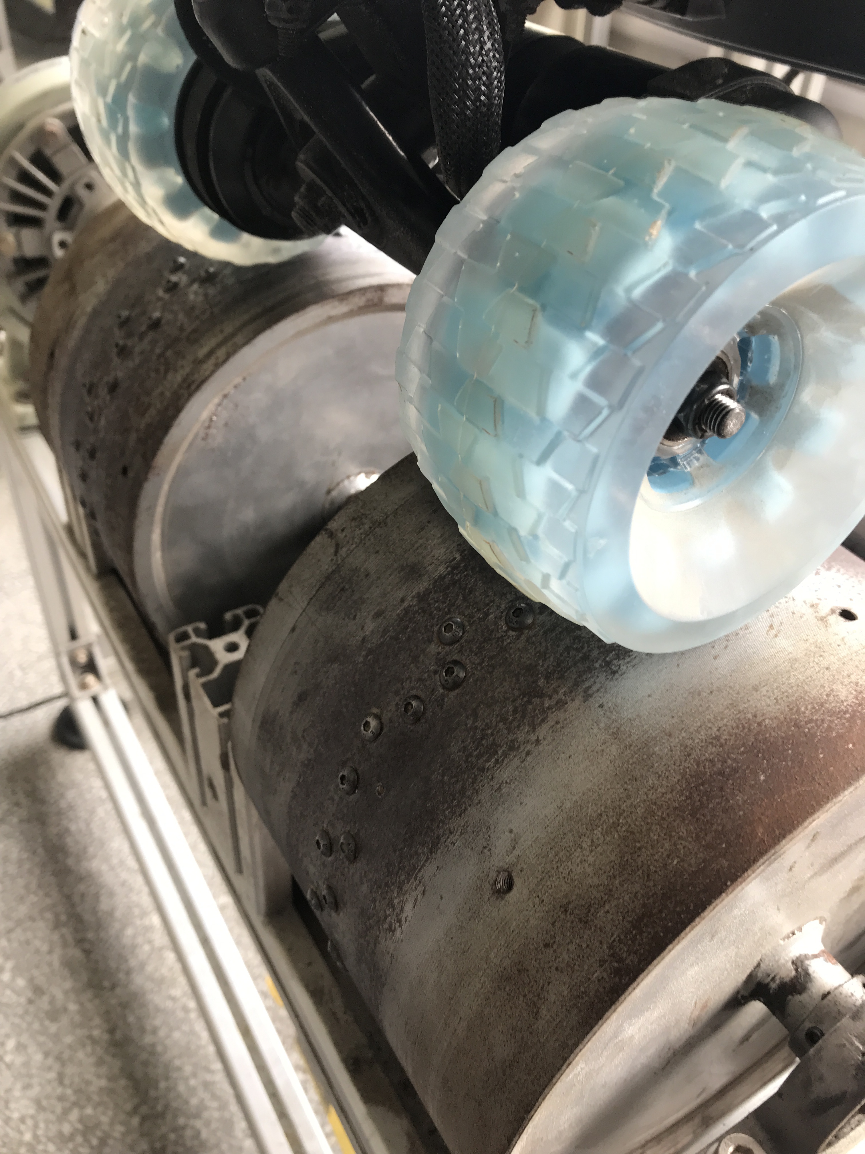

@Hide Very nice. Would you show us your wheel machine for testing. How fast have you run them. How much weight and how many miles. Did you find a failure threshold with your wheel and where is it?

Discovery version wheel, we installed on the electric skateboard to drive first, load 80kg, the simulated test mileage is 1000km, the speed is 40km/h.

You put 176 pds on your wheel. Ran it 621miles at 25mph. That is twice the load a wheel will ever see.
That is Impressive and cool setup.
OK edit 44lbs as load was in center of board and over two wheels. Skate is usually loaded 70/30. Also like the simulated rough terrain aggregate on the wheel. I like this Wing fella and his teams’ practical approach to testing.
@Hide thank you for sharing these things. Clear documentation of testing is the kind of stuff this community thrives on. We all appreciate the transparency in this ongoing situation.

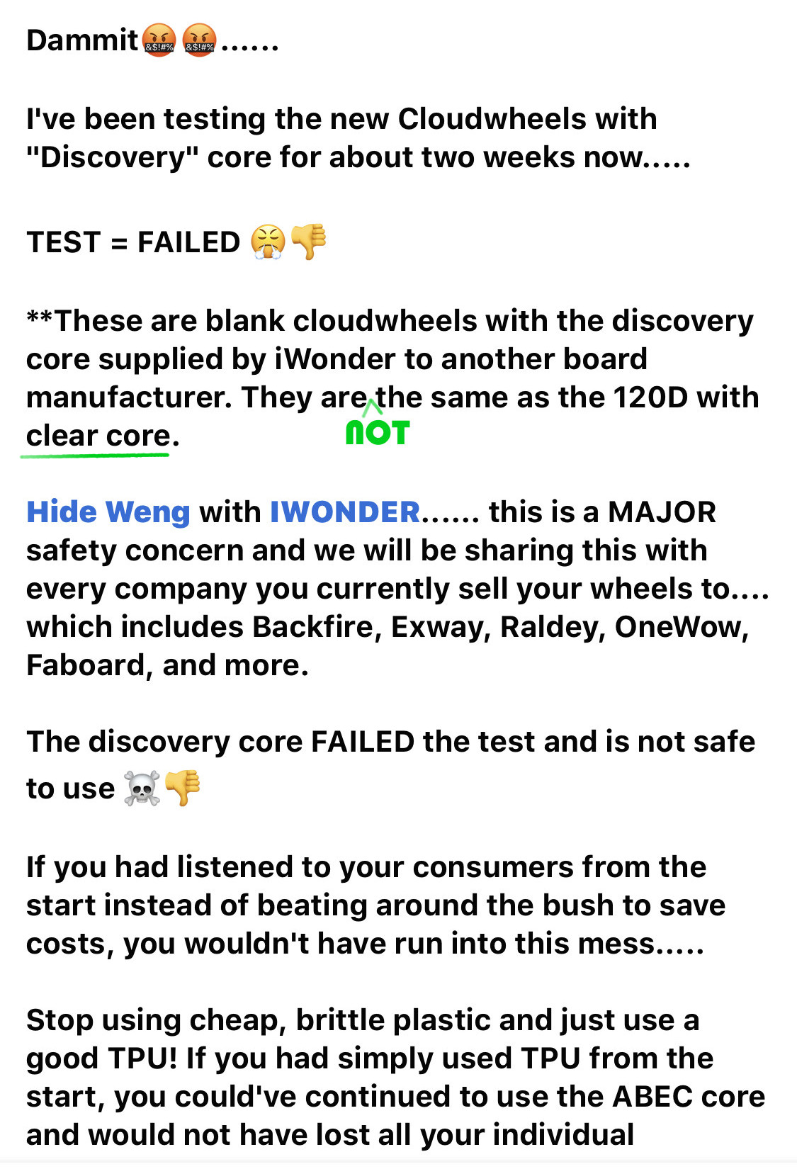

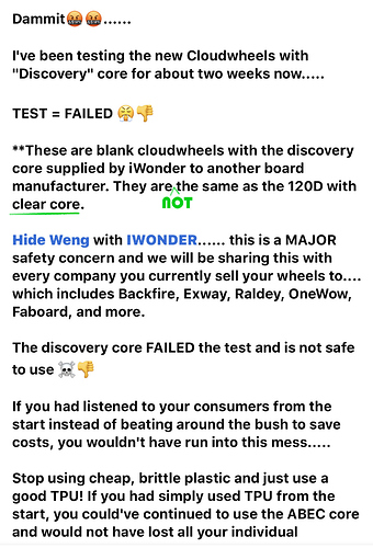

I hate to call em out but it was more like a deflection than an answer… All this hammering and testing doesn’t mean anything when they crack before you even open the box… There’s a fundamental problem and they either know what it is and won’t say, or they’re just that clueless…
The 2 questions that he does not answer is 1. Is there any serial number or trace that can link these cores to a particular batch or mold, and 2. Is there any mold that they are aware of that is having performance or function issues…
