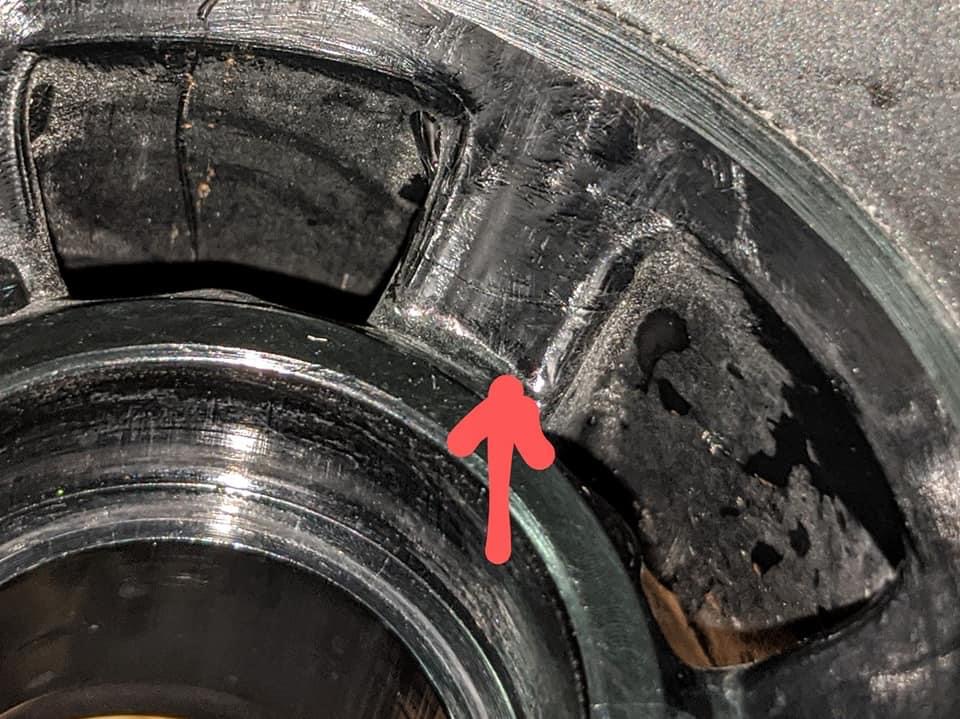

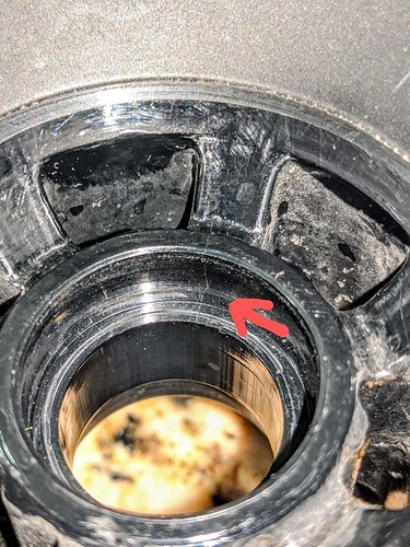

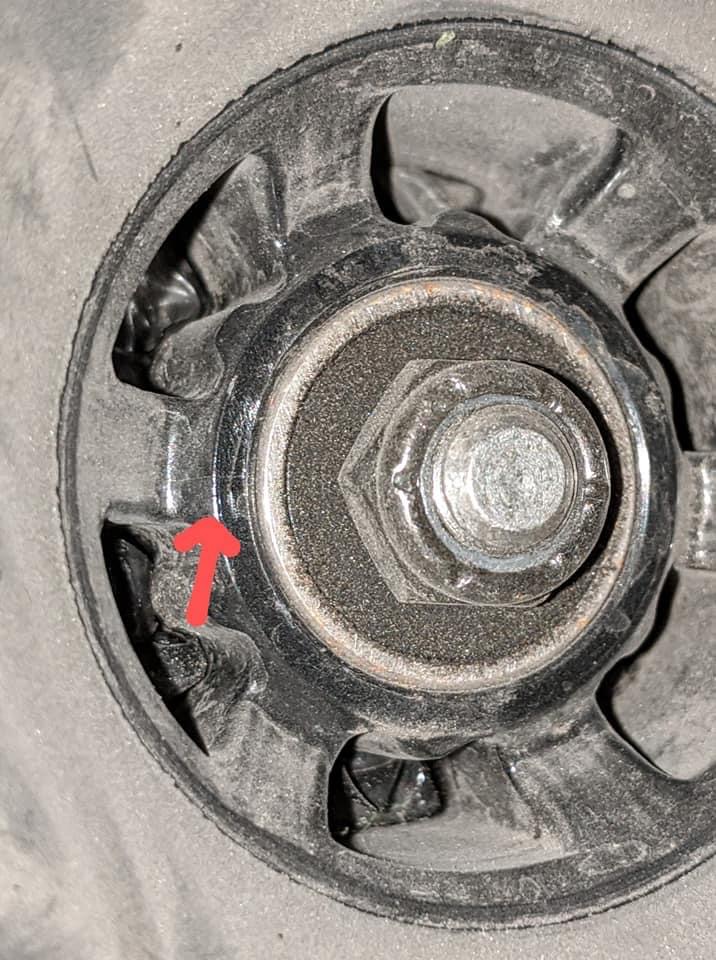

Problem with Slick Revolution/iWonder Cloud Wheels (SERIOUS)
who are people gonna sue? just curious have there been any united states based businesses selling these wheels?
poor dex has to go through extra testing and forego selling some sketchy products because he doesn’t want to live in his car with his kids, while laywers sell his house to pay their bills
I sent Iwonder an email to let them know my replacement wheels failed. They did not comment back. I just followed up for comments via email.

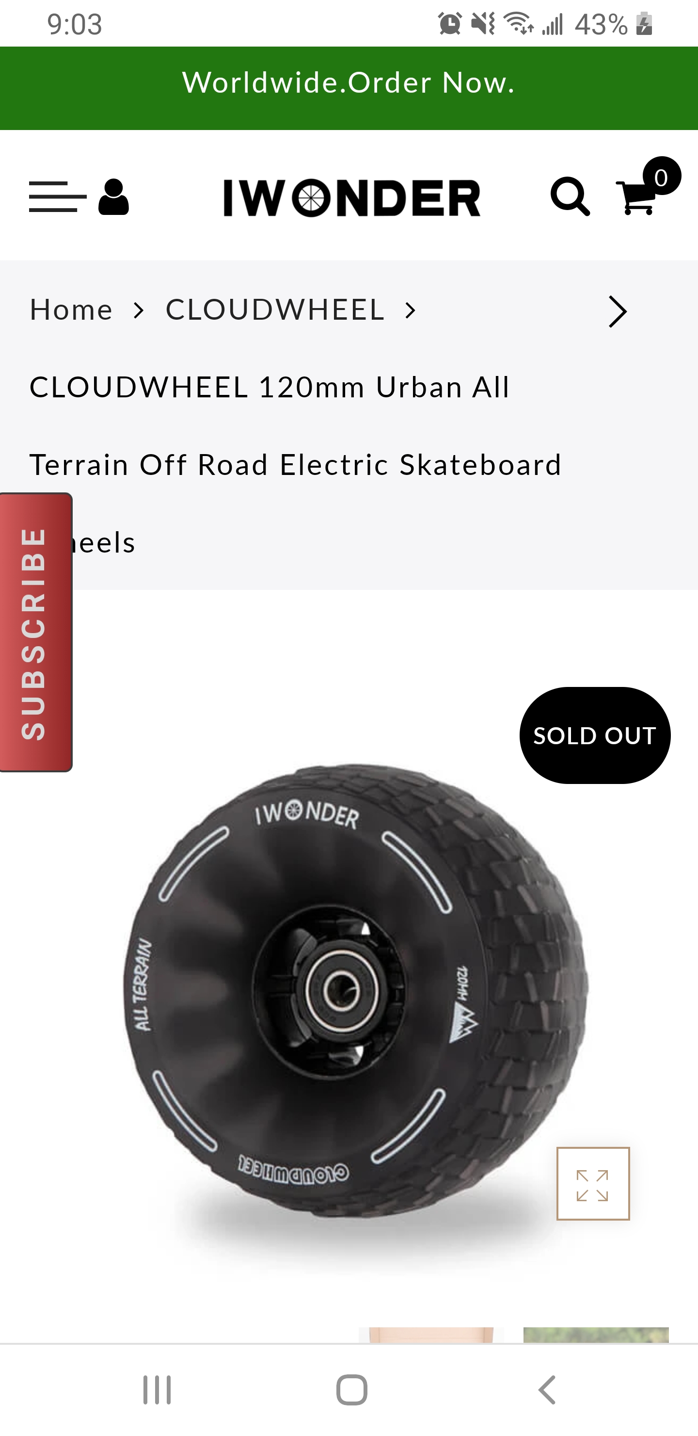

The old style says sold out in their website.
I believe it was still showing available the other day.

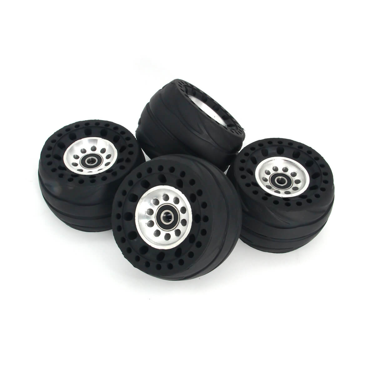

If I’m not out of order, I believe the Skullboard wheels
were the “bacon strips” am I not correct @BillGordon?
the ones posted above…
I have not used, but look similar to the ones I purchased with my eLofty… the Lofty ones are much better and quite acceptable… I like 'em… the skullboard wheels are simply awful!
Actually, I believe these are “bacon strips” because of the weird tread:

Yes, the two black options were in stock/available for purchase just a few days ago. If this is them pulling them from the market because of the concerns raised, it’s a good faith gesture for sure.

Good faith by going out of stock. But still in denial. New discovery wheel or not, im def not gonna be getting a new set with the way they(iwonder) have handled all of this

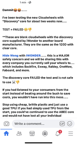

aren’t the discovery cores transparent or am I missing something?
*or are the pictures not from the written post?

Those were an in-between fix. Black plastic. Thicker core.
Newer discovery is clear plastic. Thicker core.
I’m looking to @Hide for more comments on the composition and make of the clear plastic.
