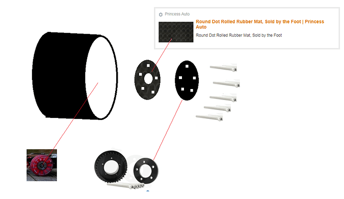

You have me curious, but I can’t quite picture what you’re referring to. Care to make a picture/diagram?

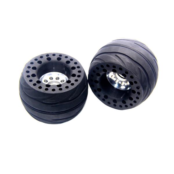

Mind i ask where would we get such holey wheels from?

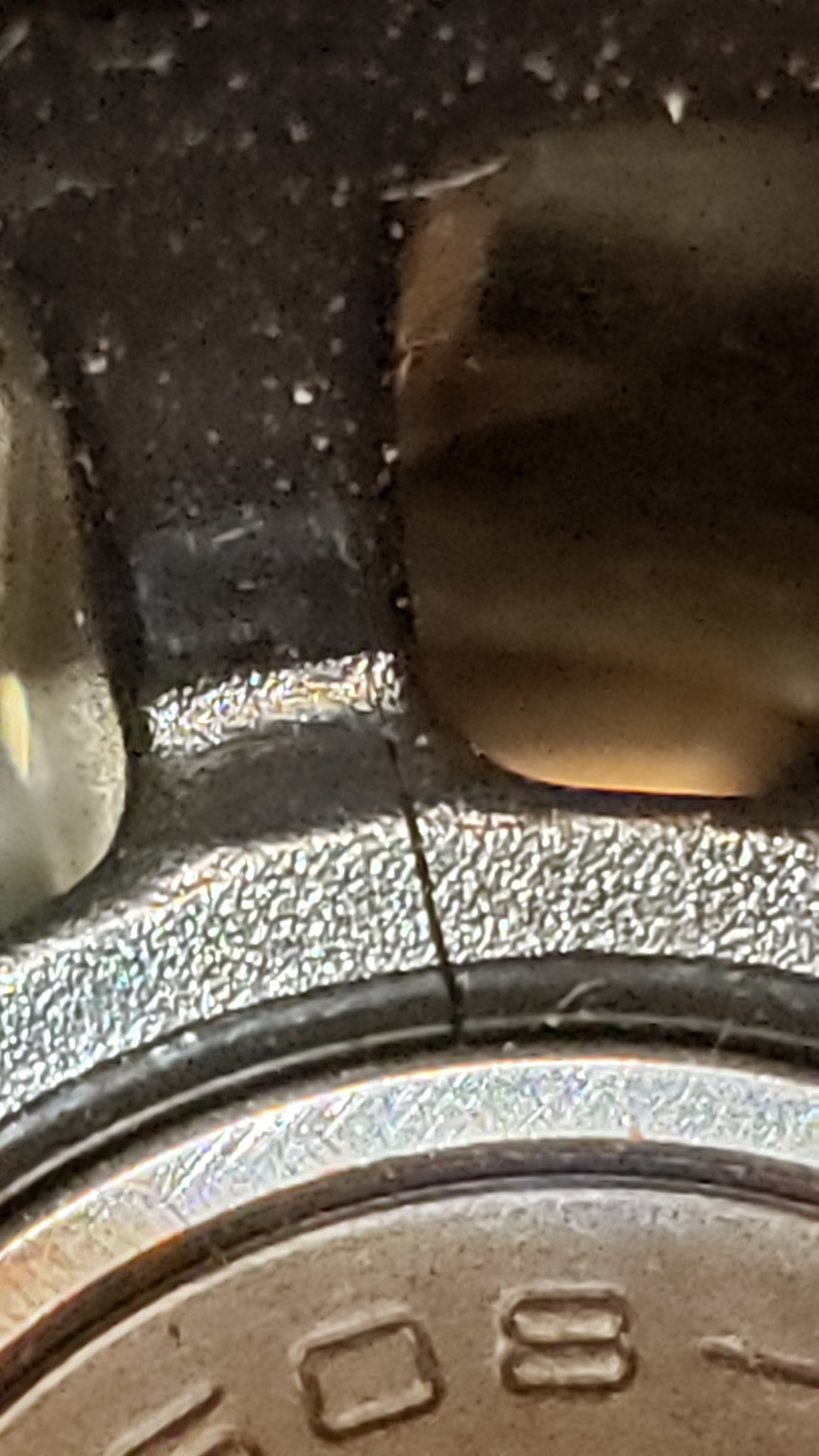

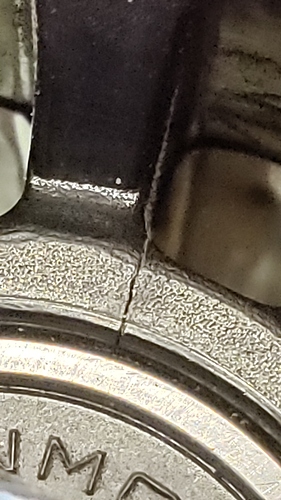

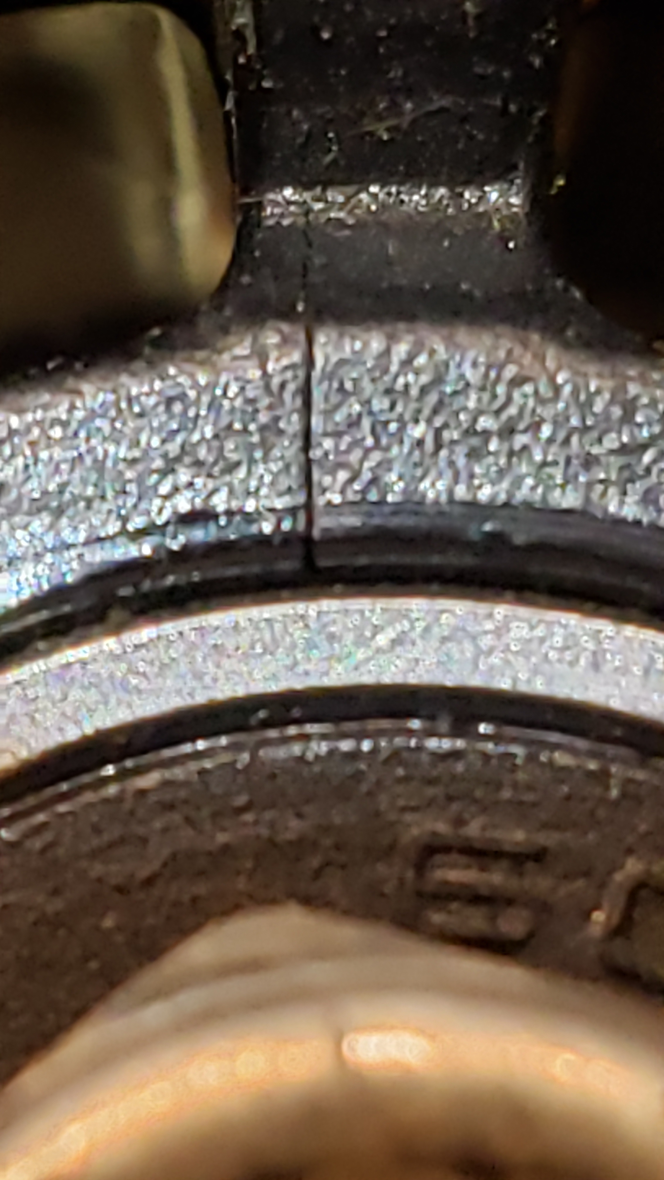

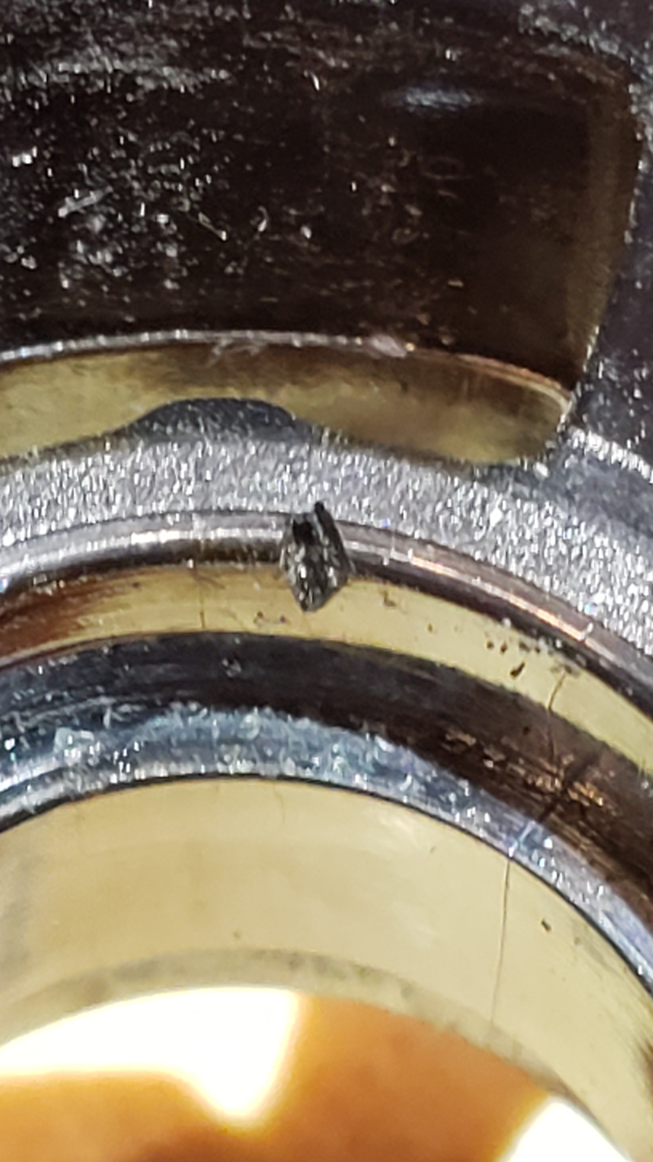

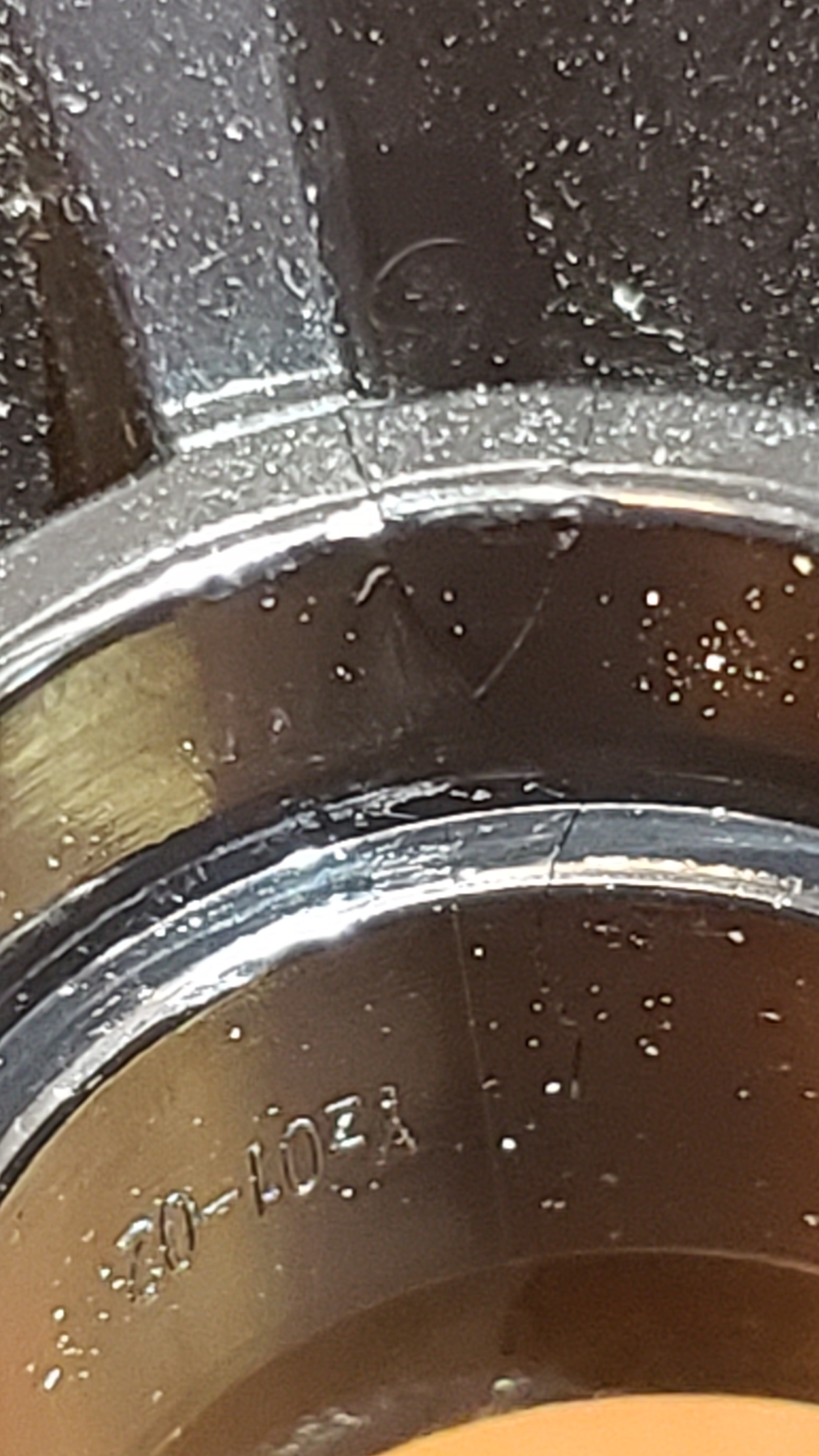

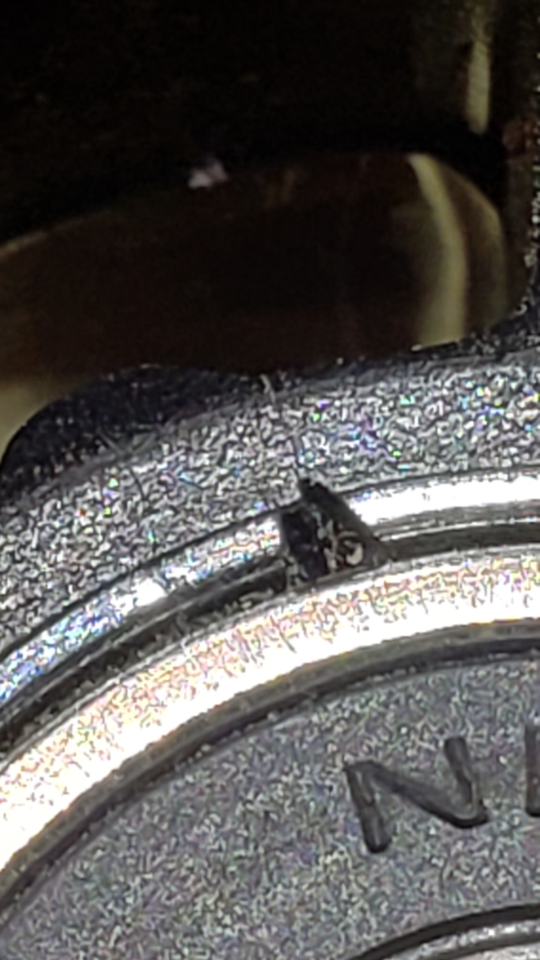

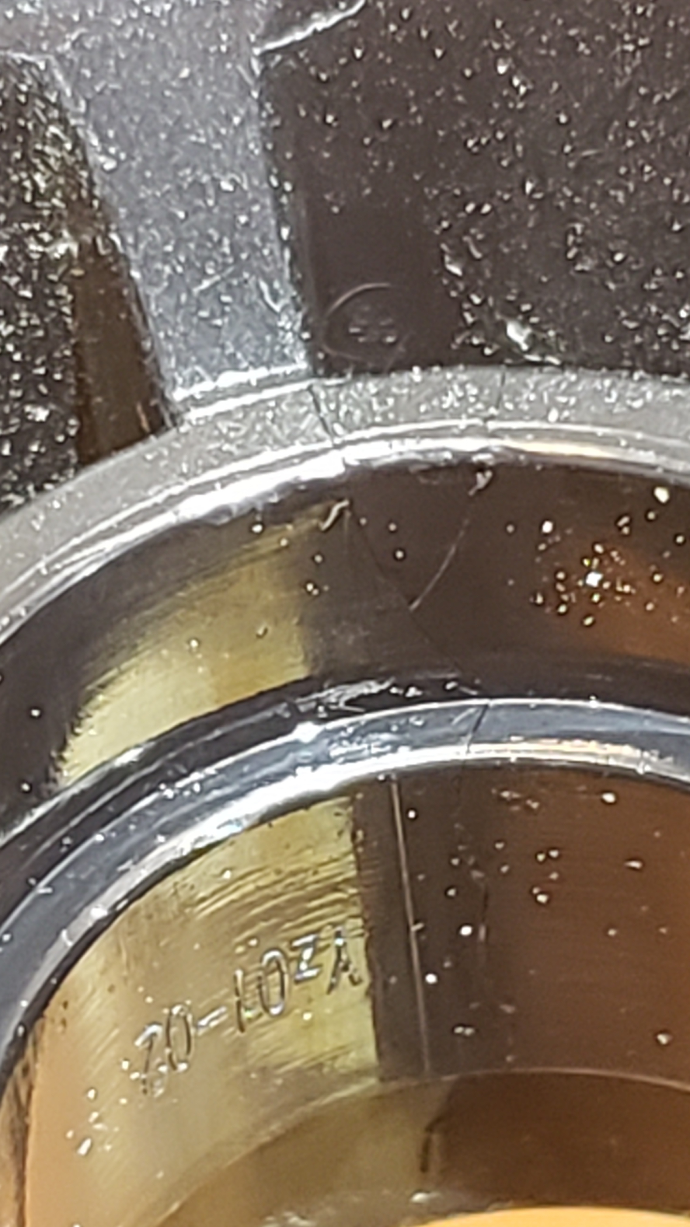

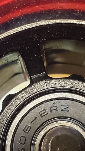

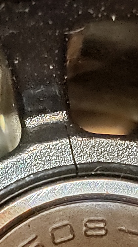

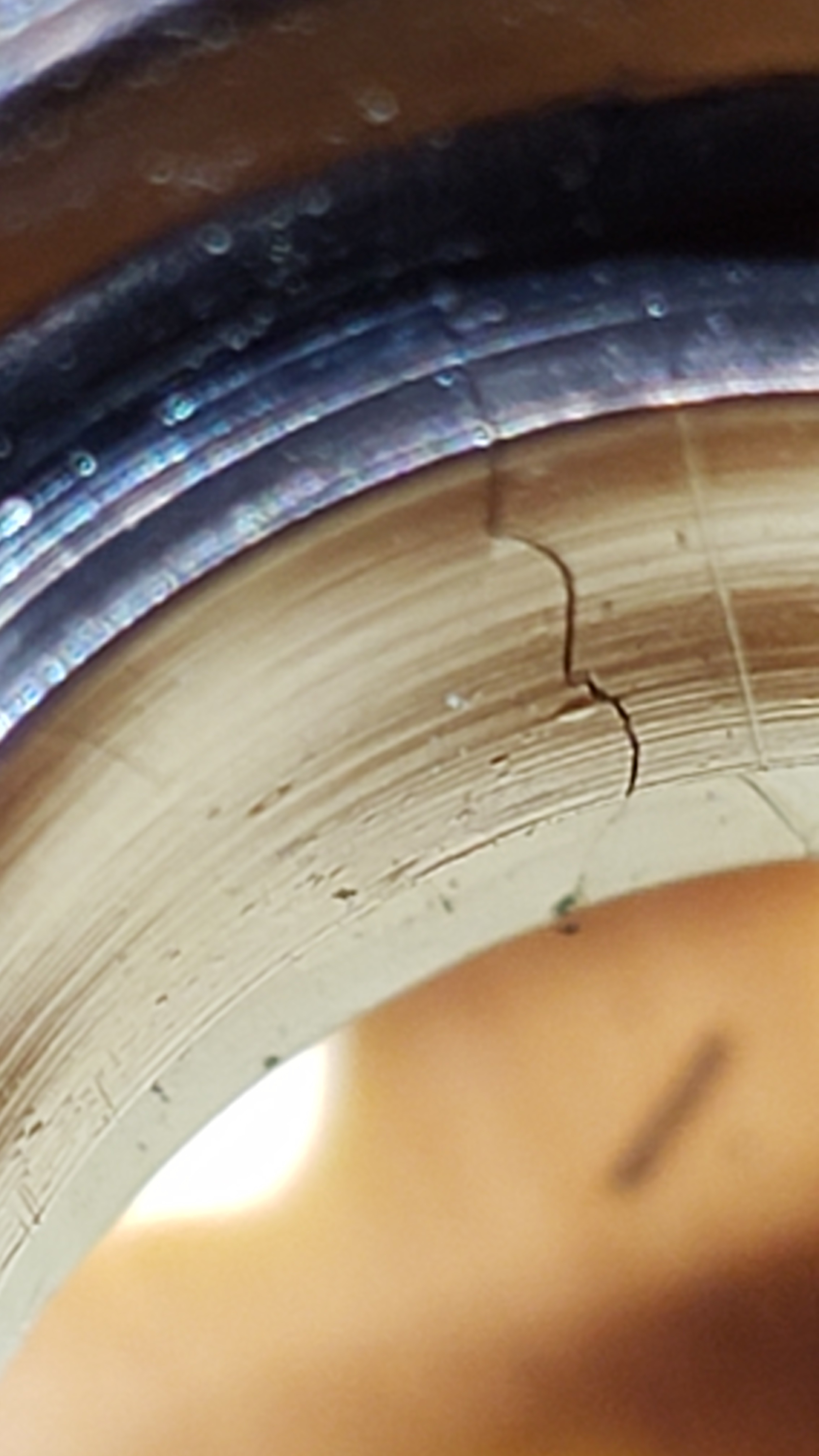

3 rides.
33 miles(53 kilometers)
Front wheels. No pulleys.
Stock bearings and spacers.
These are the replacement wheels Iwonder sent me.

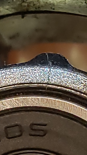

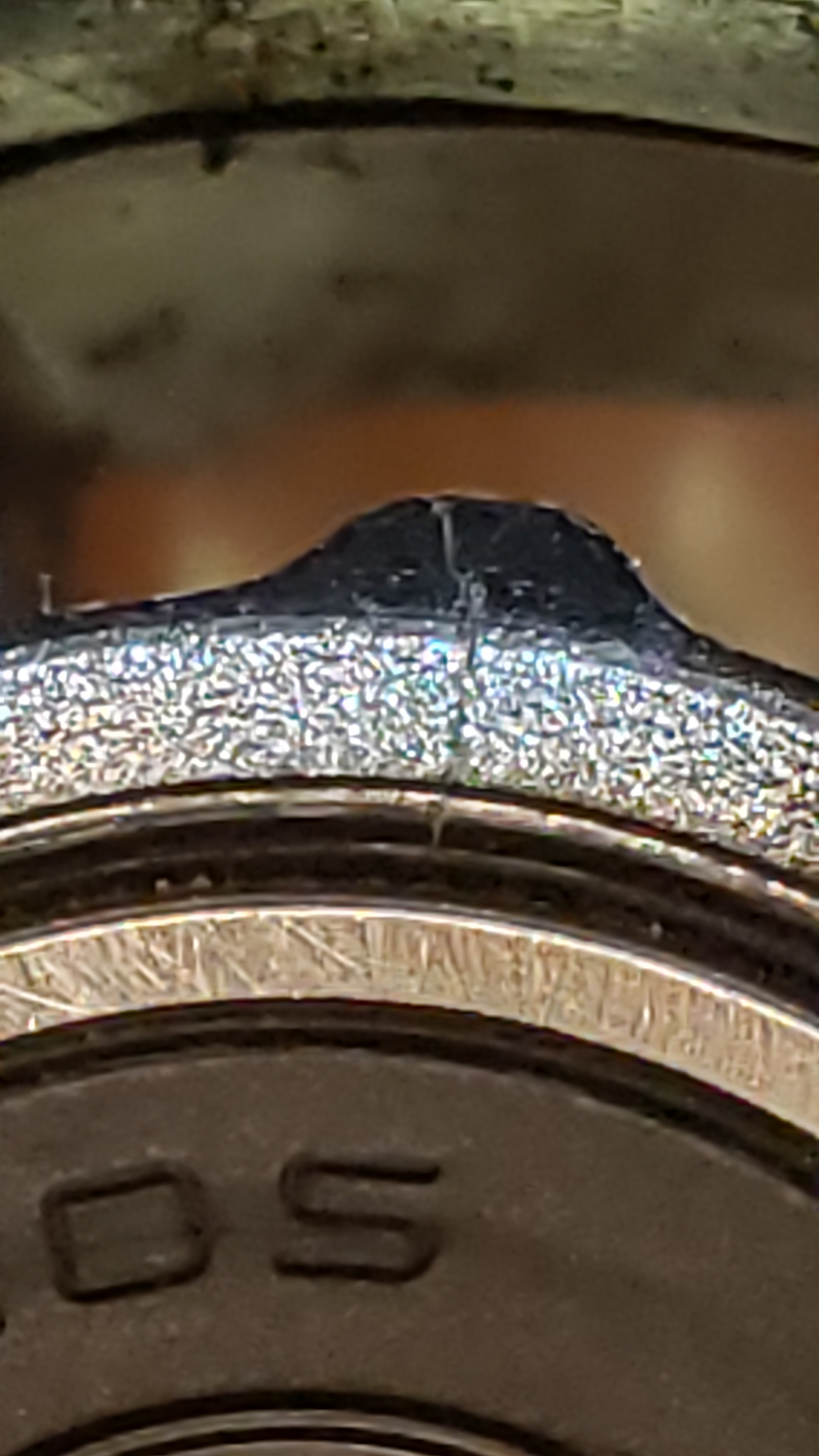

Notable cracks on both front wheels.
One of the back pulleys wheels had a crack and a chip.
One of the back wheels had no noticeable issues.
I’m slightly more nervous every time I ride them :man_supervillain:
Shit, dude. That’s rough. I take it you’re getting off them completely. I really hope this Discovery core is the answer.
Yeah. These are going in the garbage where they belong.
These dont look too bad! Fairly priced too! - @rafaelinmissouri ? I might try them out…
It would be interesting if you had the lathing capabilities to cut out the crappy core and put in a CNC aluminum or plastic one.
I was thinking for an application where you want a solid axle if could be made into that as well.
