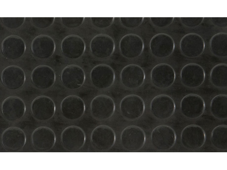

I’m talking about this stuff. Easy to cut with good scissors.
Google round dot rubber flooring and you will get some links that are local to your own area.

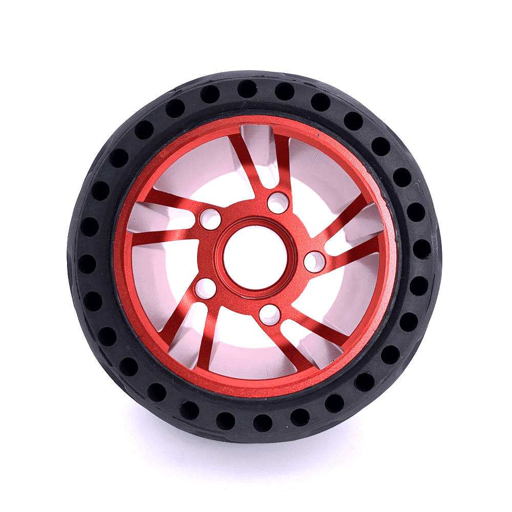

For those like me who loved the Cloud Wheel until that sinister cracking festival,
I found these with a kegel aluminium core that looks pretty cool, I don’t know if it’s a well known wheel ?
Any review ? (click the link, I’m not talking about the " windmill " model in the miniature but about the " Honeycomb " one)
As I recall, @kook’s official review is “Not terrible!”
I have also been eyeing the honeycomb wheels, specifically for riding in the wet, as they are treaded. They are heavy though. 510g per wheel. Almost as heavy as TB110’s, and likely less comfortable. Not worth $130 in my mind. Not yet anyway, when we are going into the dry season and I dont have a daily commute requiring me to skate in the rain.

These honeycomb wheels. (You have to actually click through the link, as this thumbnail shows the “windmill” style wheels that, understandably, ride like dogshit)
NO… NOT the BoundMotor abortions… the kegal core rubber tire… like @kenna used to pedal…
Is there a problem with bound motor ? I’m new, I don’t know them ._.
Here’s a pic of the “honeycomb” wheels, the ones that @BillGordon named “bacon strips”.
I guess there needs to be a vegan-friendly nickname.
You’ll find a few posts scattered here and there. The consensus being that they’re kind of shit. They only feel decent in conditions where you wouldn’t be able to compare them to a large urethane wheel. And it’s only in those conditions that you could be willing to accept the reduced range due to increased rolling resistance. And note that this is even worse the heavier you are, my kid can glide on those, and I feel like there’s a handbrake once I have all my weight on the board.
In comparison, the “windmill” ones don’t squish with as much variance, so a bit less inefficient and power hungry, but they still don’t feel anywhere near as nice as urethane wheels on good surface. Once again, this is the point, to never compare them with urethane wheels, because your local road conditions wouldn’t allow urethane wheels anyway.
So despite being touted as an all surface magic wonder wheel, those airless rubber wheels instead fit a very narrow niche in the market. Urban riding on pavers, small gravelly paths, acorn season, crushed seashells, wet stuff (untested)… but then, they also don’t compare with the allterrainability of 6x2 pneumatics or larger.
