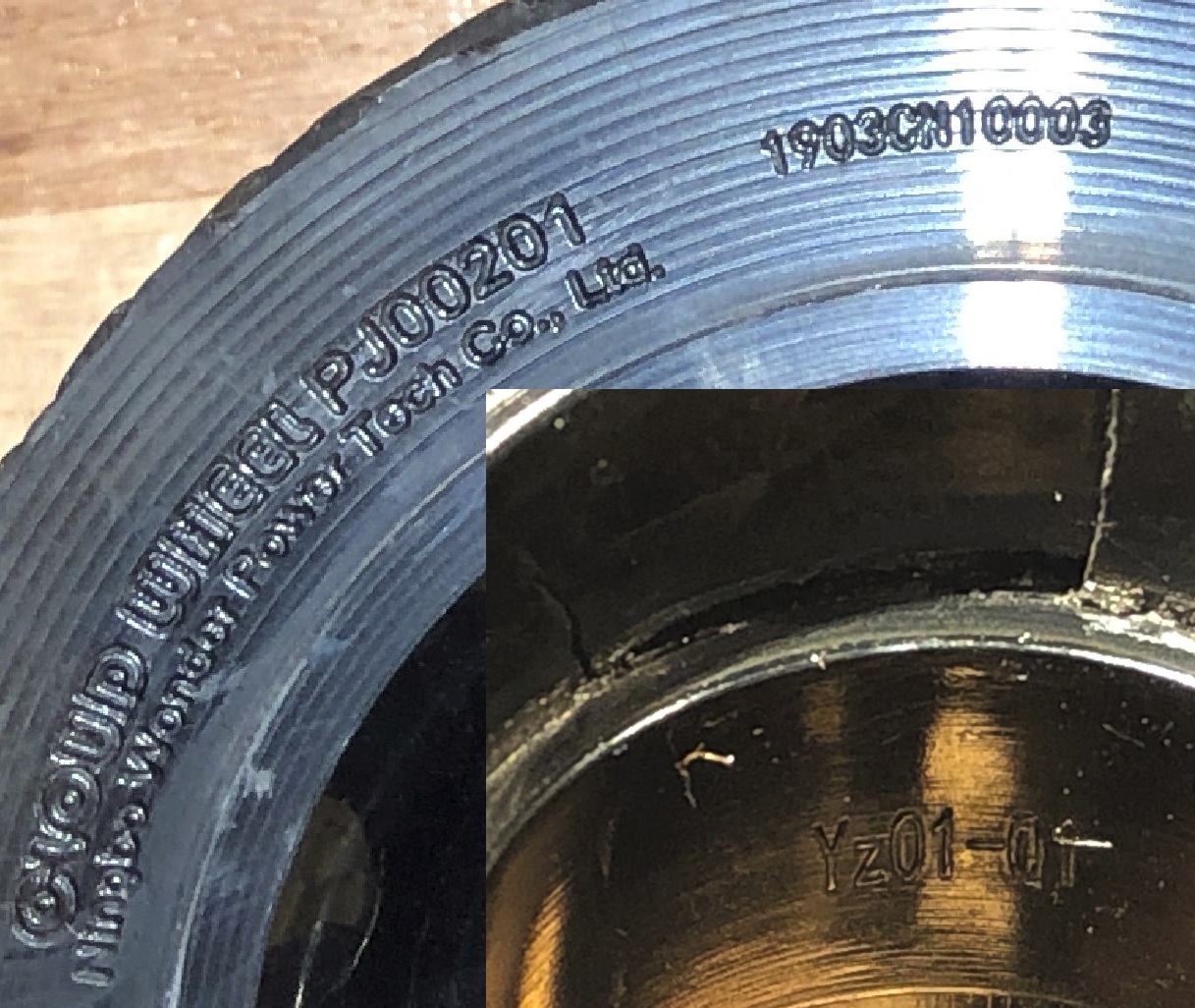

Mine had these written on them.

I ordered a microscope camera off Amazon to be able to inspect them more closely.
Unfortunately shipping is not 2 days right now so it may be a bit before I get the microscope can. I will also take better images of the old Wheels.
