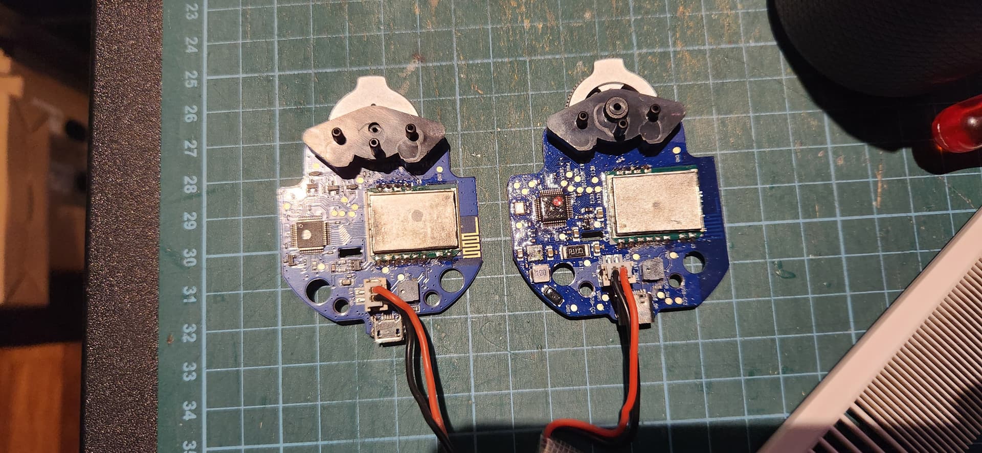

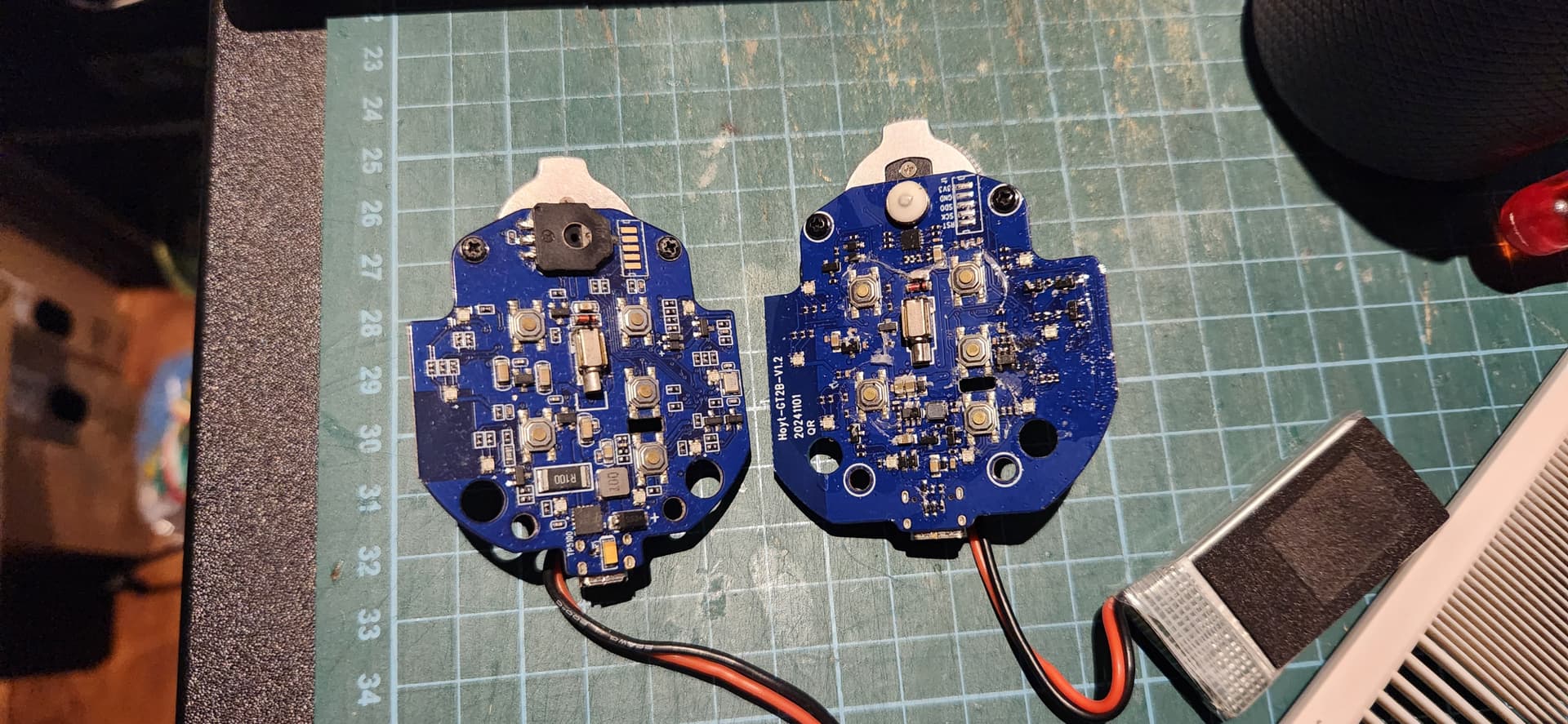

V1 puck PCB on the left, V2 on the right.

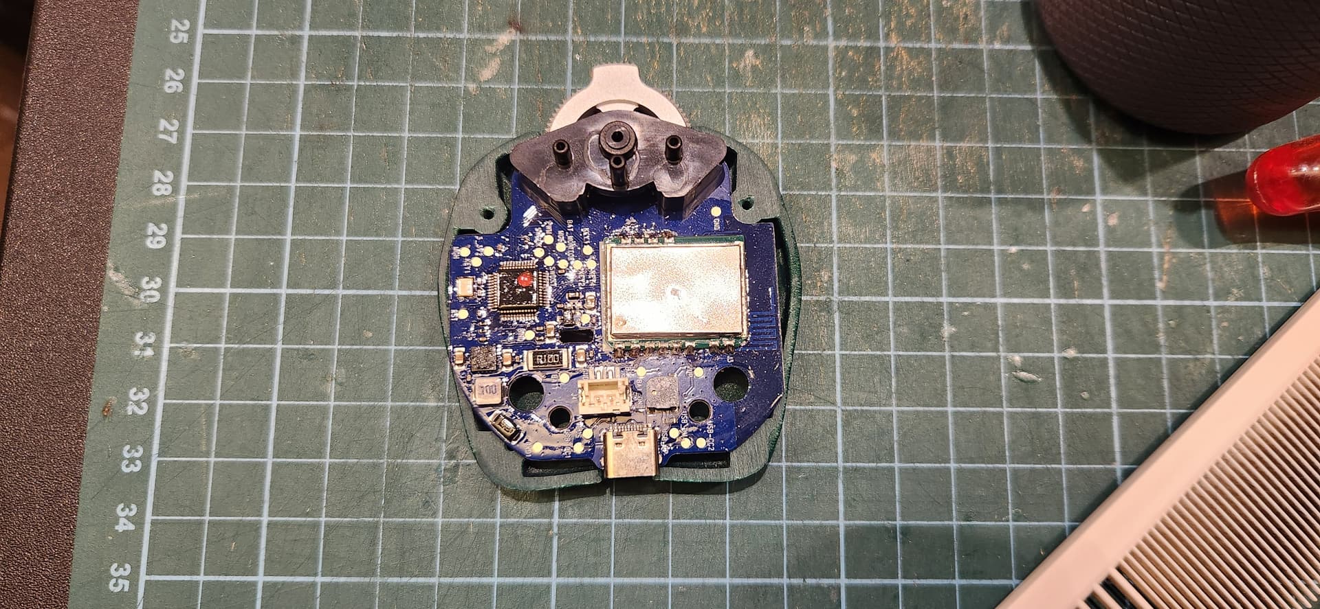

V2 PCB on top of @tomiboi puck model, just shy of about 2 to 3mm of space on the sides for the PCB to fit, as well as the screw placement for the bottom ones.
I’ve had a few requests to redo the nug for Puck v2. Does anyone have .step files for V2? I’m probably going to have to start from scratch.

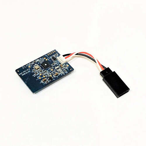

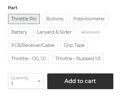

Looks like MBoard finally got the nubbie throttle wheel up on their site
Forgot where I saw someone asking for a receiver, they just posted that up as well.
Other parts @Unspoken

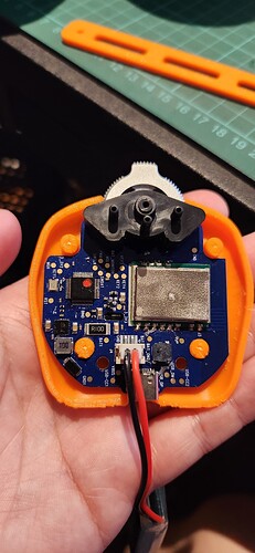

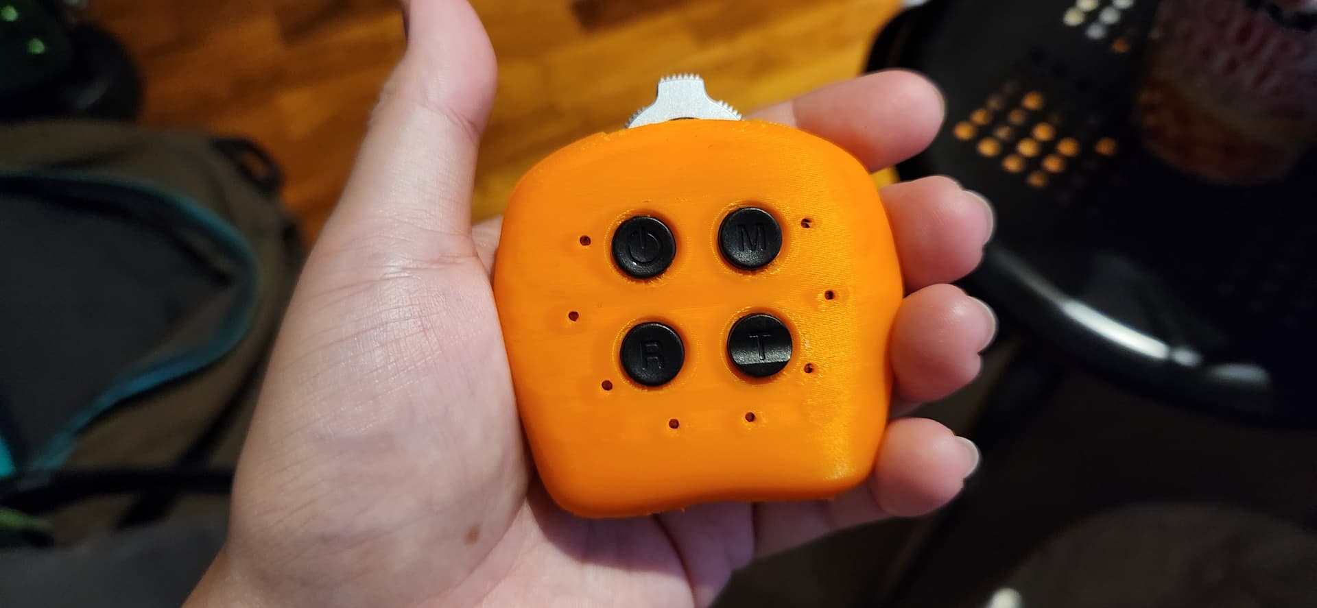

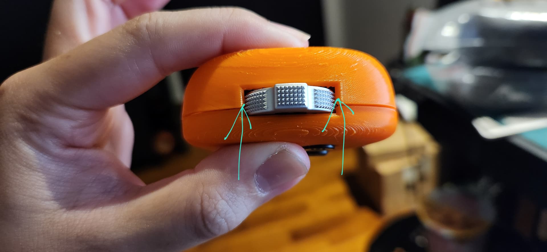

@Linny Here it is. I was able to use the original form. So, this is the same as Nug v1 except it’s 6mm wider. It still needs to be printed and tested as I don’t have Puck V2 guts. I designed it to work with M2 socket-cap screws. Lemme know what needs to be changed.
NuggyV2.3mf (786.5 KB)
Nice, i’ll print and test it now.

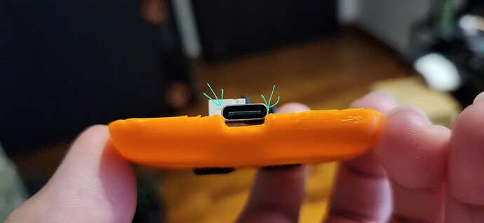

The fitment for the PCB interior is great.
Exterior is good too.

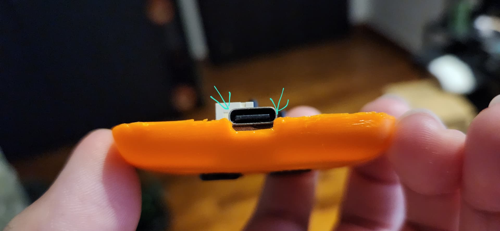

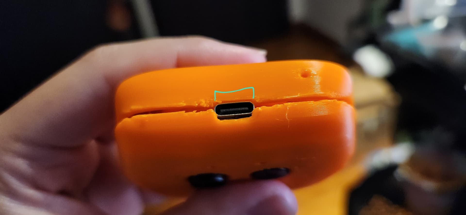

The USB C area for the top, the sides can be increased by a bit.

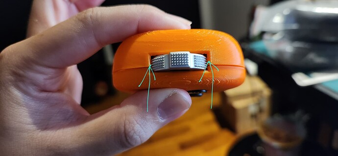

The sides of the throttle area is touching the thumbwheel, some allowance on these areas too.
This area is fine, just showing how it looks with the USB C
