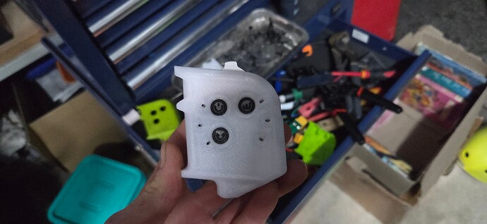

Does anyone have the print file for the buttons? Specifically for the triple button 2Poast2Mote
These are the original Hoyt 1 triple buttons
3Buttons.STEP (1009.6 KB)
The OG buttons are taller than the @poastoast buttons
plus with @poastoast buttons you get to push poast’s buttons.

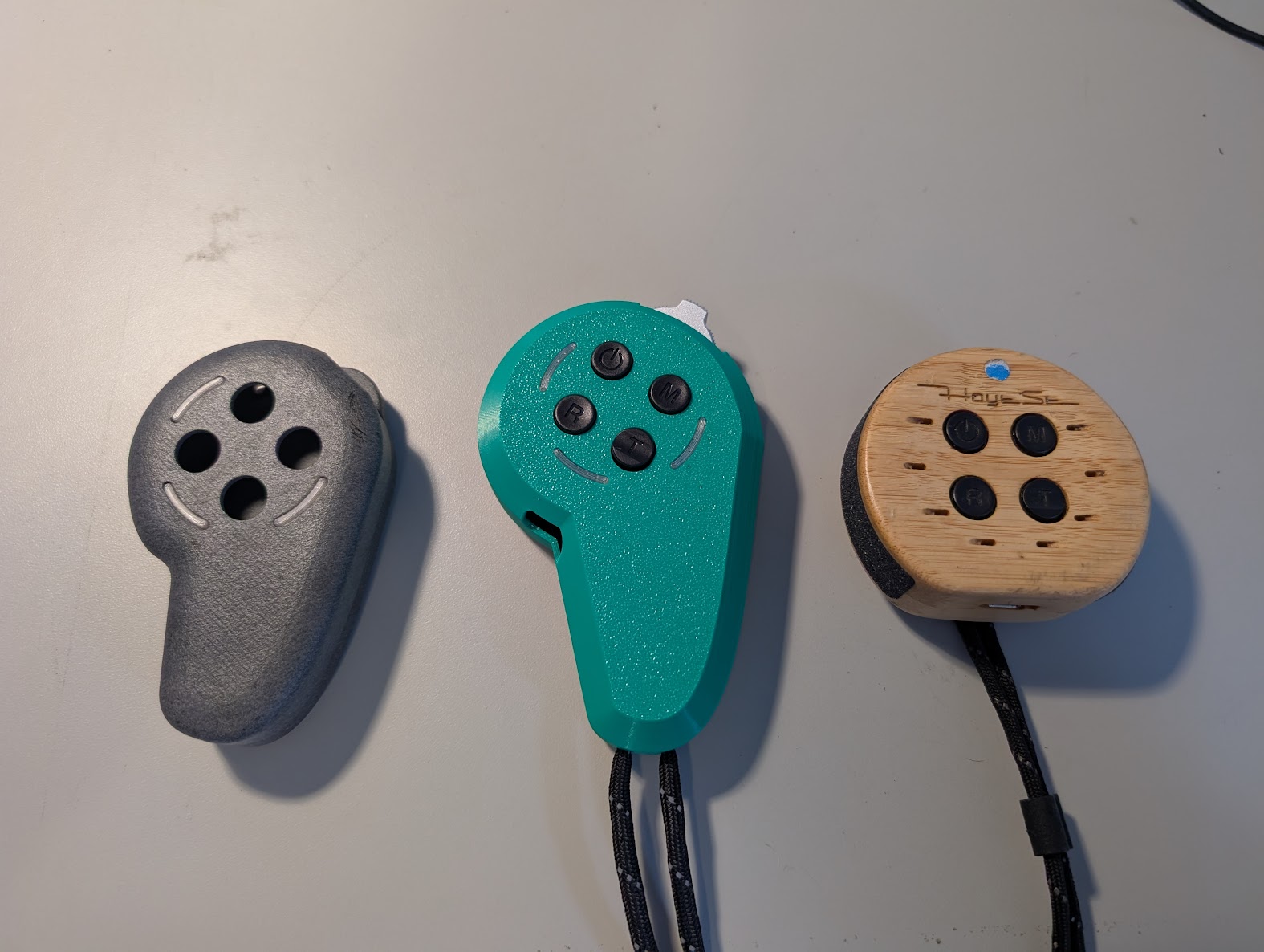

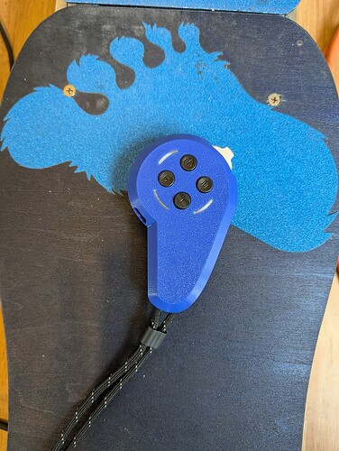

Ok, as mentioned somewhere I was not happy with the positioning of the thumbwheel on my new V2 Pro remote housing because the nub on the wheel somewhat changes the dynamic and I found that I had to move my thumb when transitioning from accelerating to braking. My hope was that moving the thumbwheel location back closer to my thumb would fix it.
So I made the changes several days ago, and yesterday got a chance to test it. It passed the test so here it is. Naming convention is kinda tricky because the first version would have been V1 of the Hoyt V2 but I called it V2. So this one is V3 of the Hoyt V2 which is techincally V2. Questions?
Puck V3 Housing Back.STEP (831.7 KB)
Puck V3 Housing Front.STEP (1.2 MB)
The difference in position is 10 degrees clockwise. Conveniently this moved the USB port out of the crotch of the tail which made it really easy to clean up.
Other changes include (as requested here) alignment walls all the way around the Housing Back (previously they were only on the tail); and a pretty nice (if I do say so myself) cleanup of the USB port.
Here’s the picture of the V2 for comparison
Please let me know if you have issues.
