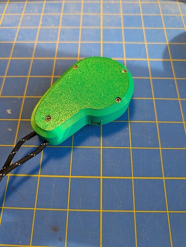

@Linny Here we go.

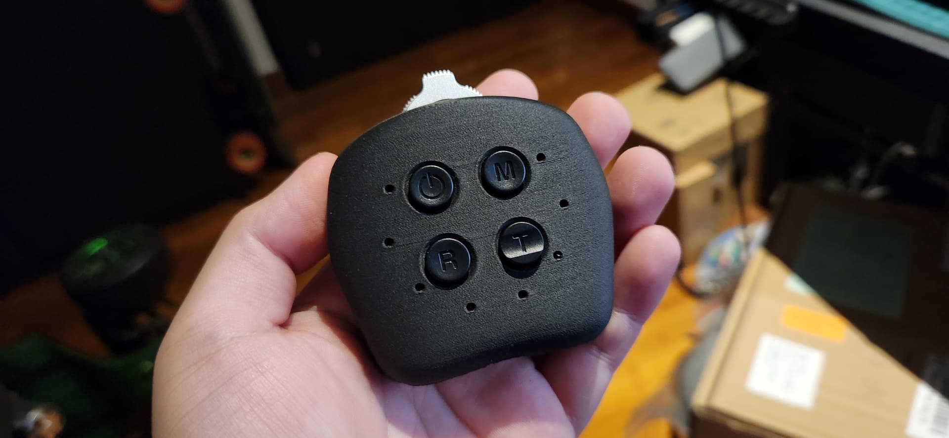

NuggyV2.3mf (782.4 KB)
I think its good to go. Fitment is perfect now
Ok, lemme know if it needs any changes.

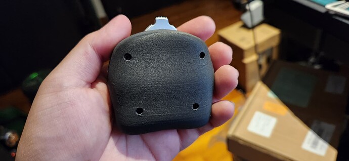

Printed in 0.08mm height at an angle.
Some adjustments that you can change for finer fit.
The holes on the bottom part of the case can be increased by a bit. It wasnt exactly 2mm on my print so i went at it with a 2mm drill bit.
The lipo battery shakes a bit when inside the case, i pasted a small piece of 2mm foam on the lipo prevent any rattling.
Other than that, great work!

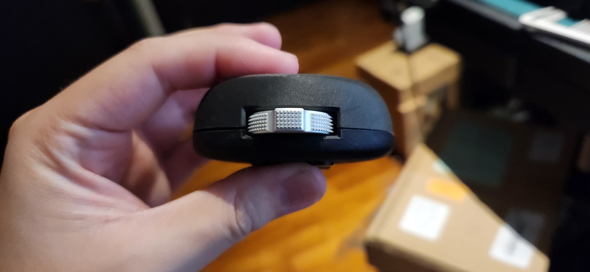

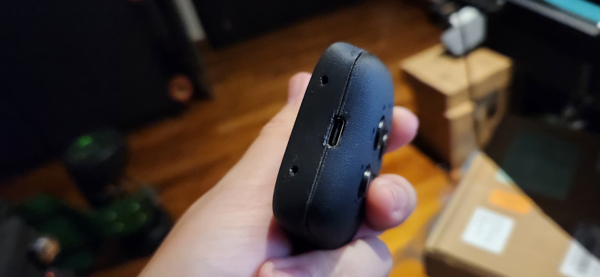

How does it feel in your hand? I kind of like the bigger feel. The old nug was a little too small.
The way i hold it, i have all four fingers on the side of the puck, and the palm pressing against the other side. Since its overall width got wider by 6mm its bigger yes, but still nice to hold. Not sure how bigger hands will fare but give it a try and see.

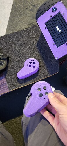

The v3 shell is on the board. But it was installed last night!
@tomiboi
Something you can update the model for. Theres a rectangular cutout for the vibration motor, i noticed sometimes the remote doesnt vibrate, the spinning area is probably touching the walls of the case so it gets binded.

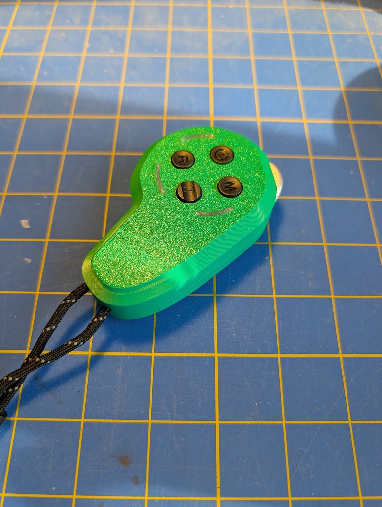

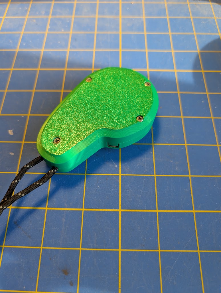

I made a couple of updates to the original Hoyt Puck Pro (Not the Pro 2) because fillet’s don’t 3D print well, so I switched them over to chamfers which print much better.
And a couple of other minor updates
Here are the files
Hoyt Puck housing Back 1-2025 update.STEP (698.5 KB)
Hoyt Puck housing Front 1-2025 update.STEP (697.5 KB)
Thank goodness, I can’t stand fillets in that orientation for 3dp parts
Totally agree, I I went with fillets earlier because I got a batch of them Laser Sintered.

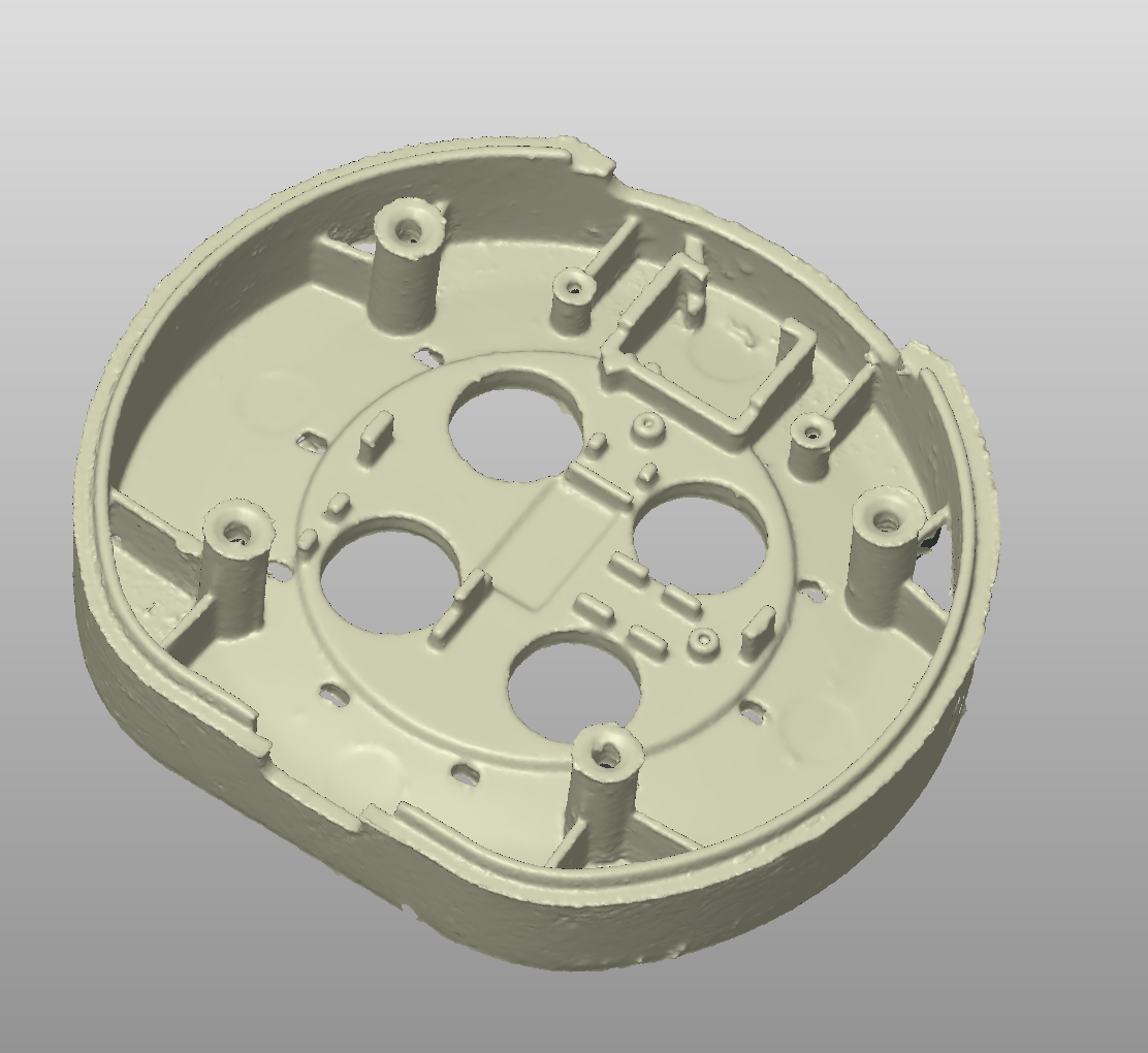

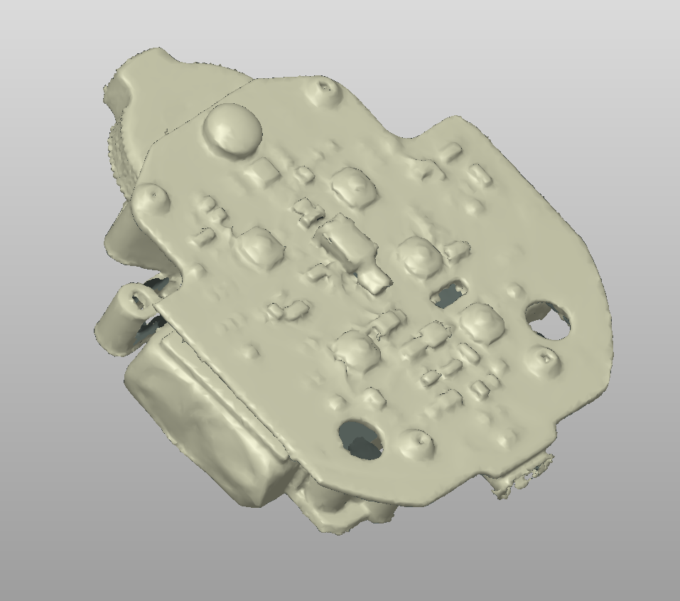

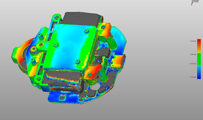

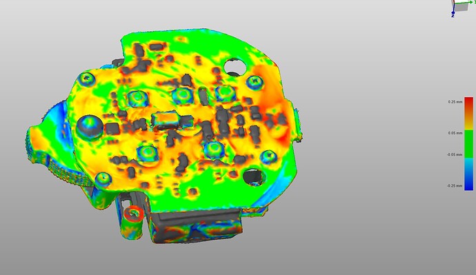

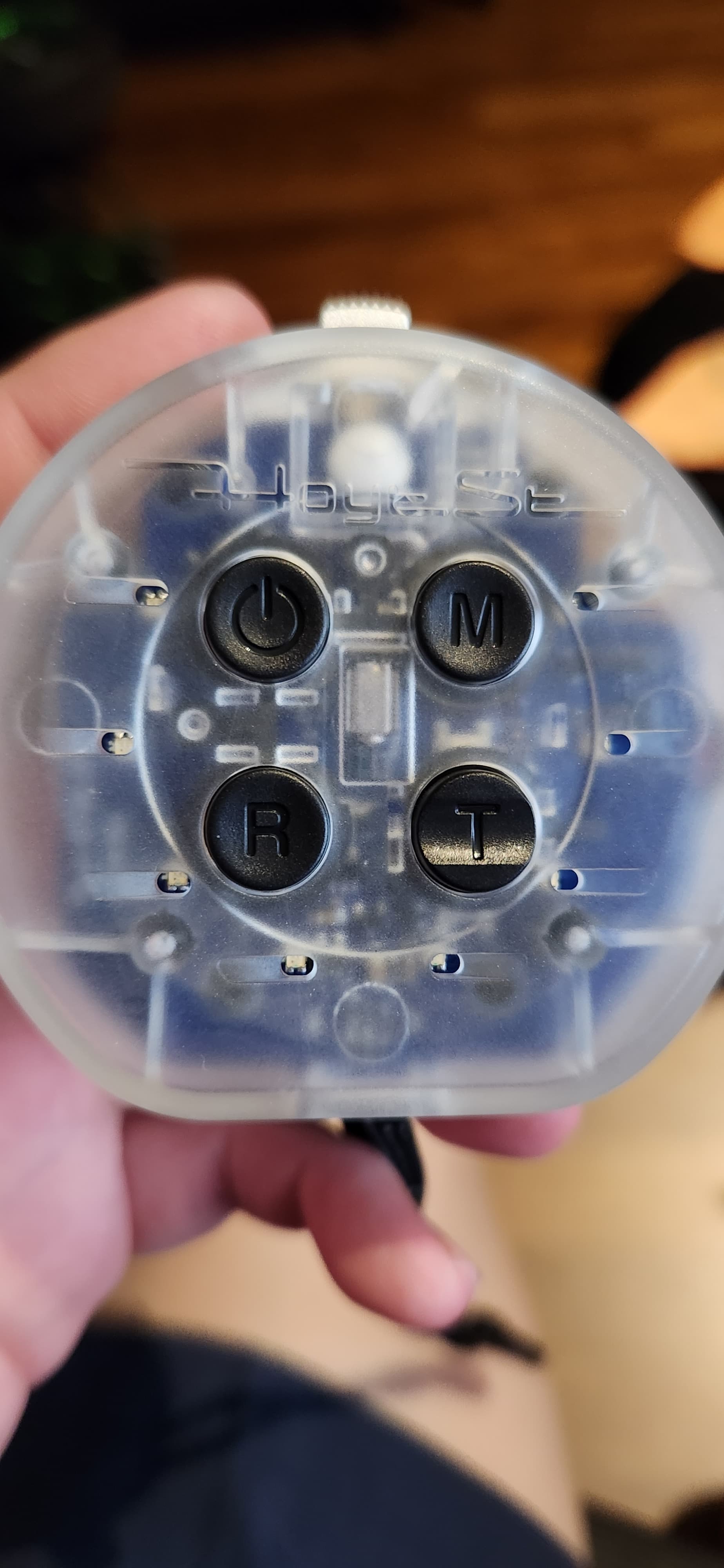

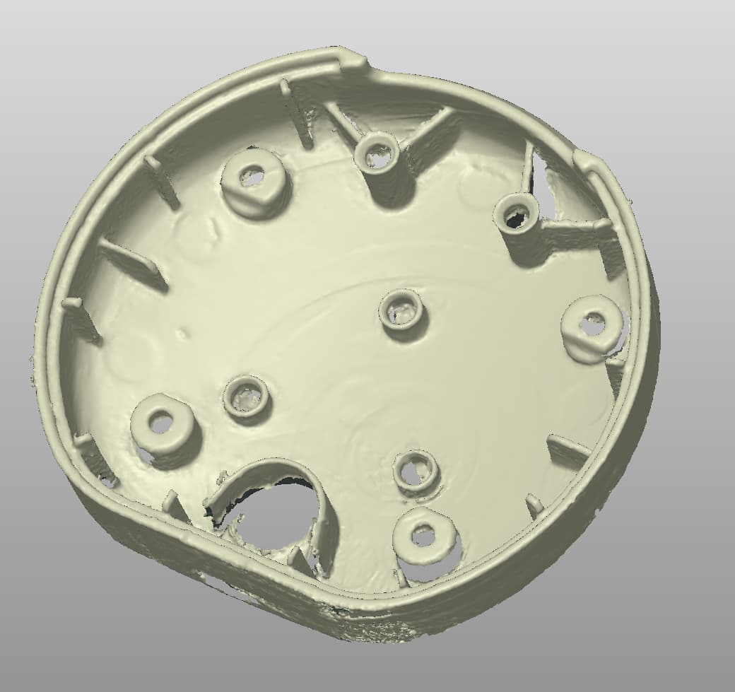

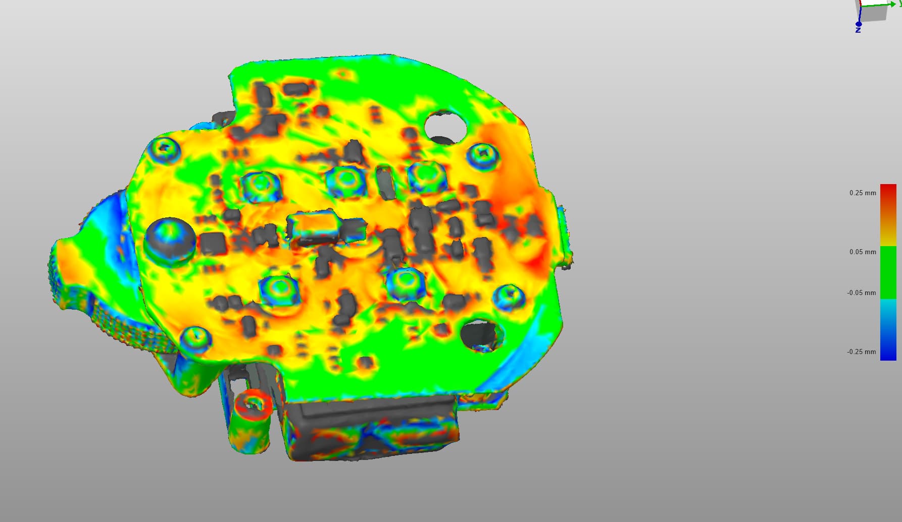

Here are some STL’s of the Puck 2.0 internals and the original case. Might reverse engineer these into STP at some point.
Puck 2.0 Internals improved.stl (4.3 MB)
Hoyt Puck 2.0 internals.step (376.2 KB)
Puck 2.0 Back Cover.stl (19.0 MB)
puck 2.0 Front Cover.stl (14.3 MB)
