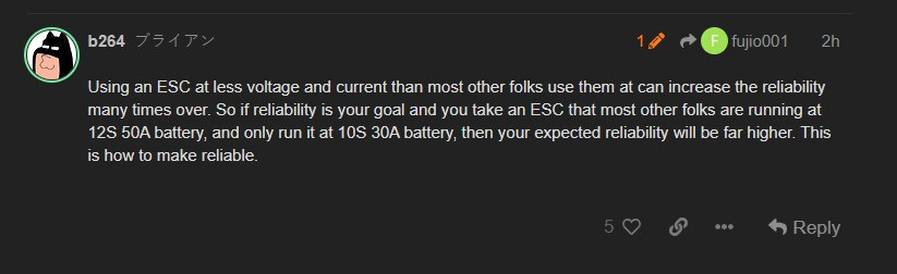

VESC 4.12 and a single 6369+ motor capped at 25A battery max and 10S
I have the same experience, my pair of FSESC Miini 4.20 singles also work great still. Just keep the battery maximum turned down.
