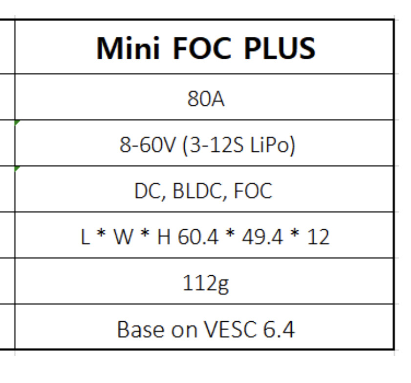

I was just taking manufacture specs you mention maker x so I went and screen shored the spec. A 3655 motor can not pull 55amps continually with out over heating it’s all about balance

I get your point, and quoted MakerX mini because it will overheat way before it reaches ratings quoted above on the spec sheet.
It would need better cooling to bear 80A at least.
