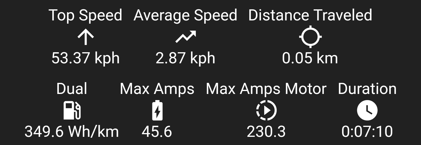

I guess my point is that I’m not sure the voltage headroom is needed anymore. 2-3 years ago when ESCs were less reliable, perhaps. Running a 12S ESC @ 10S? Sure. But I’m yet to pop a single ESC from transients and I run 12S @ 110/85 motor/battery amps on each side for 10’s of thousands of miles at this point.

Eh, my daily riding settings and 10’s of thousands of miles would beg to differ. I regularly push 3-5kW through that drivetrain. My builds last until I decide to break them down and rebuild something else. Haven’t had a single failure that I wasn’t intentionally pushing for.
