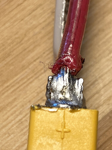

Practicing soldering for my DIY electric skateboard build, how does it look?

It might not be super pretty but that will hold. only thing that sucks is the jacket might be too far out for the insulating clip to go over, which I’m guessing is missing anyways. :joy:
Nice job improving :+1:
Yea I gotta strip the wire shorter so it won’t be exposed. Lots of room for Improving, going to try to have the connector on its side with the cup facing up and maybe with gravity the wire would be able to be more coated in solder
More solid joint
looks good. like the others said, dont forget to have a plug connected on the other side so that if the nylon melts, it doesnt morph the position of the pins! :slight_smile:
Yea I did that with this one and the pins didn’t move. Also found a way to make the vice grips not move as it’s holding the connector so it was easy soldering the wire to to the connector

From the melted insulation I don’t think that wire has silicone insulation. When you are doing soldering on your esk8, silicone insulated high strand count good quality wires are a lot better to use. They flex much more, which can be very useful when you don’t have much space to work with.
On topic though, that solder joint seems structurally good. The wire seems like fairly narrow though, maybe 14AWG or a bit smaller. Once you make a few more practise joints if you want, then you definitely should also try 12AWG first, and maybe 10AWG later if you want to run 100A+ current through the wires. Thicker cables are trickier to solder, as it’s harder to make a good joint in time before melting the plastic of the connector. 12 and 10AWG are the wire thicknesses most people run in their boards. Genuine Amass made connectors and good quality solder make soldering those thicker cables easier. Focus on good tinning, and try to make a good joint as fast as possible.
The way I do it, is touching the pretinned connector to the pretinned wire, then tin the soldering iron and immediately touch it to the wire. Ones it heats up the solder on the connector too, then I add a little bit more of my 60/40 solder for the flux in it, this should make the joint look prettier. I take the iron off, once I see the solder flowing into the right place. Watch out not to add too much solder, and then your joint will be perfect.
The wire in the photo is 12AWG
Ah okay, perfect! Just looked a bit thin for me. Nevertheless, don’t forget silicone insulated wires when doing the parts for your board! This looks like PVC insulation or something like that.
