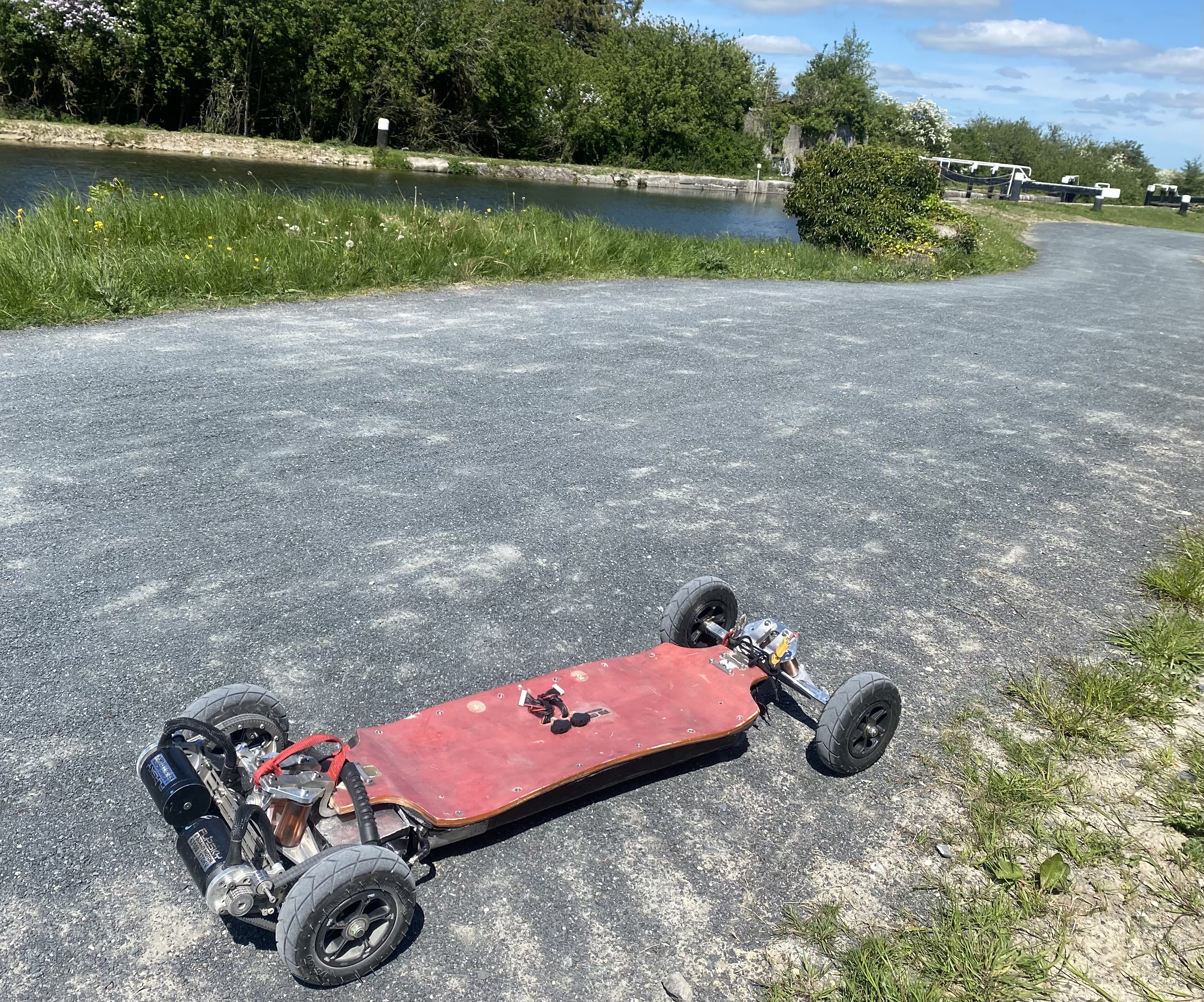

I went on a trip with the family often towing someone. I had a speed wobble <40 kph I need advice for, same thing happens on tarmac at higher speeds. Angles 32f20r, 3DS finality trucks, 330mm between wheels, 95cm wheelbase, quite soft bushings outer position in the back and inner position + washer for preload on the front. Hangers oriented offset inwards. Top of deck raised to 10cm above ground. I know it’s not as relevant but tyre pressure was super low to get rid of vibrations. (low enough to spin the tire and tube separately around the hub)
I feel like it’s the front that’s wobbling and inner position back outer position front is what it needs which is unusual. And I think it’s a skill issue rather than setup I haven’t had many miles esk8ing and have never met another esk8er or longboarder the technique could easily be whack.
So basically the question is- Is the riding really weird like should I bend my knees more, should I put the bushings further apart or use more preload, how should front vs back vary is mixed in / out position bad?

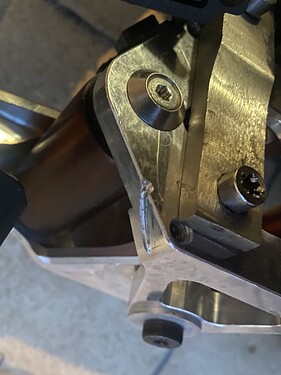

Y’all I really need some help. I moved the front bushings to the outer position and had a speed wobble low 40s kph, didn’t manage to control or run off this time.
My ass is sore, m5 screws tore out through the aluminium taillight, front truck has a gash, deck has a gash AND MY FVCKING MOTORS STARTED SPINNING BACKWARDS

Setup details
Angles 32f20r, 3DS finality trucks, 330mm between wheels, 95cm wheelbase. Hangers oriented offset inwards. Top of deck raised to 10cm above ground. I’m so low I’m destroying the cf enclosure on decent roads. There’s no unusual looseness. I’m using 60A bushings in the outside position, (I know 60A is very low normally, these are those really tall barrels 70A is really hard). Maybe I should use the inside position and stack washers for preload? Or harder bushings and bindings?

Well I ride Finality trucks at 40 km/h all the time without issues, so there has to be something else… What helped me a lot was to balance the wheels, it made everything a lot more stable…
Keep front bushings inside position. As a rule of thumb you should make sure that if you push the edge of the deck down with one feet (other feet standing on the ground) then the front feels softer than the back. I am guessing with outside outside at such a split angle this is no longer the case. The front should feel considerably softer than the rear.
Furthermore there’s the inherent progressiveness of channel trucks and the lack of bushing options, so unfortunately the tuning you can do is fairly limited. Don’t expect channel trucks to turn on a dime, but being able to go through a roundabout shouldn’t be an issue once setup well.
Also, counterintuitively, having your trucks set too tight can make falling because of a wobble more likely. On tight trucks, you cannot really do much if a wobble does occur. Loose trucks (especially in the front) make wobbles significantly easier to ride out and stay in control, but you still need practice and familiarity of how your setup feels on the edge.
Also, if possible, don’t go in a straight line if possible, but keep doing very elongated carves, it will keep your bushings more engaged and give you more stability.

The solution was using almost the softest bushings on the inside position but with an awful lot of preload. I haven’t gone really fast yet because it takes so so little force to turn rn it scares me but I have had no signs of speed wobbles and the turning is better than I thought possible so I think I will manage.
