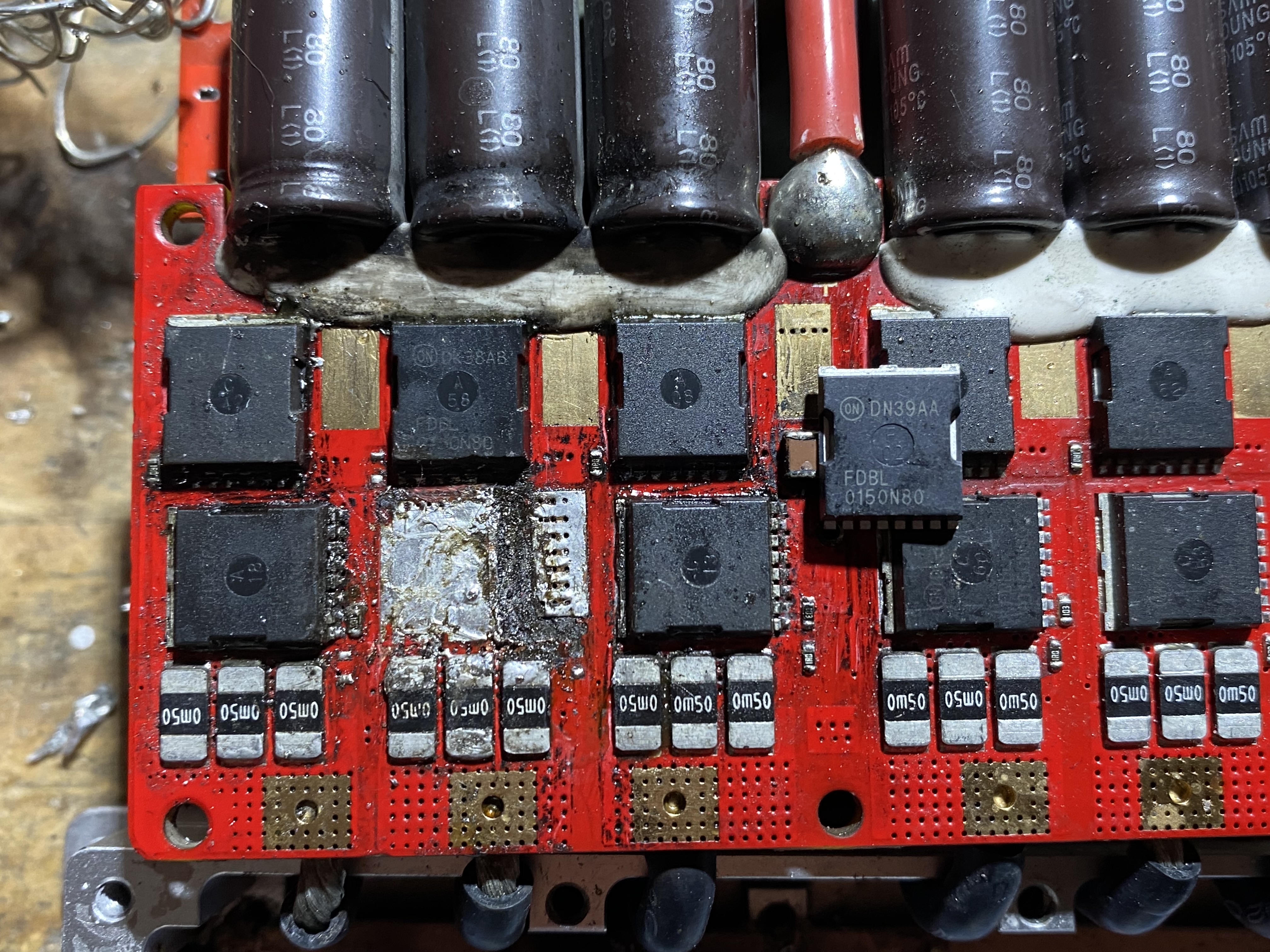

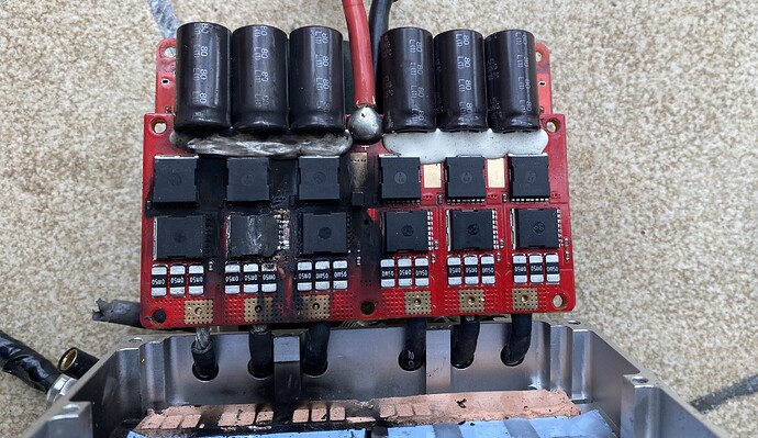

Another Spintend blows up.
I was just running motor detection, the motor on that side froze, and it blew. Luckily I had my hand on the loopkey and pulled it fast.
I can replace the fet the pcb underneath it is fully intact, I can replace one of those other little chips there are solder pads under where it was, but there is a crater where another used to be, not sure if it was 100% necessary. Could it live again this way?
Alternatively does anyone know of a cheap Ubox that’s blown up on just one side or has an intact power stage pcb?
Alternatively I might be able to reverse engineer a couple new pcbs from jlcpcb or somewhere because they only have a 2 digit number of components on the whole power stage. But why could this have happened?

If you’re considering going to go to the trouble of reverse engineering/replacing the power stage board why not reach out to sprintend and see if they have replacement power-stages? They advertise the separate power stage as a “repair” benefit on their store front so it’d be odd to me that they’d tell you to pound sand unless the version of your hardware was deprecated (this is also a fairly optimistic and non-cynical perspective).
They are really different, those are much newer, are based on 100250 instead of 75300 iirc and the pcb design is quite different. Just keep firmware and the configurator the same version from the start, fully compatible ones and simple.
Thank you that sounds brilliant I had no idea, could you show or let me know where on the website it is? I am on an older version of their VESC but I was thinking of that as a good thing because they might be more likely to send me files for the powerstage. If I can make them cheap I think hot swappable power stages might be the closest we get to VESC reliability. The one issue of I’m struggling to find somewhere to make a thick enough pcb.

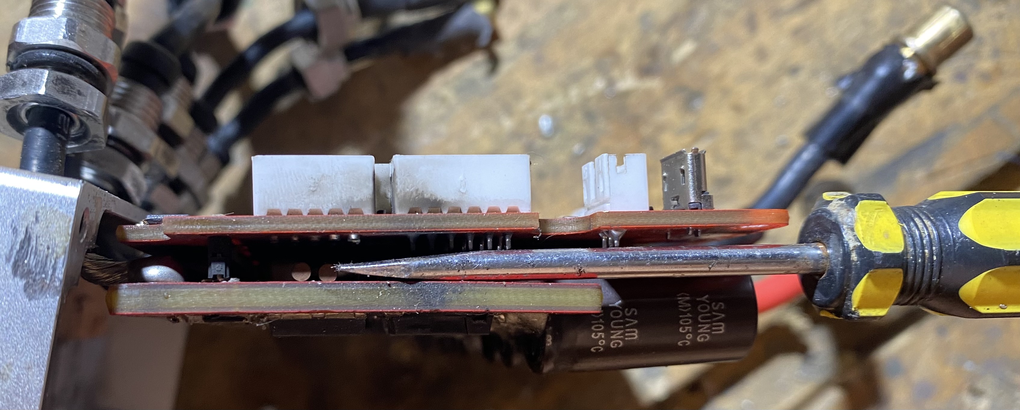

Regarding the Ubox dual Alu Lite if you scroll down they say “Replacable single board” as one of the changes between the Ubox V2 and the Dual Alu Lite.
I dont think they mention it in any of the other listings though I haven’t really looked all that closely at anything outside of the Alu Lite and Dual Alu Lite. Its also possible im misinterpreting the statement. But hey, the worst they can do is say no.

That’s surprising it’s just mosfets, shunt resistors and capacitors, if something was very expensive I could move it across. I can get FDBL0150N80 for not too much. The most expensive, or at least hardest to get and make is the really thick pcb with copper rails soldered on.
On a side note can I swap mosfets for ones with a few more V of headroom and slightly lower RDSon, similar gate charge and threshold etc or is some calibration stuff going to be messed up?

YES got the drain pad de-soldered. It was impossible with a 650C heat gun or 2 soldering irons but with a little Sn42Bi58 solder around the edges it came off immediately.
Of the 2 little things missing I am pretty sure one is a pull down resistor between gate and source and the other is a resistor between the driver and the gate. @Davewesh does that sound right? And is there anything else I need to know like replacing other mosfets to keep them all from the same batch?

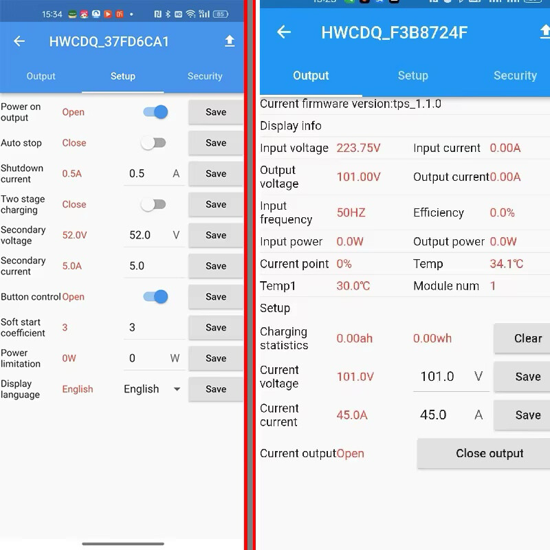

Where did you get those chargers from? Alibaba? I like this I could charge at 20S 50A with the next pack but idk how to order on alibaba.
https://www.alibaba.com/product-detail/Modified-Battery-Charger-Adjustable-72-101V_1601373319136.html
This looks nice but I would have 6 esk8 related apps.
