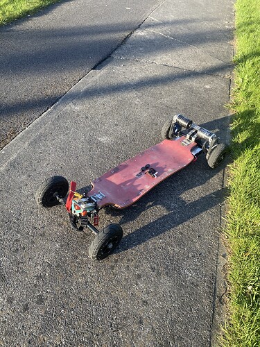

Powertrip - a big mess of an esk8
Power-trip, noun. : an activity or way of behaving that makes a person feel powerful : something that a person does for the pleasure of using power to control…
It is my first real diy esk8, so I jumped into the deep end a bit.
Not bad for a double stack enclosure, I couldn’t get much lower without it. Pictured is with 20mm risers, 7” tires and a couple mm clearance for flex so I can go lower and still turn.
I wanted power and range, to go fast and far even if I have to pick it up to get around corners. Pneumatics for sure, with wide trucks on low angles to take stability out of the question. I also want the cruising speed, battery power and the 21 amp charging for long trips with the family, especially towing one of the younger ones like in the past.
I live in Ireland and there is a few cm of water on the roads a few weeks a year so waterproofing is important.
It’s on a tight budget but I think I did a decent job and got lucky apart from some dumb choices. This is another teen’s esk8 journey. (Big fan of your work @Dnollie)

Due to the budget and what I wanted, I had to design and machine some parts myself instead of buying them even used. Split angle brackets, offset motor mount thing, 80T pulleys, anti-sink plates and a tow point for carrying and hooking a bike onto.
Custom (CNC) parts
I made angled drop brackets, 20 degrees in the back and 30 in the front with more drop at the back to make up for the angle. I will update with more pics when I am back able to sand and polish them in the metalwork classroom.
I think I overdid the drop bc I’m on 20mm of risers atm. Also made some 80T pulleys and anti sink plates. The brackets curve back and I use a shorter mounting pattern that’s 6 holes instead of 4 to help with keeping the wheelbase in check and withstand big risers. It’s cheaper than buying even used pulleys and brackets. I 3d printed wheel spacers during work experience at a materials research centre which was cool.

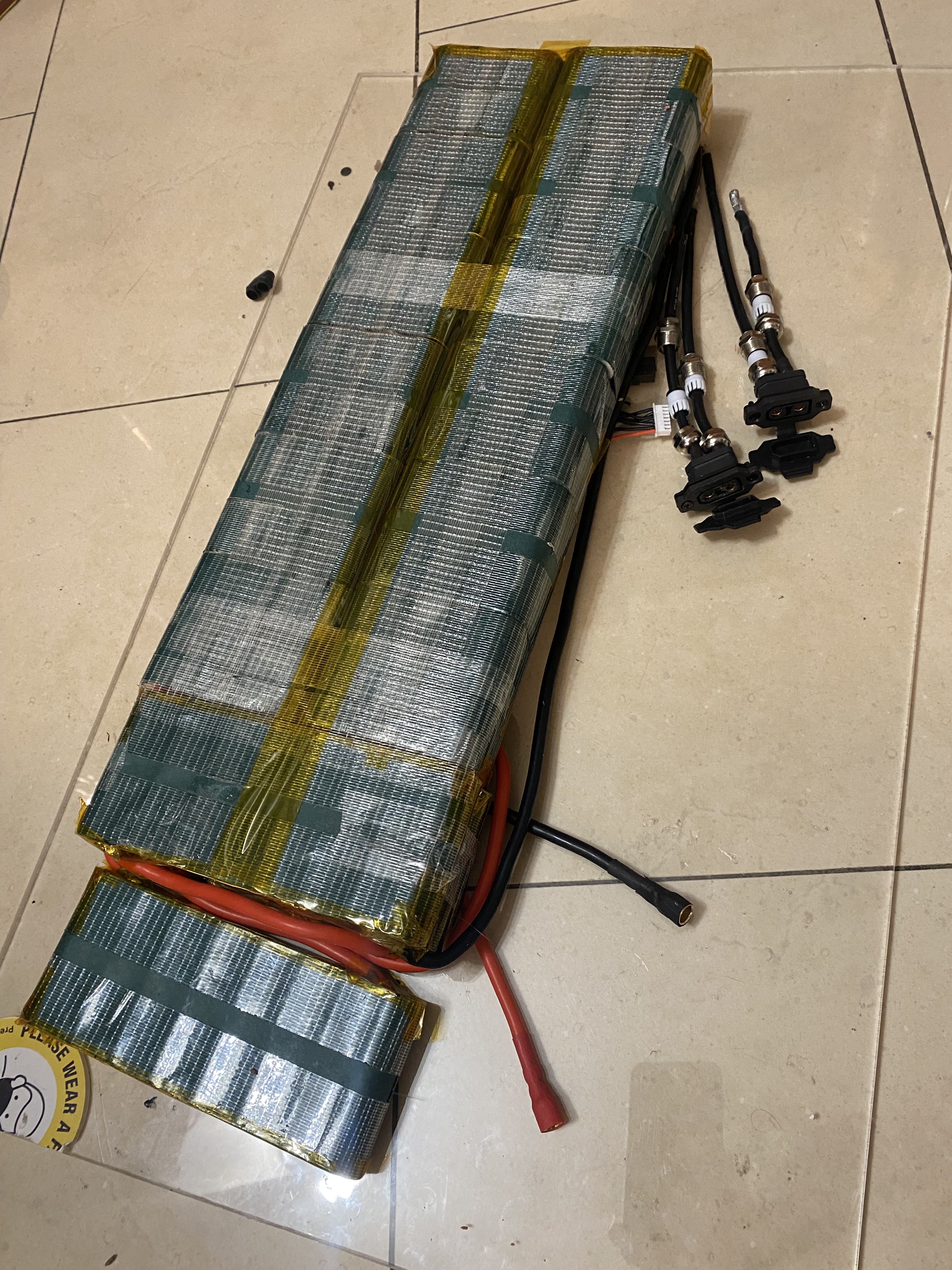

12S10P budget battery build, 500amps?
Deets and pics
I couldn’t afford to pay someone to build a battery or buy a built one, so I bought 126x Samsung 30T from Nkon at €1.16 a piece + €9 ship. I think I did a pretty neat job bending the tabs, wrapping the groups, wire management etc except the series soldering isn’t pretty.
Trigger warning, not extreme but bad practices inside
I know it’s not flexible but I’m not building a bendy esk8 and it can carry more current than I could need so not a word please and thank you. Also don’t try figure out what’s going one with the extra 12S2P, it’s only going to make you more upset and by the time I realised what I would have to do it was too late. I really regret a lot.
The community welder was super helpful and credit to @mr.shiteside for fixing it. The pack is welded with 0.3mm slotted tabs and 3P of 8awg so it should at least make use of the amps if only 30 amp hours. 30T were tested to 50 amps here, so theoretically it could do 500 amps (aka never worried about overheating or too many battery amps through flipskies).
I was actually thinking of selling it but after it wasn’t built by a skilled local builder with a kweld I’m friends with but a 15 year old (me at the time) I wouldn’t be comfortable with that. The reason for the “smelly” sale thread a while ago was in case anyone wanted it in a mtb format or with the normal balance lead attached as well before I clear heat shrink the whole thing.
I am charging really weirdly using 2 LiPo chargers, a 1.5kw server psu I diyed and separating it into 2x 6S10P with the loopkeys so I can charge from our solar batteries when the power goes out and plug my TS100 straight into it the extremely shocking number of times I have to solder excavator wiring or some bs away from home. I believe each group is at around 1 miliohm of resistance. I can charge less or more for health or range and at 0.1-21amps. I could theoretically take a 1kwh 12v starter battery to the nearby-ish track and top up on location at 750w. It’s going to be neater than those pics I’m making some panel mount connectors and charger holder thing.

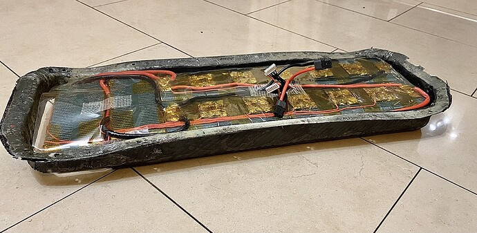

The deck and enclosure, I would have loooved to get a Lacroix and there was a $100 Nazare deck and free (in need of repair) enclosure. A flux or Tomiboi mtb would be the dream but it gets expensive. After the effort on the brackets and aluminium standing platform extension it’s still worse than a Lacroix. Man if only glyphics hadn’t thrown away the damaged Nazare enclosure (no hard feelings obviously).
Deck and enclosure work
I sanded the paint off and cut the ends off for the brackets and put in M5 rivnuts. I want to make an extension to the standing platform by bending alu flat bar, I would get more leverage on a wider deck and if I’m accelerating flat out I can plant my foot further back against the bracket/on the mounting holes.
The enclosure was a little thin so I wanted to skin it in cf considering the battery inside it and distance to the ground. I will do the deck later on.
For the heatsink, I wanted to not lose any height and may as well get all the cooling possible so it makes up some of the back and sides and sticks up inside the enclosure a lot.
I added 2 layers, it was a disaster I didn’t use enough epoxy so in places around the top/edge it’s up off by a few mm and I then sanded through and re-applied like €40 of easy composites epoxy just to wreck the result on the last layer trying to help with curing and getting the bubbles out by leaving it somewhere warm which was fine for the cf and epoxy but the fibreglass bubbled up. :sob:
