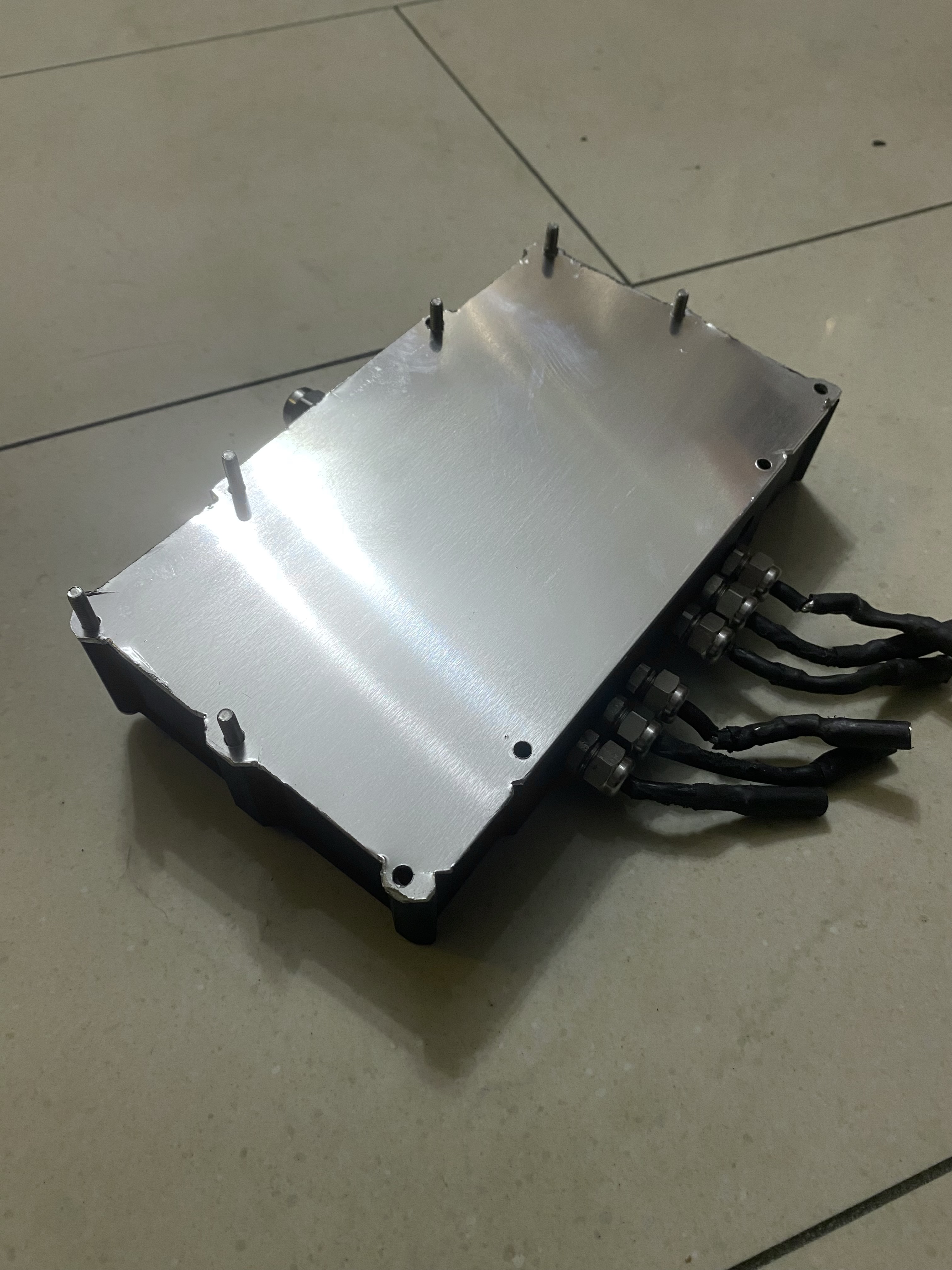

Designed and printed this Ubox case on my school’s new X1C. I screwed up the dims and I’m too shy to ask to print another, so need a new heatsink.
But how much heatsink until it’s pointless? Like this thicc one in 200x150x35mm or 135x100x35 bc it’s cheaper?
If it would help with the 200 battery amps I could use thermal paste and copper between the fets and heatsink to spread heat more but this is sounding extreme and it’s just instantaneous current really.

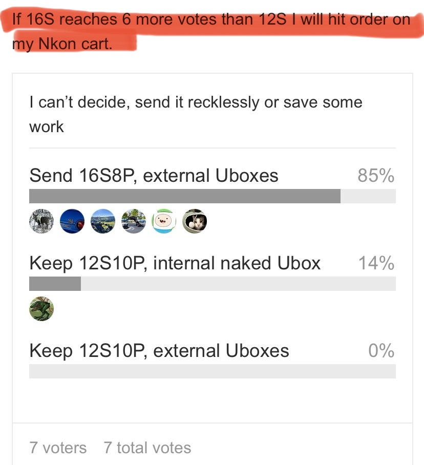

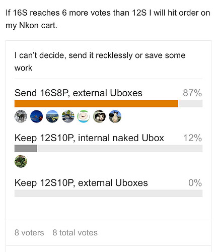

Decision time.

Would not overdoing it be 14S instead of 16S?
I wouldn’t need to have an awkward top mount box or cut and repair the heatsink out of the enclosure. I put both setups on the 3d servisas calc and it would be like 43 vs 49km and less current draw on everything but it would still be fast enough and no less low end torque.
I just lose a little range, charging and top end power although I could max out the battery in 4wd and am interested in 0-20/0-30 so 16S would help.
