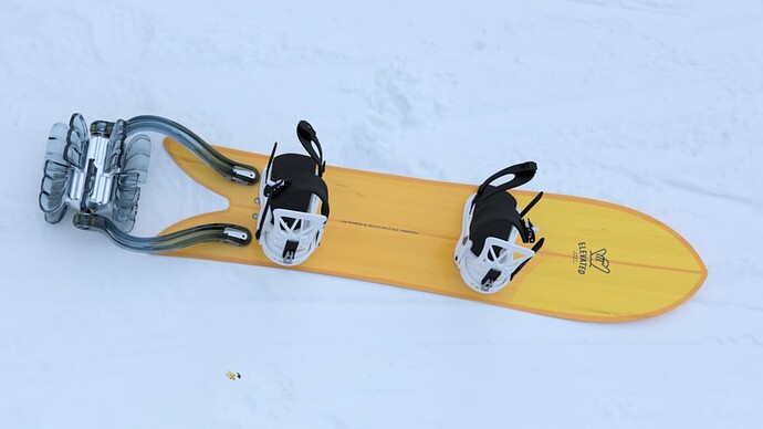

Power Traverse - electric snowboard
Keep in mind it’s a snowboard, so cooling is sort of everywhere
haha, take your soldering iron and put it in the snow…even 30W of heat can do huge trouble at the wrong spot (e.g. flanks of a plastic gear). ± 30°C ambient don’t help when you are far out of the thermal equilibrium.
We have metal gear options… We can make the stators wider with more slot fill.
I asked for 1500RPM and 100Nm, let’s see what they say.

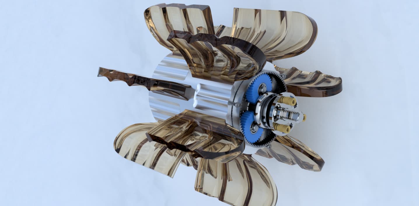

We are going to spend the next 20 years pushing the limits of what we can do.
Hit that first motor @ 21s 120A. The setup is heavy, it goes uphill. ~60Nm
Now looking to get our higher kv motors running @ 16s on the $120 controller with sensors.

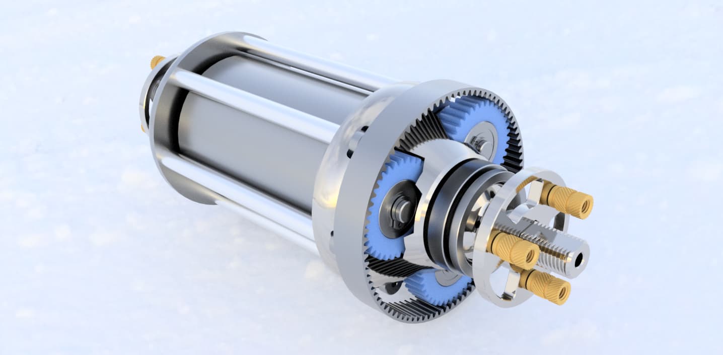

I think dual 5065’s with a gearbox is the lightest setup. Saves 5lb in metal + 5lb in lipo.
We will try and design a planetary version if the numbers work, should have more data soon.
Big single.
Expect multiple solutions.
It was hard to mesh dual idler gears. Took 3 days of reading to figure out the math.

gearbox v1.5
Stuff any single up to 63100
Couldn’t fit the power line :frowning:
Refactored progress.

Yesterday we redesigned the arms and finished the rotor.
Test fitting and fixing the issues…
I want more top end but think we have a winner.
