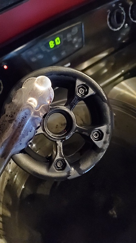

Fivestars ftw! Plus they take dye really well so you can customize colors.
To be faiiiir, the rockstar 2s are nylon and would take dye the same :stuck_out_tongue_winking_eye:
Results vary… Black seems to absorb well while other colours like Kentucky Sky didn’t work for me

Did you double the dye like the recipe suggested? Also you used the synthetic, you should specifically NOT use the synthetic type.
I used this, all purpose and had nylon listed on the bottle.
How come xD ? That’s interesting! I didn’t double, no, and I used synthetic… Right I’ll try again soo then with your method haha :call_me_hand:
For deeper colors, it is recommended to double the amount of dye used while keeping the water, dish soap, and vinegar the same.
The synthetic version is meant to dye specialty fabrics (polyester, acrylic, acetate)
The all purpose version is made to dye cotton, wool, and silk, as well as synthetics like nylon and rayon
You will have much better results using the all purpose, I promise!
I also recommend doing them all in one batch to ensure the same color. I bought a $15 large pot you’d boil seafood in.
