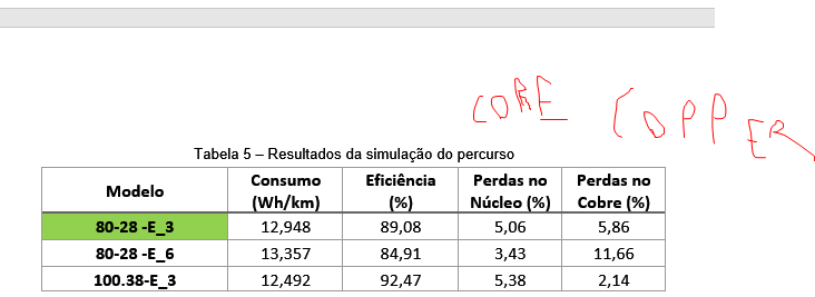

On the hubs maybe, but I did process 400 km of logs I had on my belt drive MTB. Considering the whole ride, the split between core and copper losses were almost perfectly split 50/50
This is due, at least for my riding style, the average torque being really low, so even if on hard hills and accelerating the copper losses are big, they balance out with a lower but almost constant core losses (riding as speed)
And you can do a hub that using real ride data, get a almost perfect 50/50 split on the loses, as seen on the first DD design of this table
why is the DD on your table getting half iron and half copper?

In short words, because it’s the optimal design for they way I ride, lots of candidates were considered before reaching this one

what motor is it or did you make it? curious what motor design is most efficient DD motors for how we use them. in my simulations, which weren’t much, getting the biggest strongest magnets in was best i could do. getting a new stator design wasn’t an option. very surprised with the motors ive been making having much lower cogging torque and went against the simulation results and common assumption as this stator has slots that are larger than the past as well.
It’s a 80 mm stator, 24S28P, I will refine it before making one day
It’s always a balance, stronger magnet is not always better, sure, you increase the motor Km, but the core loses also go up, if you are near the end of the linear saturation of the stator iron, the core loses can skyrocket
