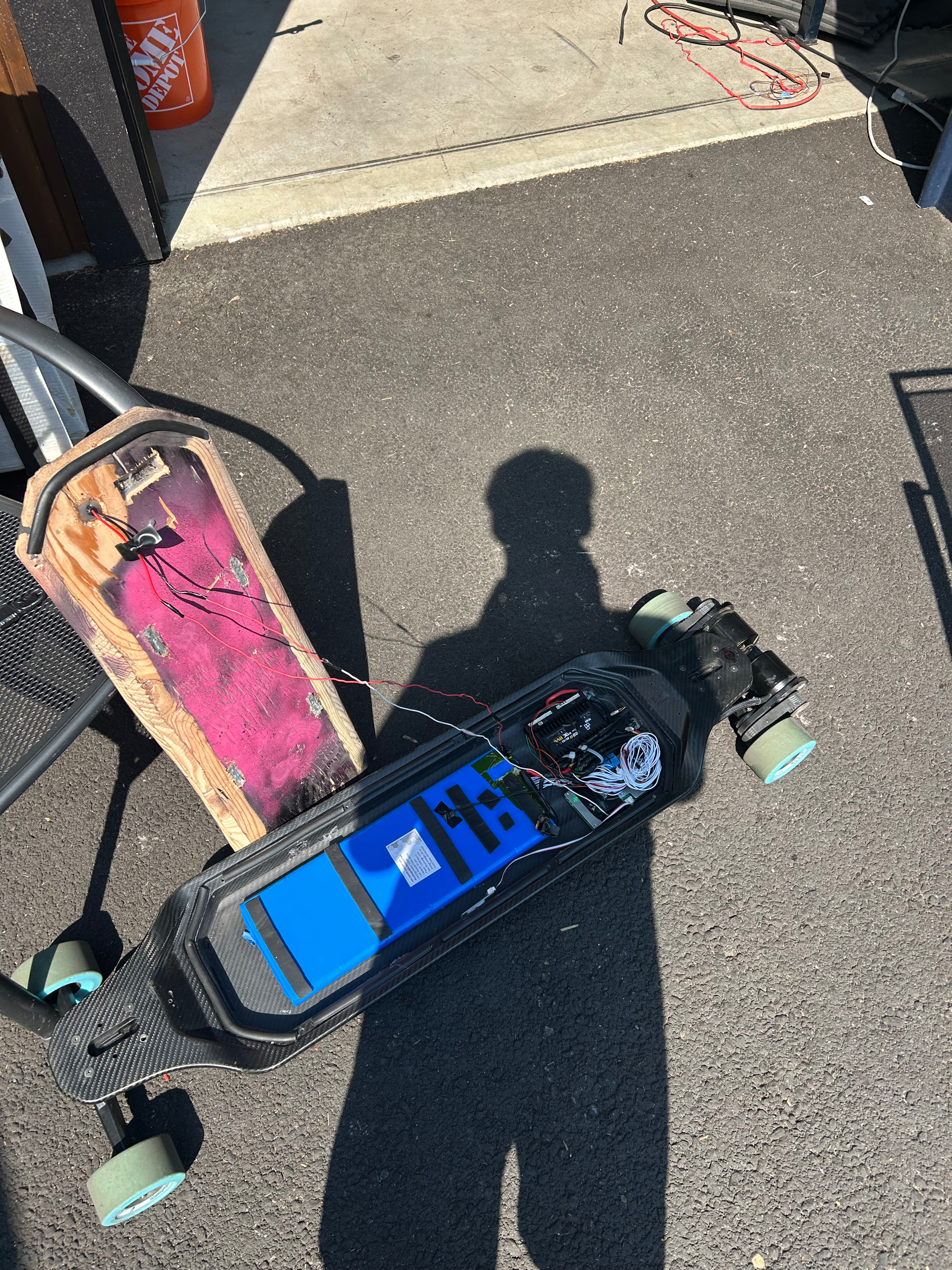

Pink Puma, first ever build. 10s4p, flipsky 4.2, dual 170kv motors
I was just thinking that most newer ESCs are going to come with a power button. It would suck if you ever wanted to switch and were forced to either stick with the loop key or plug it and find a new spot for a button.
I would just hate for you to modify the deck, find out it does not work the way you expected, and then wish you had kept the option to use a standard button.
I like the idea of breaking the circuit anyways in case anything goes south. It’s already in the deck now​:joy:. Just hope I don’t get a rock that hits it and breaks it.
Looks like a good tucked away spot, My only concern would be a stick or something catching the loop and yanking it out.

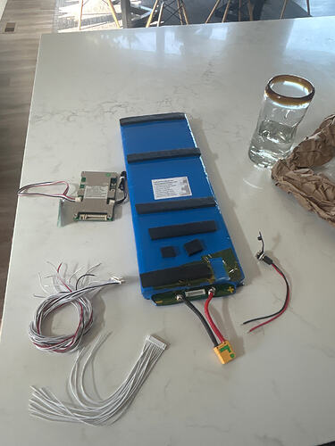

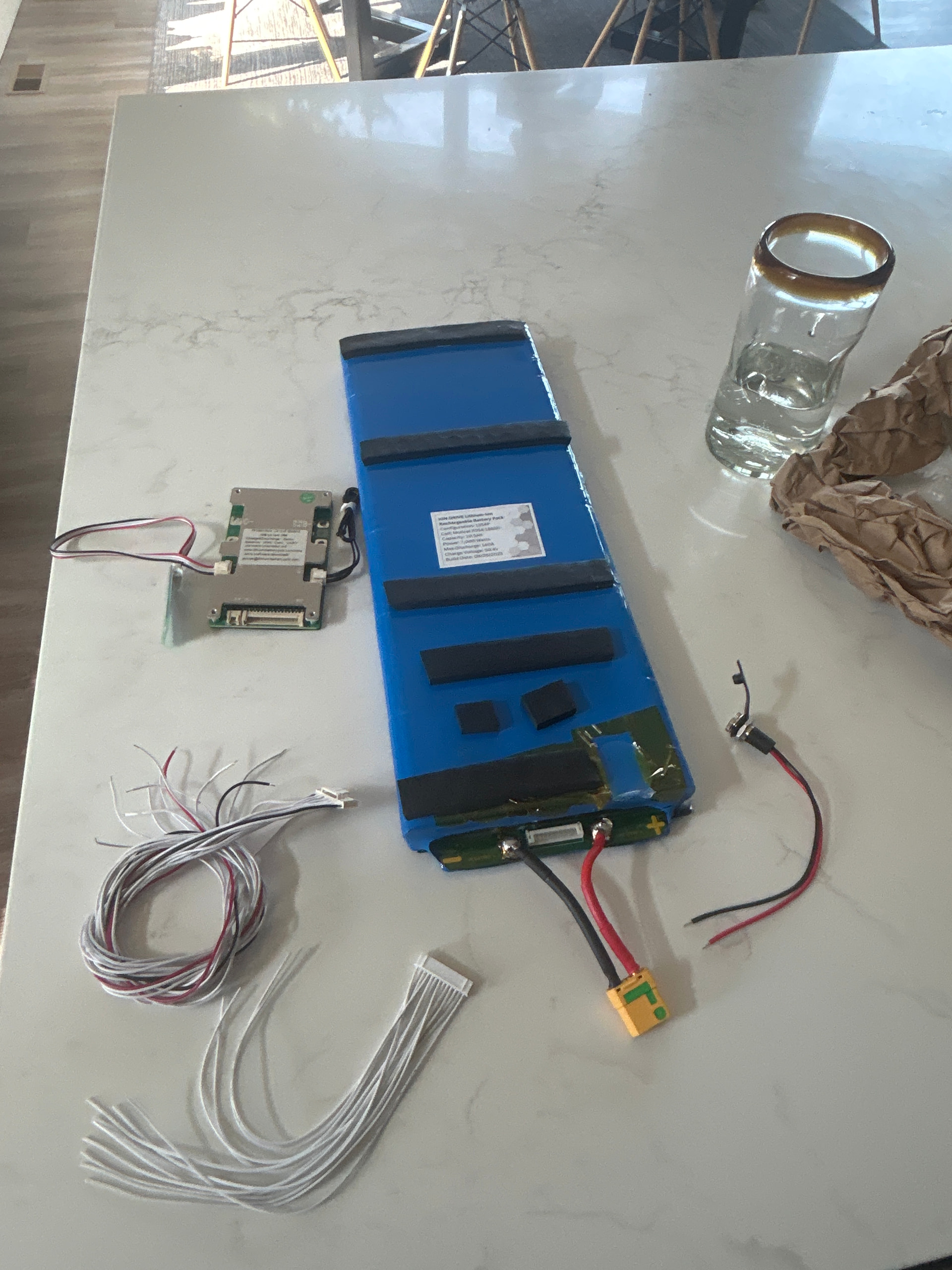

Wiring a bms is actually hell​:pensive_face:
i got everything wired up but now im to dumb how to figure out vesc tool. nothing is working for my remote but when i run motor detection they spin up perfectly fine. HELP ME
Welcome to vesc. May Skatan have mercy on your soul.
