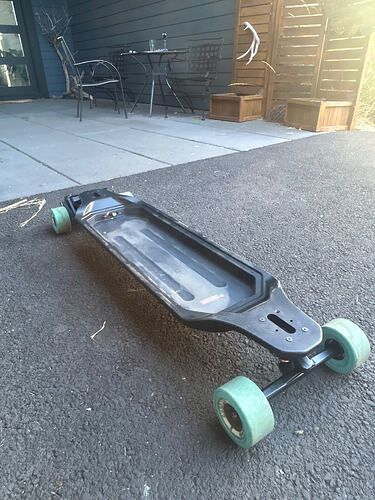

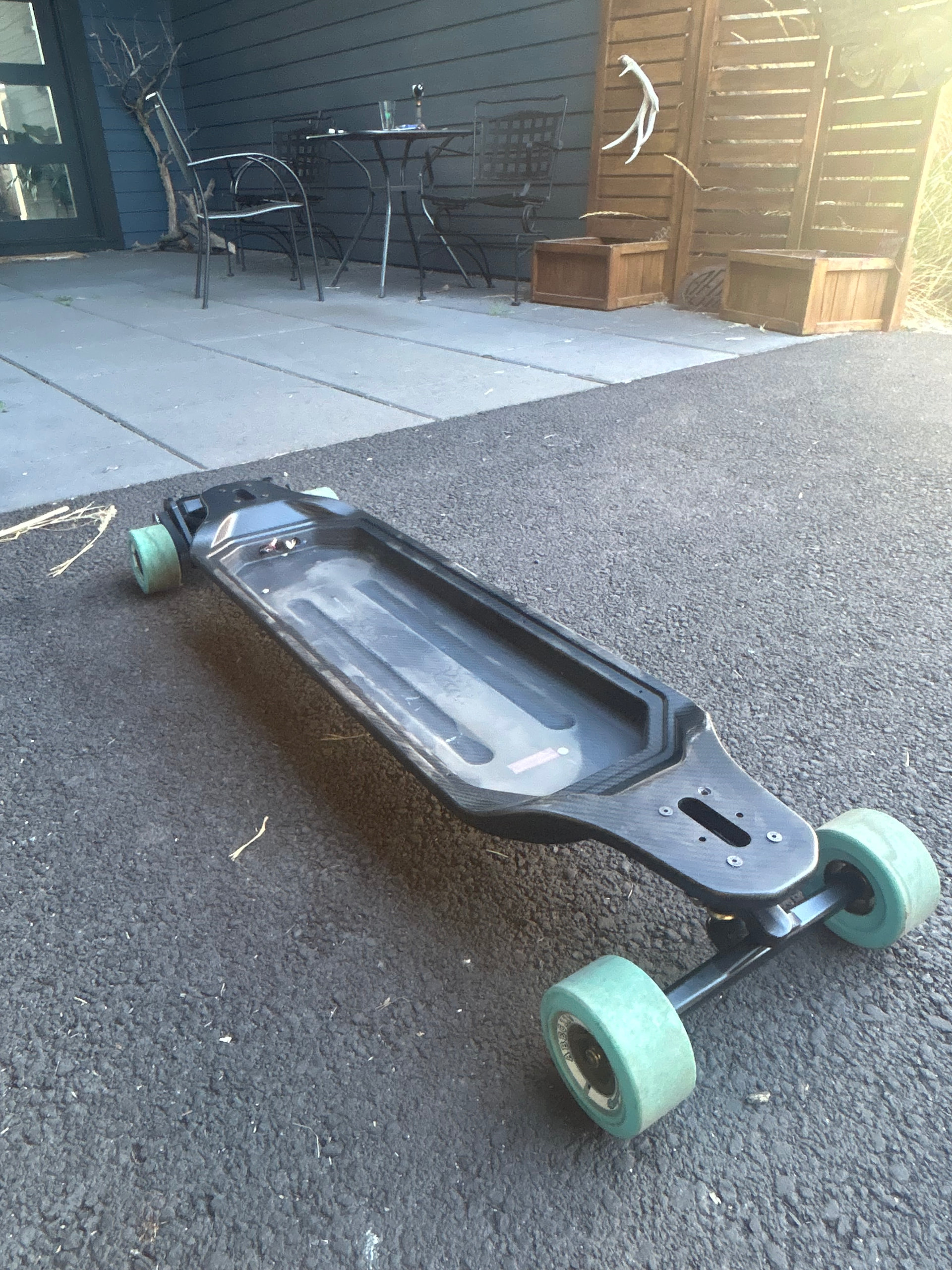

For the deck i chose the used metro board pheonix deck off of Mboards (didn’t realize it didn’t come with a top to the enclosure).

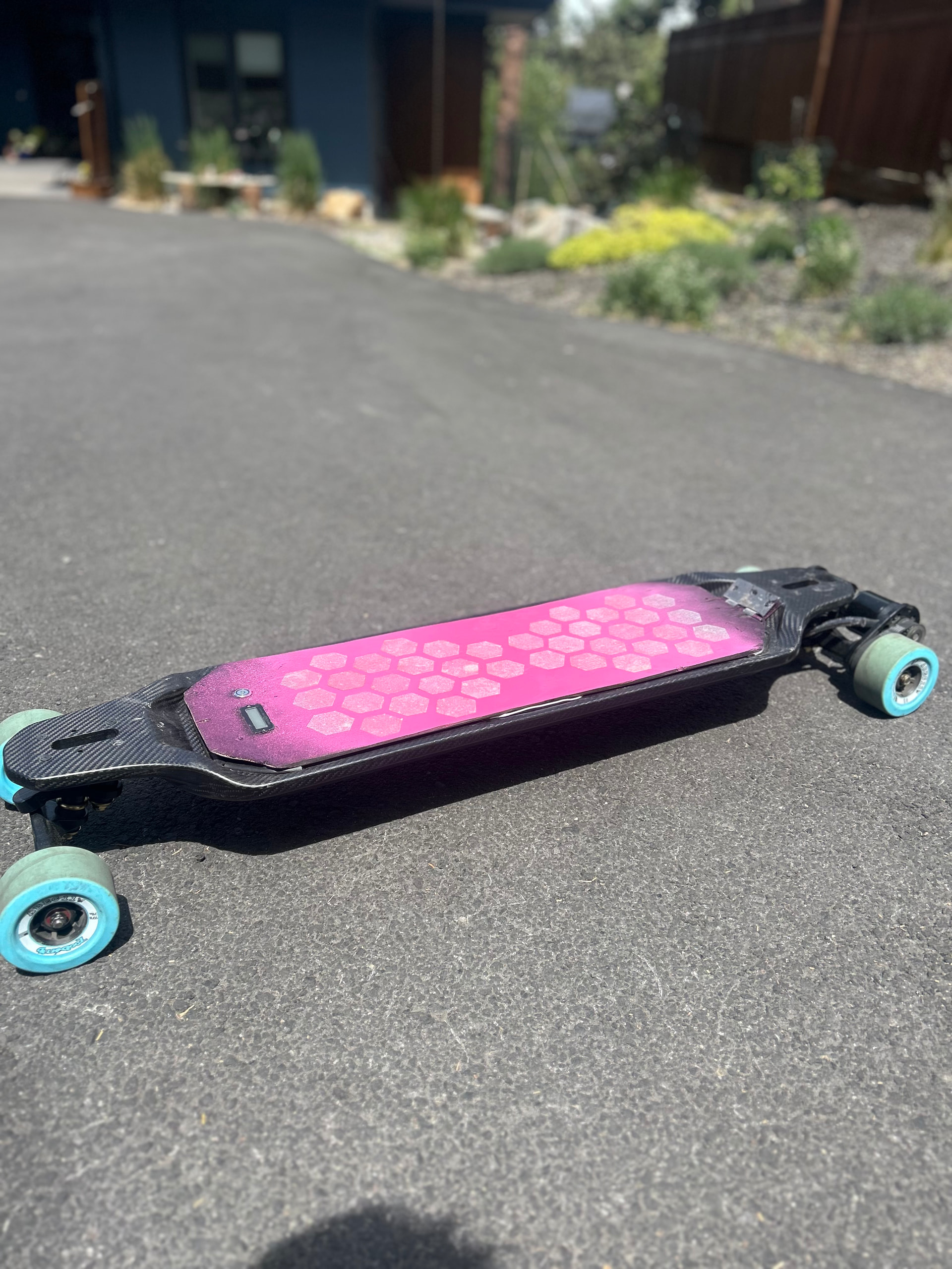

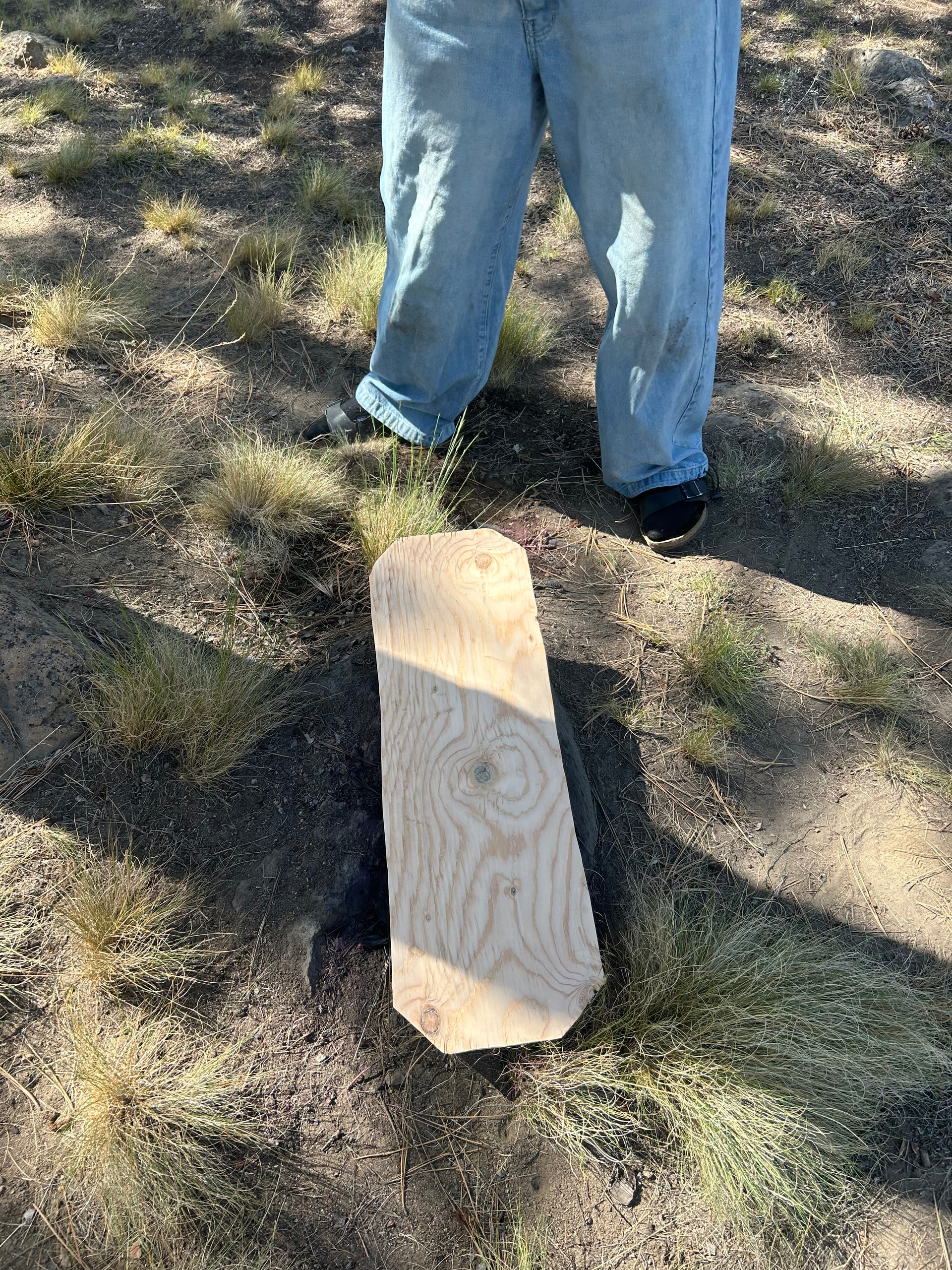

I made the top part of the enclosure with 3/4 in plywood and sanded in and carved it so it fit mostly flush on the board. I chose pink and black to paint it because I thought it would look sick faded into the carbon.

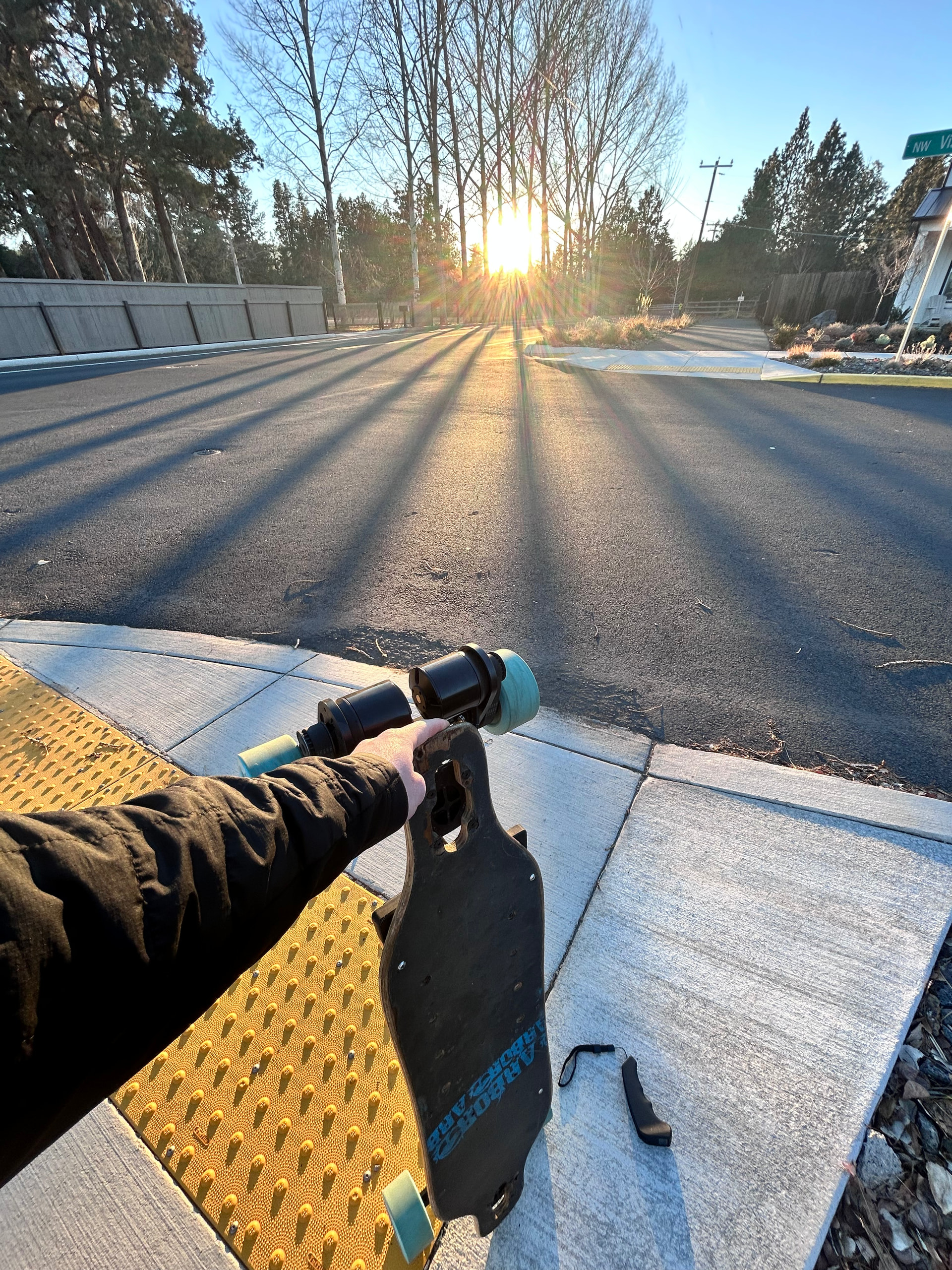

This is the old board.

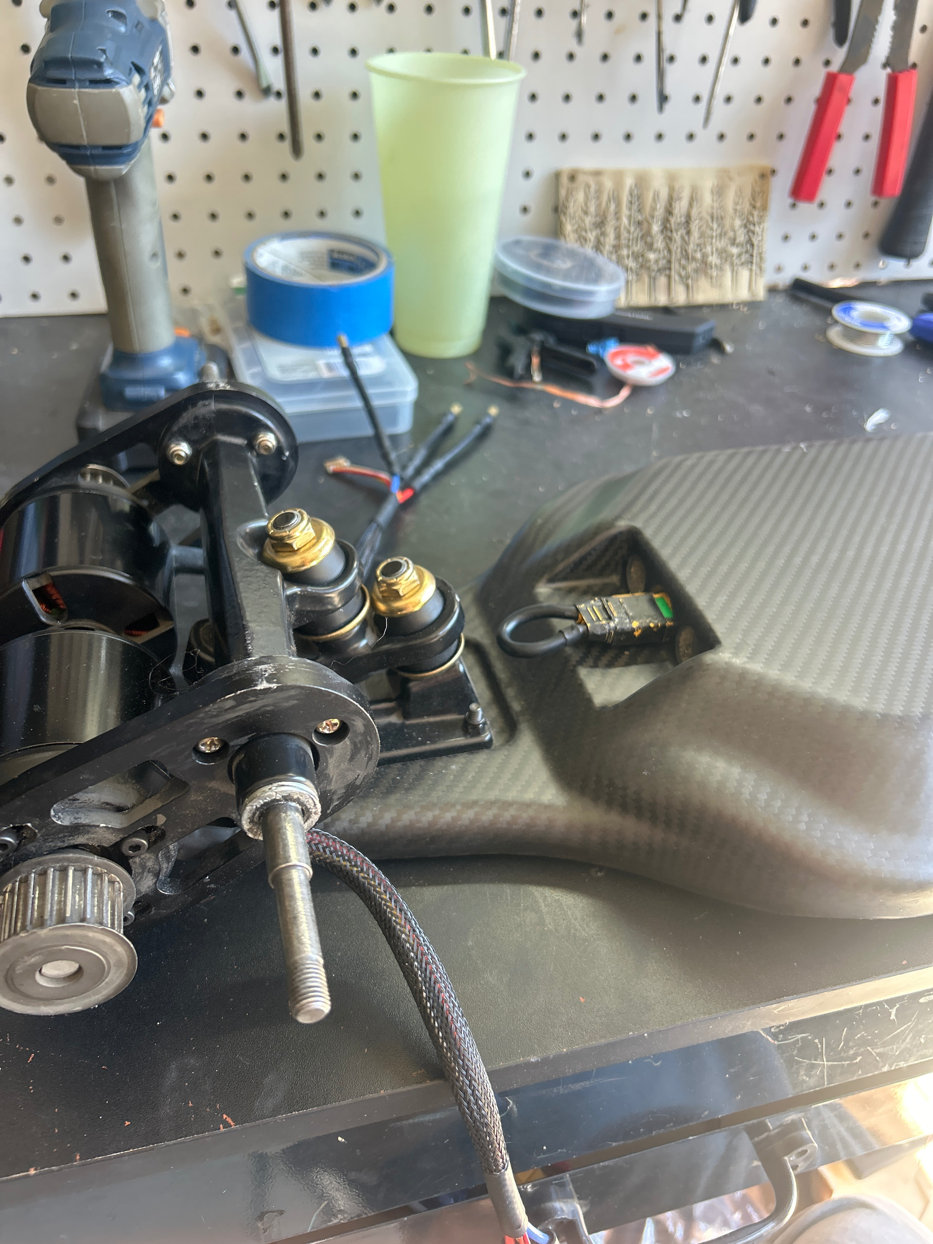

The new board parts and process
Metro board deck
Making the top deck
Metro board deck with top

I can’t ride till early July partly because I won’t have a battery till then and my mom also won’t let me but I’ve just pushed it around the neighborhood and it feels mostly fine. There’s no concave though…
Oh, gotcha. I am curious how a zero flex board will ride.

All the old metro boards had zero flex and this one’s gonna be the same. I would probably ask someone who’s ridden one before and see how they like it or ride someone’s metroboard.

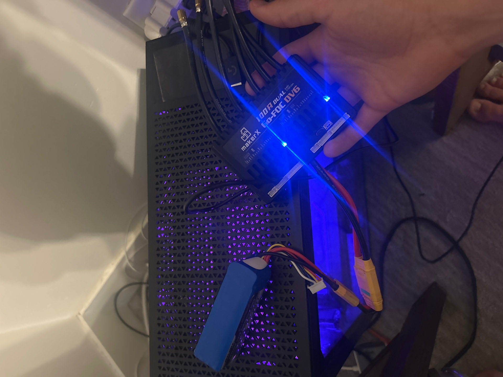

UPDATE! Pecos figured he couldn’t build me a safe battery so now I’m getting one from @AlexB. I also got a untested DV6 from @fearlesstvn (THANK YOU). I just tested the DV6 out it and actually powers on. I used an rc 4s lipo because I’m still waiting on my battery. I needed the new Vesc because I’ve heard bad things about the flipksky vescs on 12s (correct me if im wrong). now I’m just waiting for my order from ali to get bullet connectors and stuff to make a loopkey. i might end up soldering the vesc straight to the motors because I’m an inpatient bum. will update if I do so.
EDIT: i really have no clue what to do in vesc tool or how anything works. any help or tips would be great!

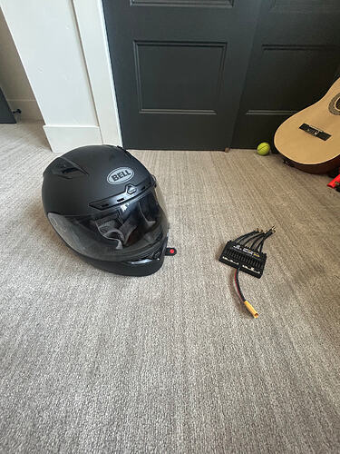

I also got a new helmet. Don’t wanna get my head smashed in when I do fall
. It’s the Bell Qualifier MIPS version.

Only problem right now is I can’t figure out how to use my vx2 for vesc 4 on vesc 6. I’ve read that you can switch rx and tx but that’s just not working. Another problem is under voltage right now. Don’t even have 20 volts to my motors with my current 4s rc battery.
IF ANYONE KNOW HOW TO FIX MY VX2 PROBLEM PLEASE HELP ME!
