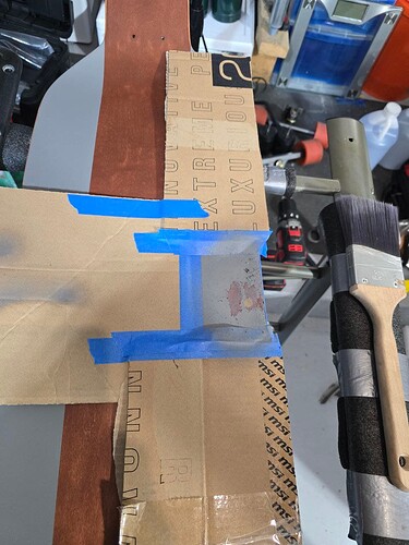

Deck arrived and it’s beautiful. As beautiful as it is, I wanted to change things up a bit.
I started by removing the grip tape. Next I started sanding off the (I’m guessing polyurethane) finish to prepare for staining. This was a PAIN. The finish clogged up the sand paper so quickly so I had to go through so much sand paper and use so much elbow grease. Orbital sander wasn’t working well due to the deck curves. I don’t think I got all the finish off in some spots and it shows in my stain.
Applied a Cognac brown stain. Did several coats til I got the darkness I liked. On went some painters tape and then painted the rails gray. On with the PU finish and the deck is done. I didn’t really care for the orange on the bottom, but it doesn’t really show anyway.

Time to install the inserts. I’ve had trouble with this process in the past but I wanted to give it another try. I started marking drill spots using the enclosure as a template. Then I used a shaft collar on the drill bit to drill deep enough for the inserts without drilling through the deck completely.
Things were going well until…
Shiver me timbers! The shaft collar slipped and I blew a hole in me deck.
Had to patch her up and paint/finish again.
Yo ho ho we are good to go.

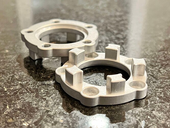

I wanted to use my Linn Power wide hubs with the 4GS, but they weren’t compatible without a custom adapter. Legend @AlexB designed and milled some for me. Amazing work, Bucko!
