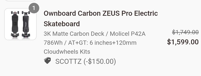

Thank you for that suggestion, will the p42a still get atleast 25 miles on a charge ? In modes 1 and 2?

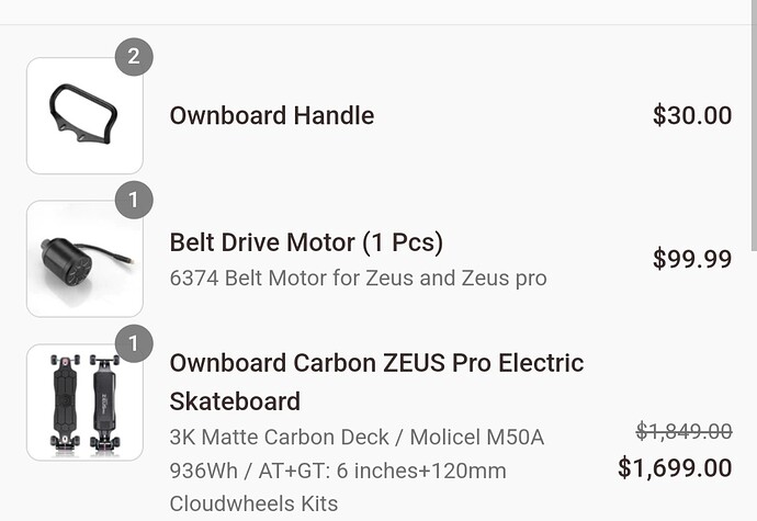

The board is on sale, plus my coupon gives me 150 off brings to 1699 :thinking:
I cant resist guys :open_mouth:
Should I get the extra motor for spare parts incase I break down? I already got the extra wheels
I would, but I’m a spares freak.

The P42A pack will easily do 25. I’ve owned a 12S4P board and that got around 25 miles pretty easily, so the zeus pro should get that handly, especially with the speeds you’re talking about.
I hope I made the right choice on the p42 option, all the videos were pushing m50 batteries.

But do we know if the esc is the same for both the M50A and the P42A? I’ve seen some people say it’s spec for the M50A on both.
It is indeed the same ESC between both. The settings are likely maxing out the M50 battery, while the P42A can comfortably deliver the power without breaking a sweat.
