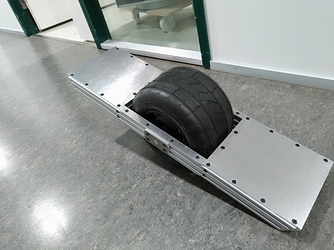

I also started building a onewheel.
Im worried that the rails can still turn a little bit individually because of play in the square hole of the steel adapter. Did you also have that problem and did it cause any trouble later on?
If the axle is the only thing keeping the rails fixed it’ll definitely flex, you’ll put quite some torque while maneuvering around on it. The shaft on the Phub is also very soft metal, I managed to noticeably squish it while tapping it with a hammer to extract the stator out.
Supporting the rails from multiple point worked out good for me
You could alternately use strong enough footpad material to prevent the rails from twisting. I went with both due to paranoia, the result is very rigid but heavy.

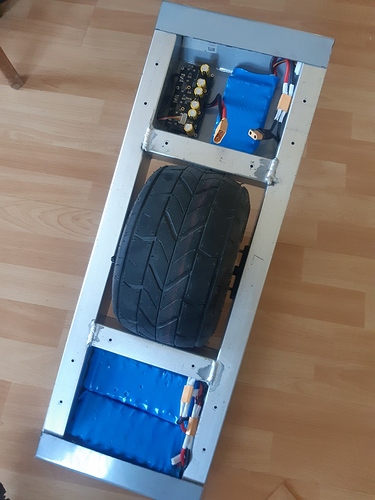

Got some updates on my build:
Now its fitting those 16s3p cells in there.
16s, wow! What controller will you use with it?
The a200s, it should be good up to 18s but i only have 48 cells, so 16s it will be.
That’s great, you can neatly sidestep the problems of the Phub just by increasing voltage, no need to open things up :grin: Your frame looks sturdy, no way that’ll flex too much.
Thanks Jopj!
Today i added some more stuff to the build and i realzed that im a fucking idiot. Prior to welding i forgot to pump up the tire. Now if i pump it over 7.5psi it rubs on the welded crossbar :frowning:
Other than that, i connected a 14s battery and tried to get the balance app running. I watched the video from @NuRxG and tried to configure the balance app. Its is reacting to the inputs from the imu but if i lean in a bit more it always changes to a dead state, no idea why.

Thanks, i put it on 1.00 and could ride around a little bit. There was still some trouble with the external IMU that crashed all the time and i had to cut the power and reconnect. This happend when there where a lot of amps flowing. Probably EMI issues because of the long cables and proximity to phase/battery wires.

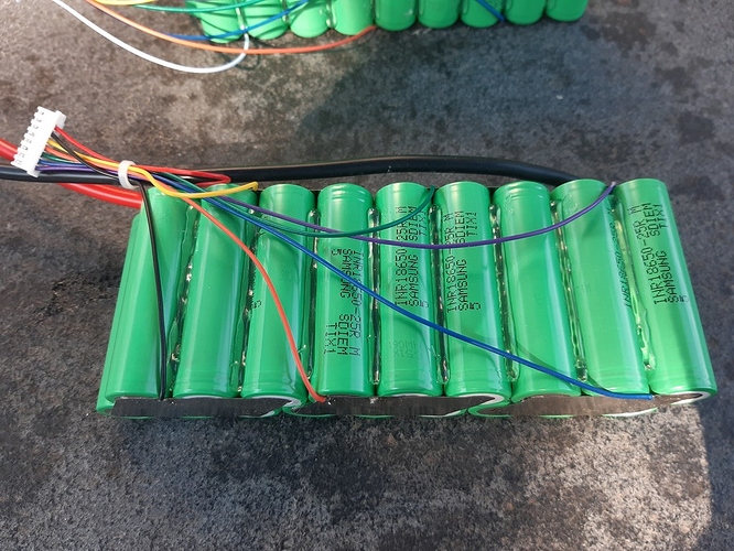

I also built the 16s battery and mostly finished the case but the project is now put on hold indefinitly (see last picture)
That sucks man, hope you are ok.
Did you bolt it straight to the frame on the bottom, could’ve shorted the FETS with vibration as there’s no heatsink. Also, where are your two other battery leads? I’m guessing you took them off for packaging reasons but that could have in theory affected things even though it shouldn’t.
Also, it looks like its a V2, some batches of the V2 have misprints on the silkscreen for the halls and the COM port, so that could be an issue.
Check your phase wires as I don’t see any grommets on the cut edges of holes
I have an unused AS200 v2.1 that fixed these issues, also with better caps etc that I may be selling soon since it doesn’t fit my project
Yes it was bolted to the frame bottom but with an aluminium bar and silicone pad in between. One of the high side FETs probably punched trough the pad to the aluminim and created a short. All the a200s screw holes are grounded so automaticly all the metal parts of the onewheel too :frowning:
