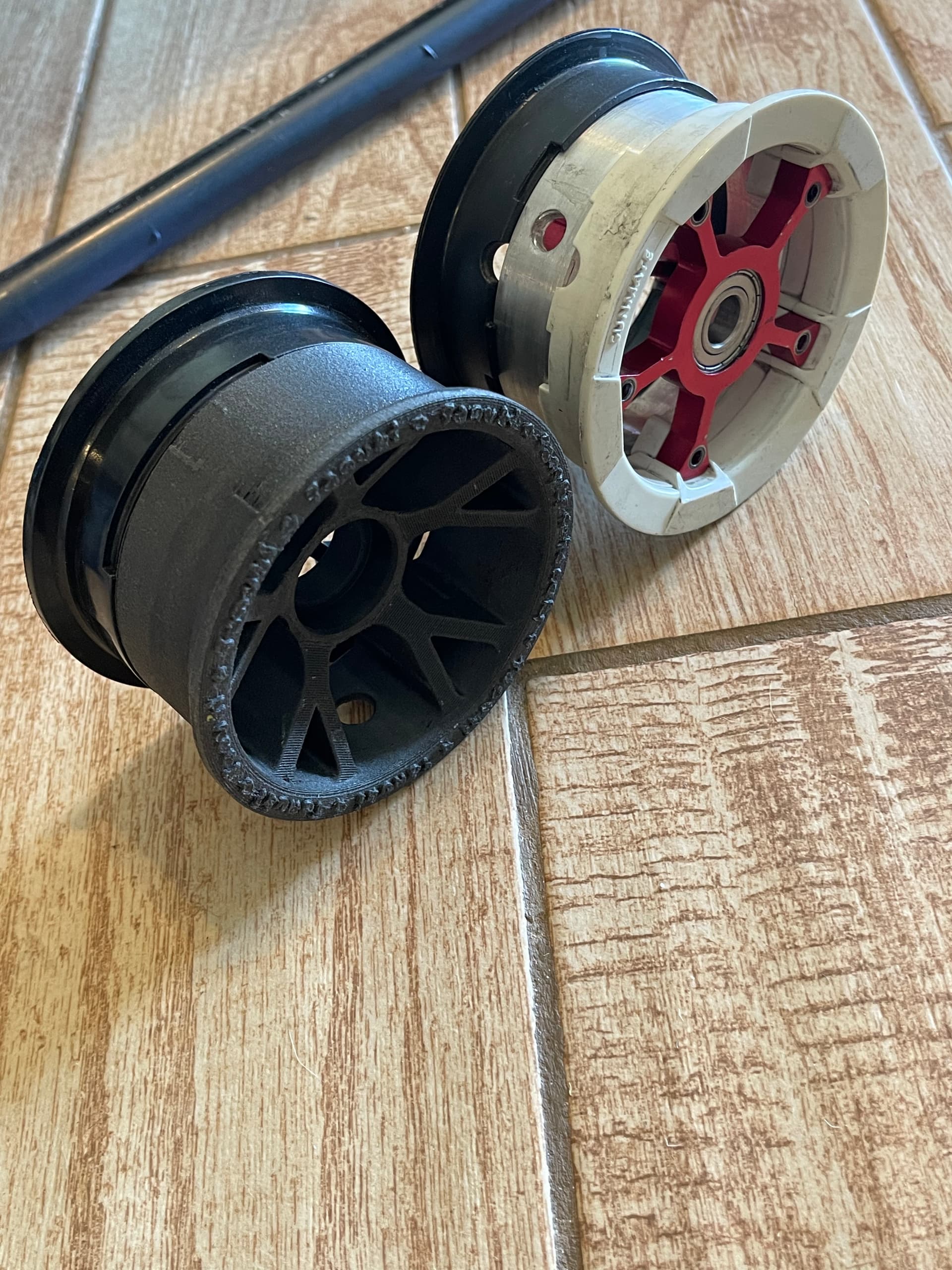

I’ve been thinking about a high voltage , 3link race build for awhile.
Got motors today (179 kv, 7490s).
Put things together. Spun tires.
I need to do some math when it comes to ESC’s.
I can do 12s with 30ah of lipos that fit tomibois enclosure perfectly or I can do 21s at 15ah if that won’t explode the makerx 100d.

Okay, not a one day build. I’ve been arranging tires around.
175s stretch ok. They look like a balloon kinda. The 155s from metro boards are I deal, but they no longer exist.
I discovered that you can take half a trampa hub and a 3d printer tenuki hub and make a reasonable stretched hub with offset, unlike the SRB hub the with aluminum spacer.
Those zeee packs fit too perfectly in the tomiboi enclosure wells for me to ignore it. That’s how I get to 21s in serial or 12s with a parallel group.
Those motors are so damn big. It’s 5.2 kg of motor vs the little emtb with 1.9 kg next to it.
Long board is loooooooooong.
I’m pretty keen to buy another “esk8 news” universal heat sink off anyone.
different teeth/size pulley front vs rear? How does that work together?
2WD at a time, one direction for speed, other direction for torque
Symmetry is key. But if you stop to wait for all the parts to look pretty, well…

How’s your clearance looking with the 175 tires?
Arzamenable:
And here I thought you were going for a board that could switched for speed to torque at a moments notice
About half a gt2b.
Wheel bite is my next obstacle
dskate
October 8, 2022, 12:05am
#15
You thinking shaving the deck or extending the front?
Extension first. I would not like to cut in to this board.
