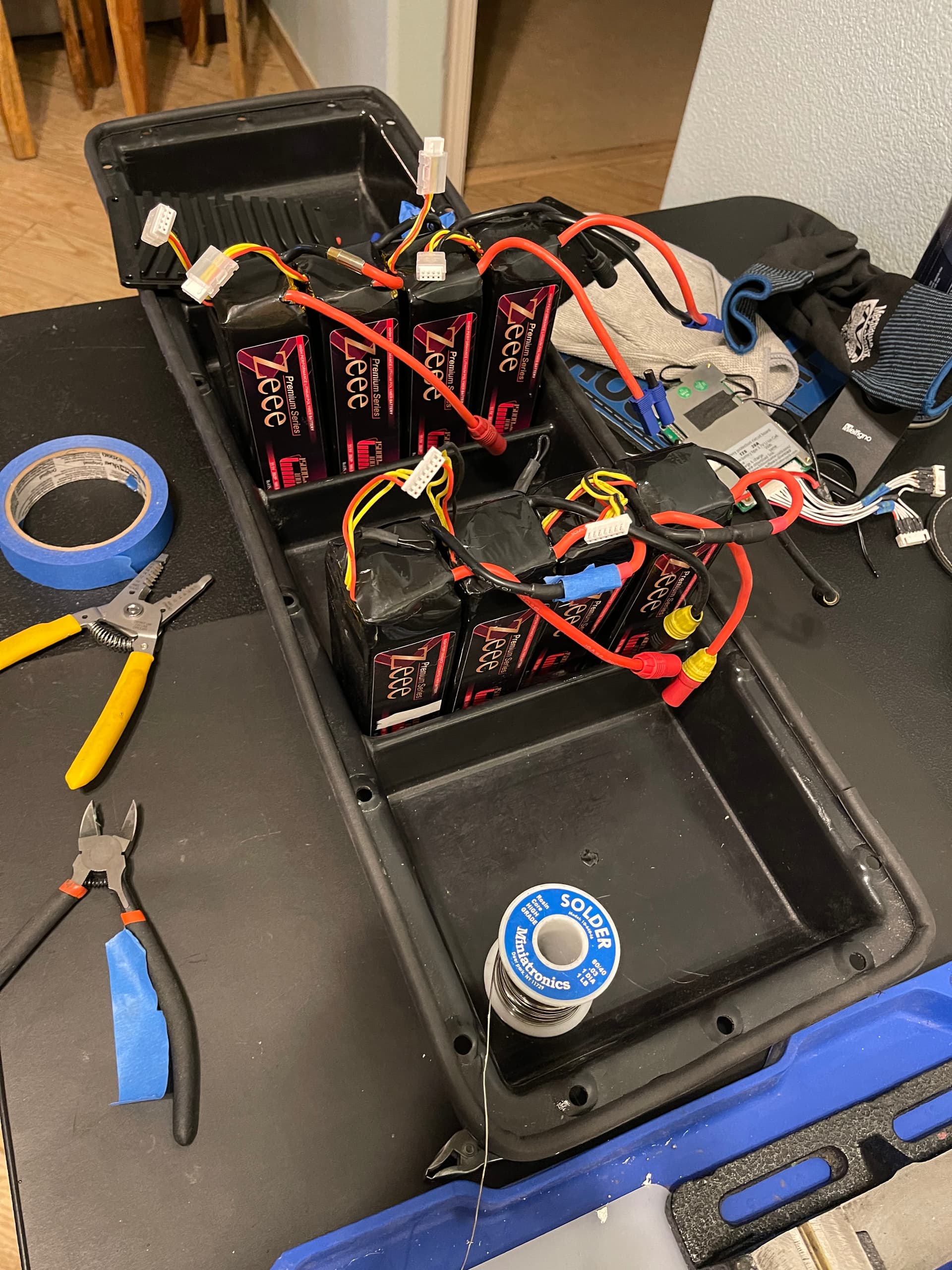

One day build, model 2. Odashi 44/ 3 links/ tanuki printed hubs/ lipos 12s-21s/ makerx escs TbD

All 8, 3s packs fit perfectly if you massage the shrink wrap. @tomiboi

I have half the lipos, motors, and esc’s installed, taking up half the enclosure.
Wheel bite is significant. I also snapped off a usb c port on a unity. I wanted to cry.
I rode it around the block, carefully.
Still looking for a matching heat sink for the front.
Worst case, I’ll grab an mboards sink, unless someone knows of a source for a esk8.news universal sink or one with similar dimensions.

Clearance is fine. Smaller 165mm pneumatic tires, stretched even, bite the deck. I guess I get make an offset hardware plate to set the trucks farther out.

It going to be really, really heavy if 4wd. 50lbs plus.
30ah of 12s lipos, large heat sinks, longer board, printed hubs are pretty heavy compared to mbs hubs. And there are the larger motors.
I’m going to get it buttoned up and tuned with gearing for 2wd and slowly work toward 4wd.

My plan is to use a front extension to get the tire clearance also. My deck ships this weeks so I’ll be able to start figuring that out once it’s here.
I’ll probably mock it up with a simple piece of aluminum or wood to figure out the distance needed and then I may have a piece CNCd or even made by send cut send for it.
Have you found an extension or are you making one?
Gonna make one. I think with slightly wider axles, offset hubs, the extension should not be excessively long. Or hang off the rear of the deck.
Oh thats cool. Thinking of extending the axels? Only ones I know of are the etoxx extensions or is there another option?
On the Odashi I trimmed down the shoulders and hips a bit on the most current version to reduce wheel-bite. With 3-links that deck is probably awful. It’s the old version. You’ll most likely need extensions to get good turning.
