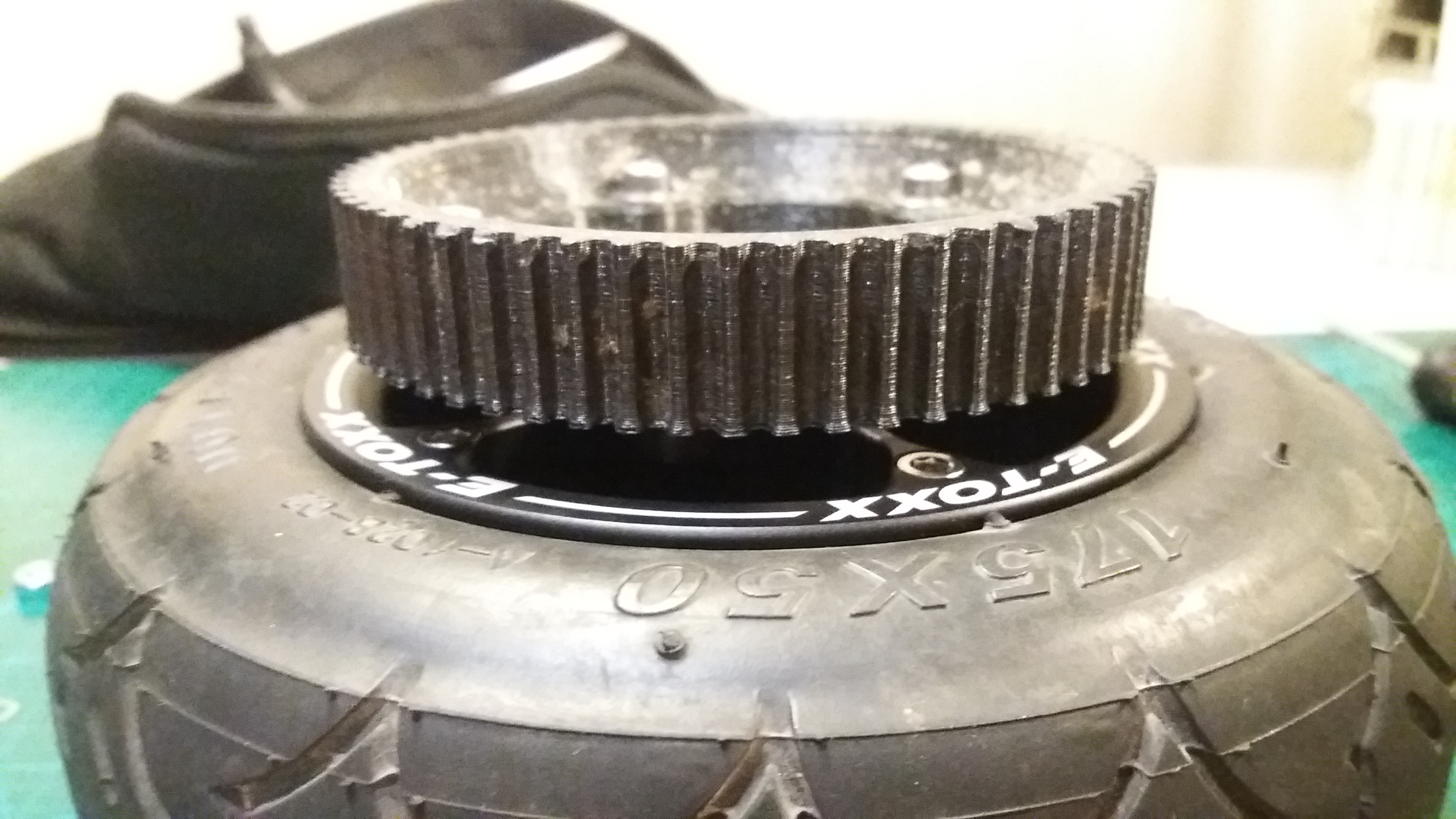

I would say yes it fits, do you have pics of the wheel pulley? I see there is a bearing, are the mounting holes of the pulley threaded or not?
You use Rockstar II hubs so the outer bearing distance is 38mm and that’s the space you have.
E-Toxx: 24mm (outer bearing distance) + 1mm (hub flange) + 6,25mm hub adapter = 31,25mm

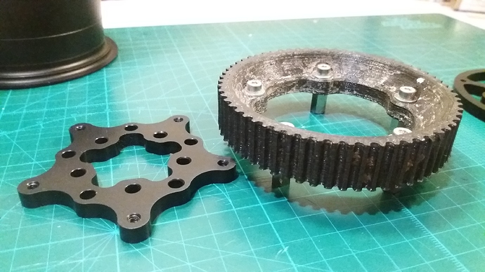

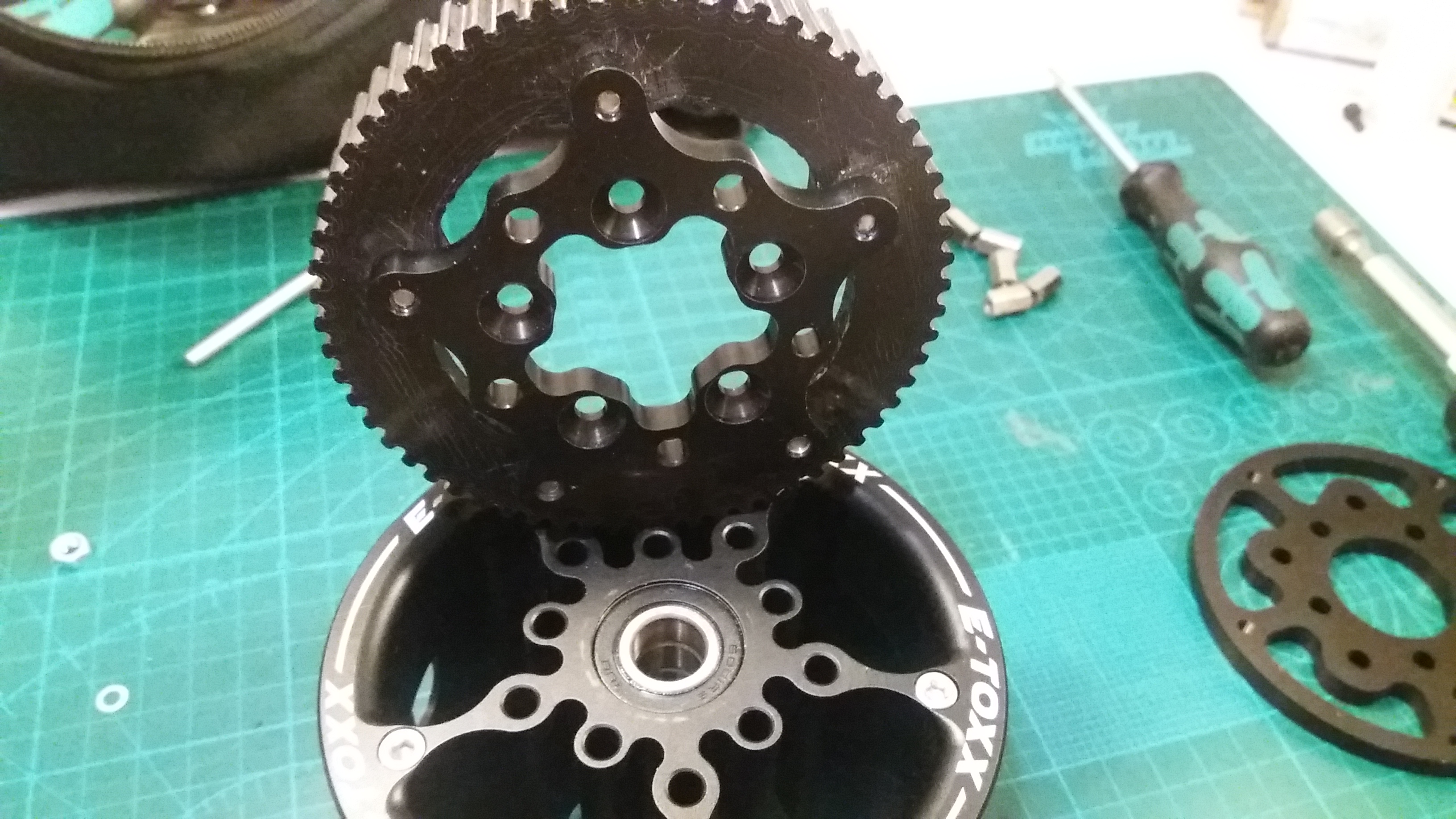

There are different ways to mount the hub adapters, here both sides.
I only have Trampa pulleys so here for example with 62T pulley
Pulley bolted to the threaded holes of the hub adapter
Now I would use sockethead bolts and lock nuts on the hub adapter on the pulley side
The distance of the pulley could be adjusted with washers between hub adapter and pulley.
If like in your case the hole of the pulley is not that big you have to use washers for sure. But you have still 6,75mm space left on your axle so that should be possible.
It’s also possible to use the inner bolt pattern of the hubs and mount the bolts in reverse if needed.

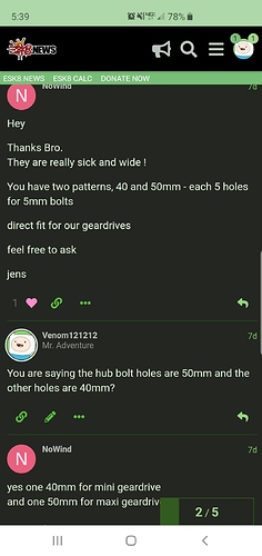

@rich i still don’t get it.

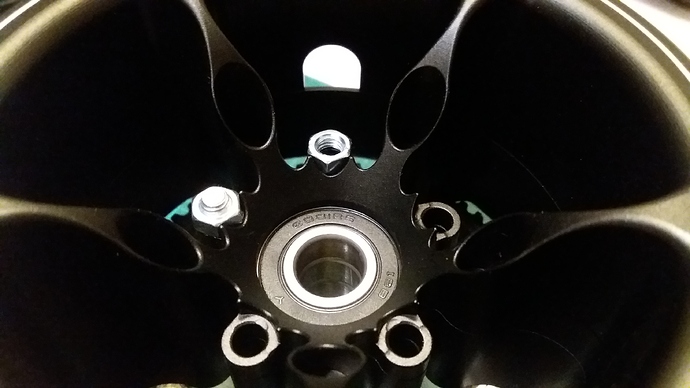

People wrote the hubs have mbs bolt pattern as well. I can’t see that on the etoxx hubs, but might be just me not realizing the real size of the hub.
Is this mbs hub bolt pattern?
It’s a couple hundred dollars on the line if they don’t work well for my application, so trying to be safe rather than sorry.

The 10 circles in the middle of the hub:
  • 5 are spaced at 50mm diameter around axle (trampa)
  • 5 are spaced at 40mm diameter around axle (mbs)
Both 5mm bolt sized holes

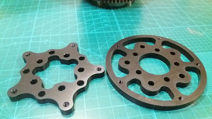

That’s wrong info, you only get MBS bolt pattern with the additional MBS hub adapter and Trampa bolt pattern with Trampa hub adapter. The hub adapters were made to mount superstar or rockstar II hubs to E-toxx gears but they could be used the other way, too.
No, it’s bigger. But even if it would be the same, you couldn’t use it because there are threaded holes inside the second (outer) part of the hub, there are no nuts or bolts visible like on all the other hubs out there :grin:.
Just for clarification:
axle center to hole center distance for the bolts which hold the hub together: 44mm
axle center to hole center distance (5 outer hub holes in the middle): 25mm (for 50T E-toxx maxi drive)
axle center to hole center distance (5 inner hub holes in the middle): 20mm (for 40T E-toxx mini drive)

This is what jens told me to make me think otherwise.
So he’s referring to bolt pattern diameter, not from axle?
Basically he is writing the same as me but he is talking about diameter and me about radius (center to center distance) but both is correct and referring to the axle (or center of hub). I wasn’t sure what’s the common standard way to state bolt patterns, but diameter could be common, sorry for confusion.
