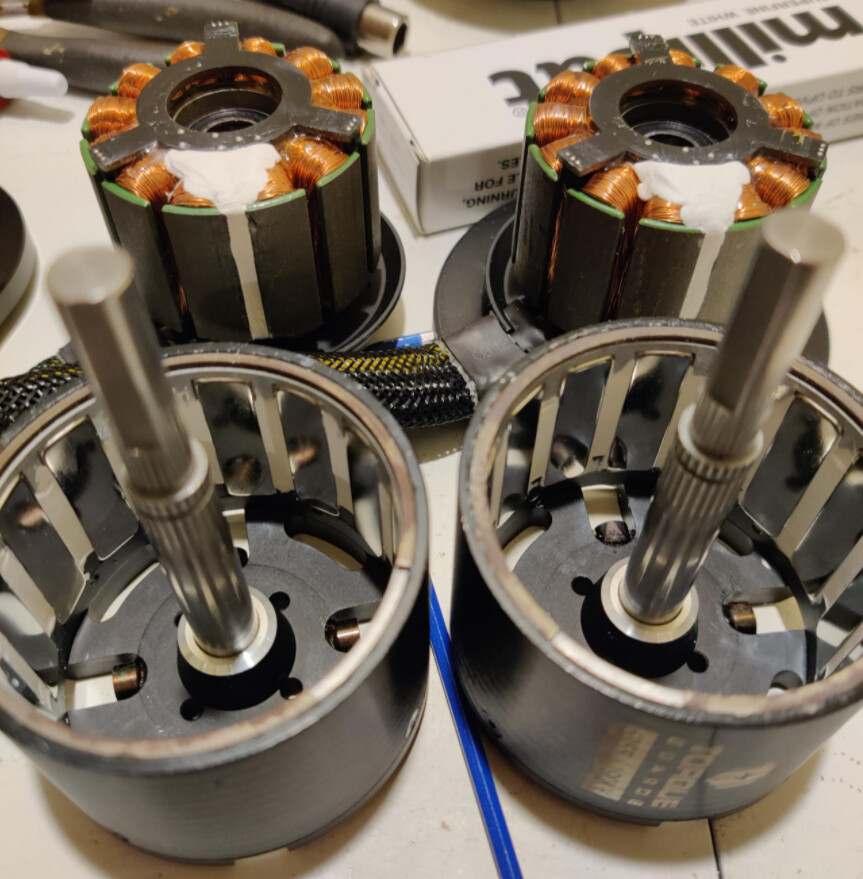

Motors
Just battle hardened them with milliput. I’m going to replace the connectors with mr60s.
