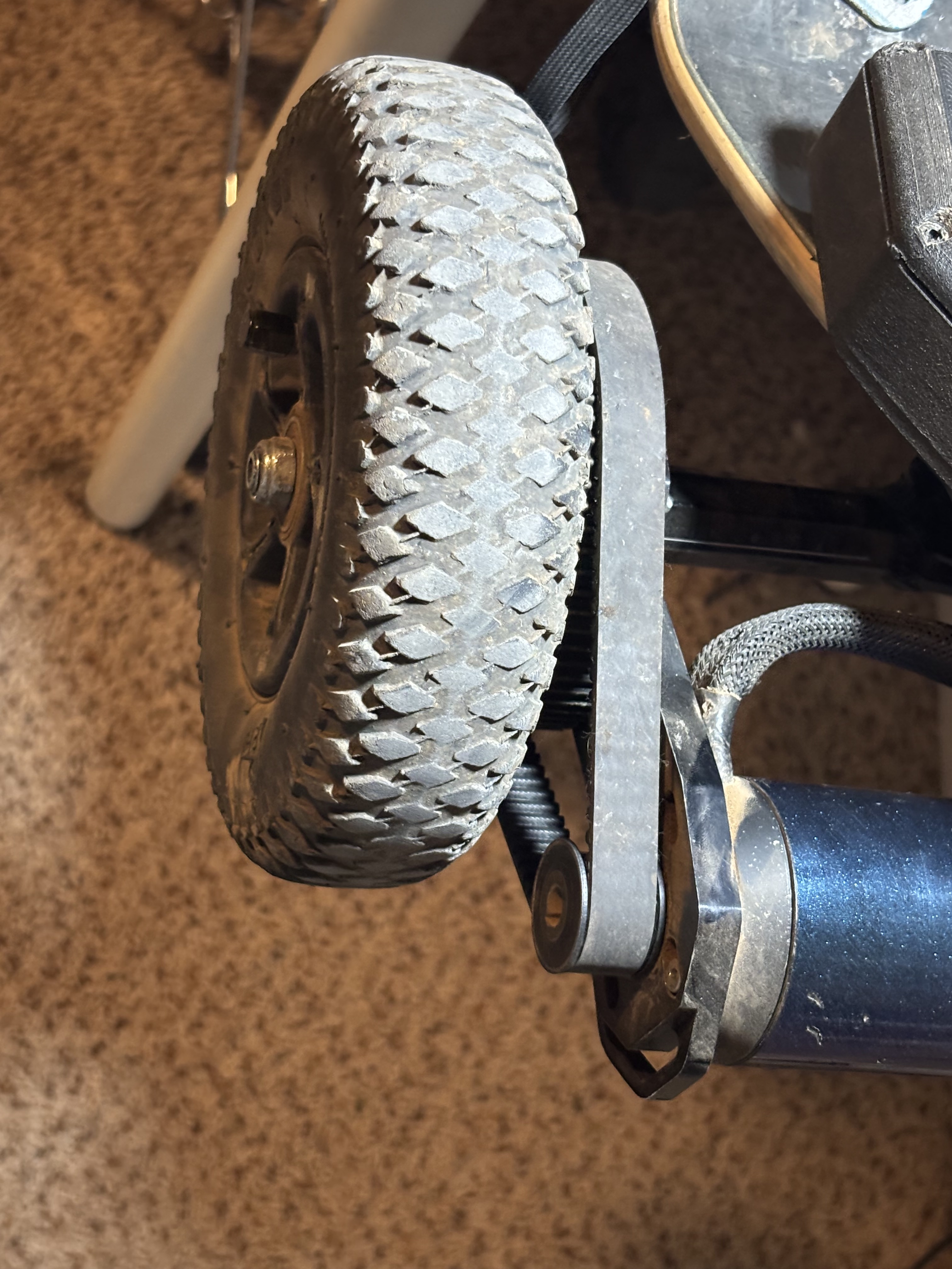

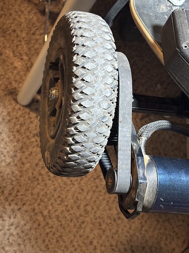

Why is the tread wearing off so fast :cry::melting_face:
Depends on tires tbh, some tires their knobs look pretty big but they wear off super quick. And some tires like the Kendas looks like they’re not gonna last long but they usually last a long time.
Can anybody recommend good off-road 200x50 tires?
