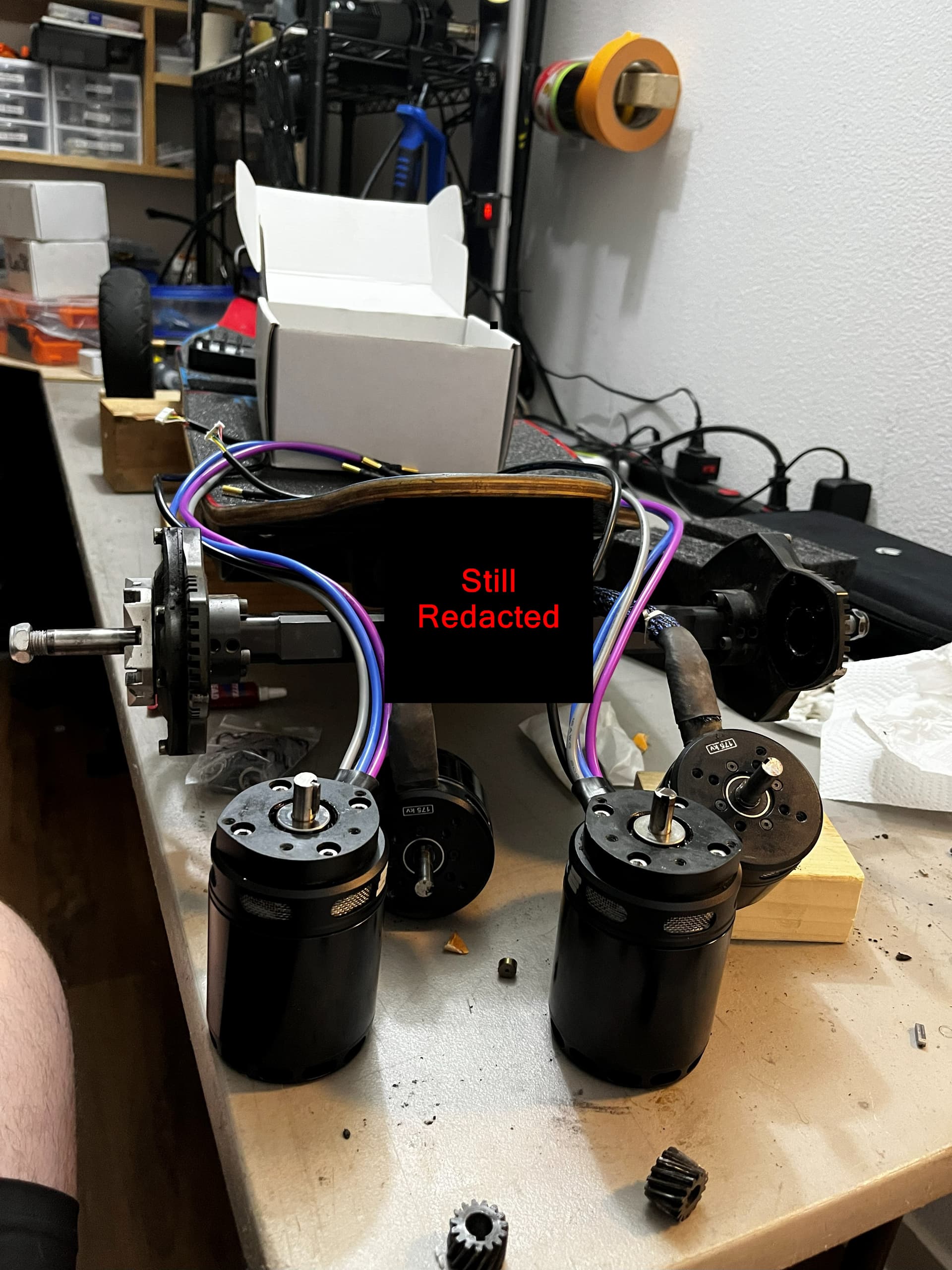

Drive Reassembly
Drivetrain config
I have both sets of motor pinions for the jump drives, 5.5 and 4.4.
Nothing Fancy does NOT need to go 60mph lmao. Easy choice, sticking with 5.5 it is.
Inspecting the motor pinions, they’ve defininity accumulated wear over the past thousands of miles. Plenty more life in them though
Green has come out, no turning back now. Probably should’ve checked that I cut the shafts short enough to fit in the drives before I did this.
I took this as an opportunity to re-pack the drives with new grease. Check out new grease, next to the old stuff
weeeeeeeeeee
after 6 hours of work, the drives closed up with new motors and grease. Flawless reassembly.

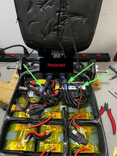

Opening her up to re-wire the D100s
And disconnecting the motors from the D100s.
First time the deck has been free from the enclosure since I built her a year ago. Feels longer!

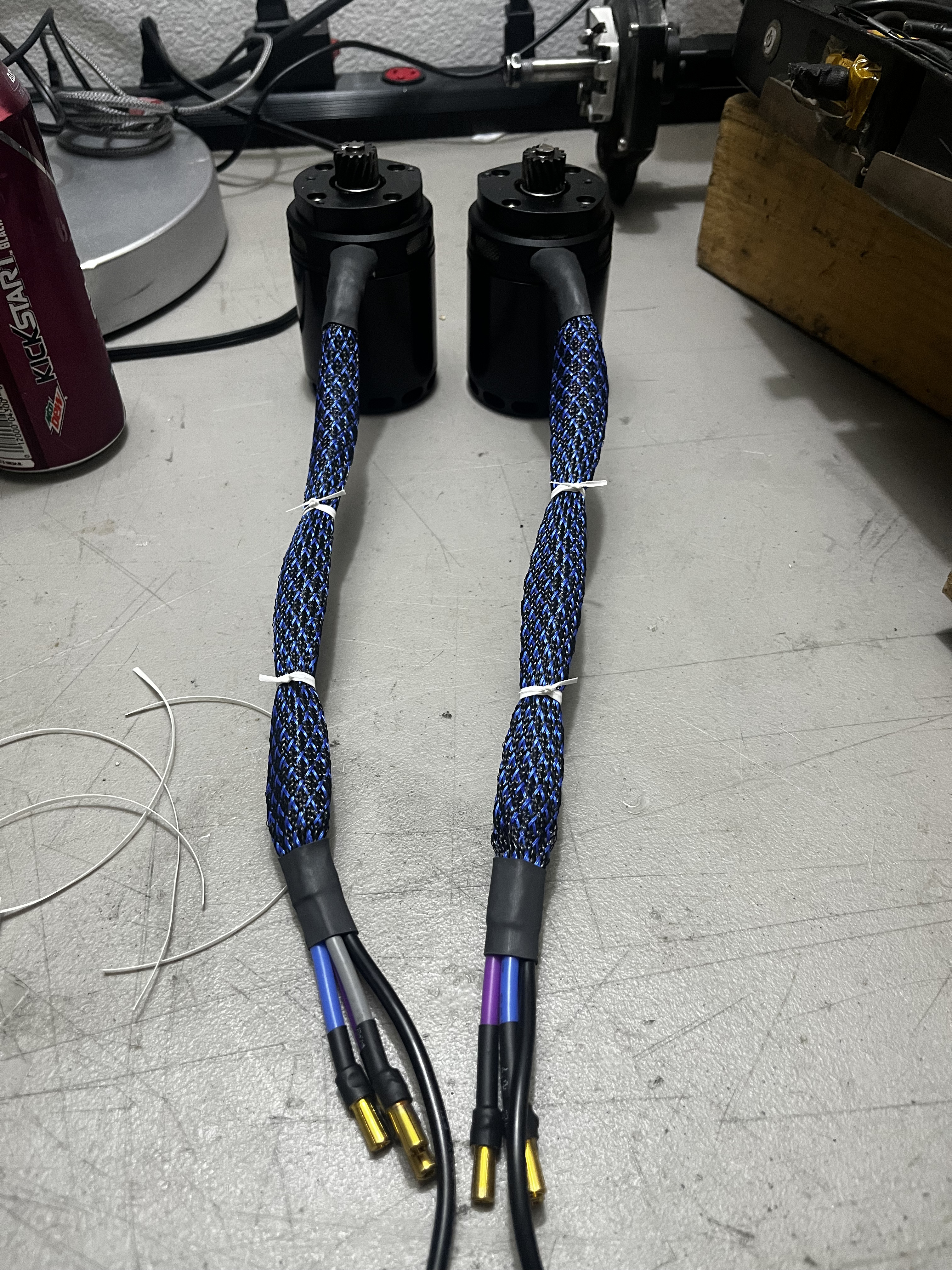

Had to chop the new motor’s phase wires and solder new connectors.
Did these need to be 5.5mm bullets? Definitely not.
Was it what I had already soldered onto the D100s? I plea the 5th.
Because I love crosslinking
Show us ya joints! - #122 by tuckjohn
Added hot glue to misc JST (should’ve done this before)
I wanted to add some cosmetic blue overbraid to the phase wires. Love the colors @Skyart, but I prefer blue :smiling_face_with_three_hearts:
Tried something different this time- before heatshrinking the ends, I put a ring of hot glue under the overbraid. When I heat the heatshink, this re-melts, and is squeezed by the heatshink into the overbraid. Hopefully this prevents the overbraid from sliding out of the heatshrink over time(which is happening
on Ankle Wreacher). I’m pretty optimistic.
Add wiretie, looking good.
Heatshrink the other side
And the two halves have been remated
Do some programming, and we’ve got some wheels spinning babbbyyyyy
80a motor. Was running 90A on the old apex motors
Did some misc cable management, taped the bullets to prevent them from coming apart, —

Anyone going to esk8con with a bluetooth module… HIGHLY recommend you disconnect it for the weekend if it’s not password protected. Only takes one person mistakenly connecting to your board and messing with your settings to ruin your weekend. I’ve seen it happen before.
If nothing else… go into your vesc app and check the “preferred” toggle. Will help prevent you from doing that to someone else’s board when you’re surrounded by 100s of vesc bluetooth modules :slight_smile:
Do it or Huey disapproves
Almost forgot to remove mine
(also it’s redundant because of the new Megan)
–and sealed her up. Ready for the con! Woot Woot.

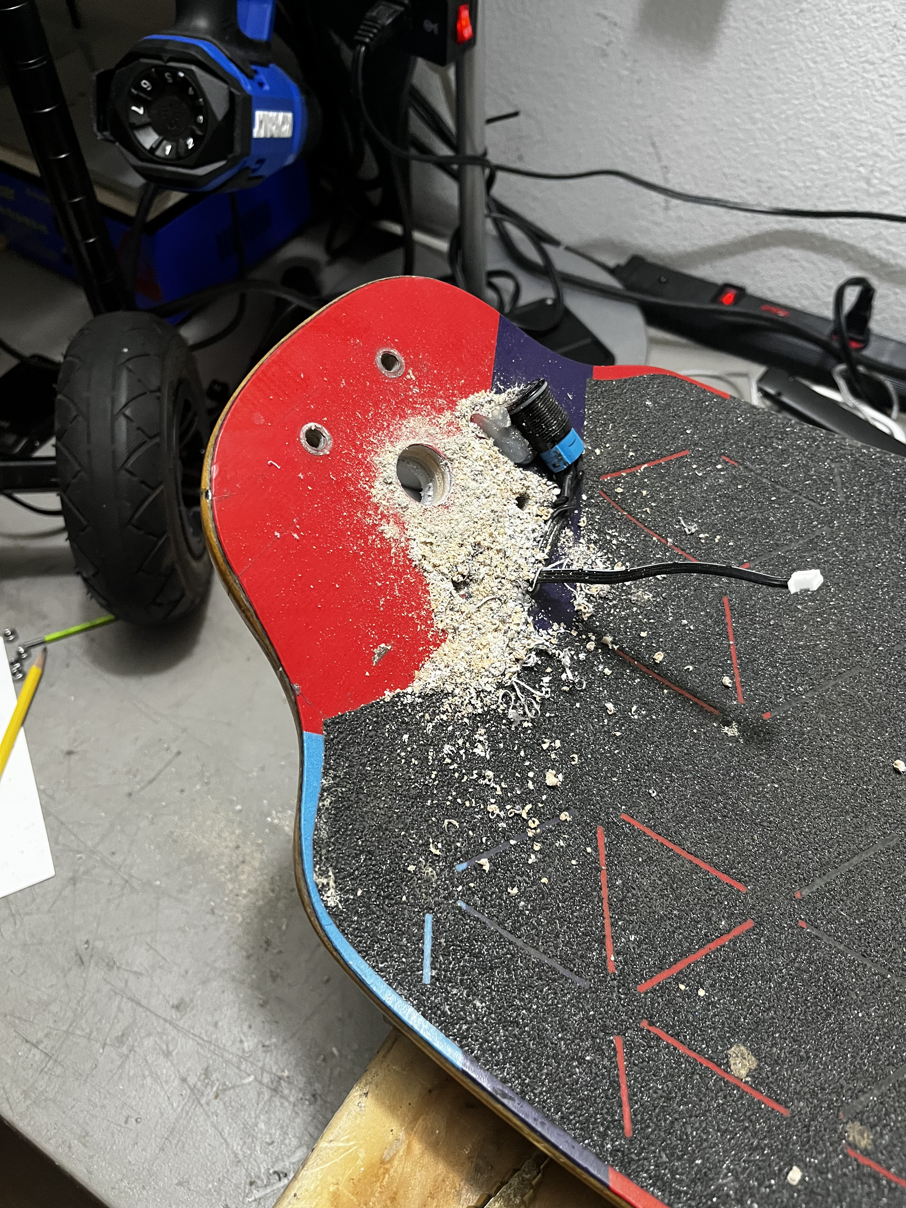

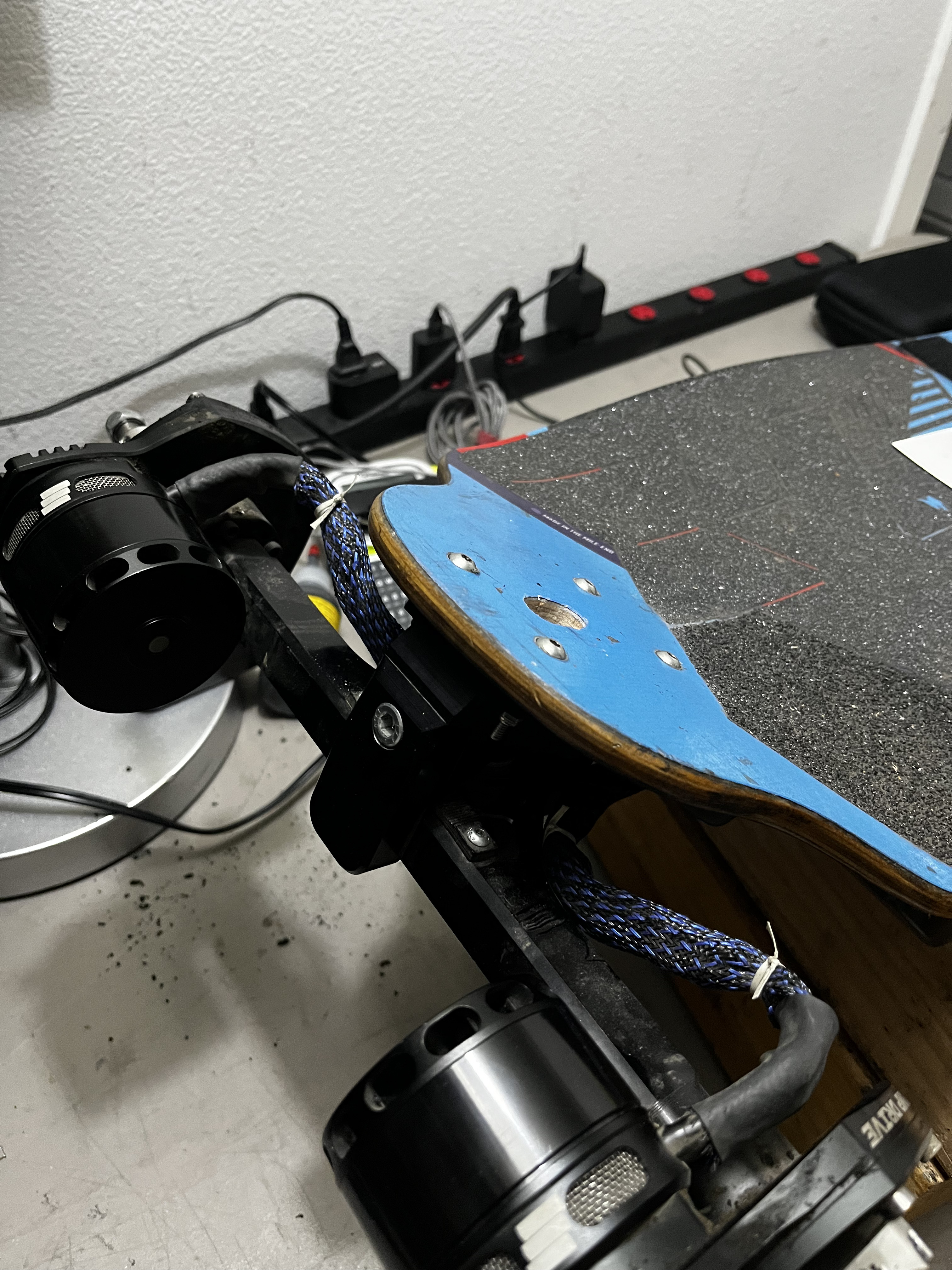

Queenpin Holes

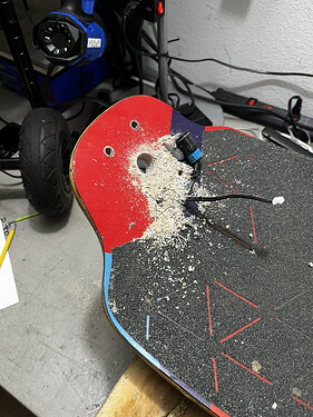

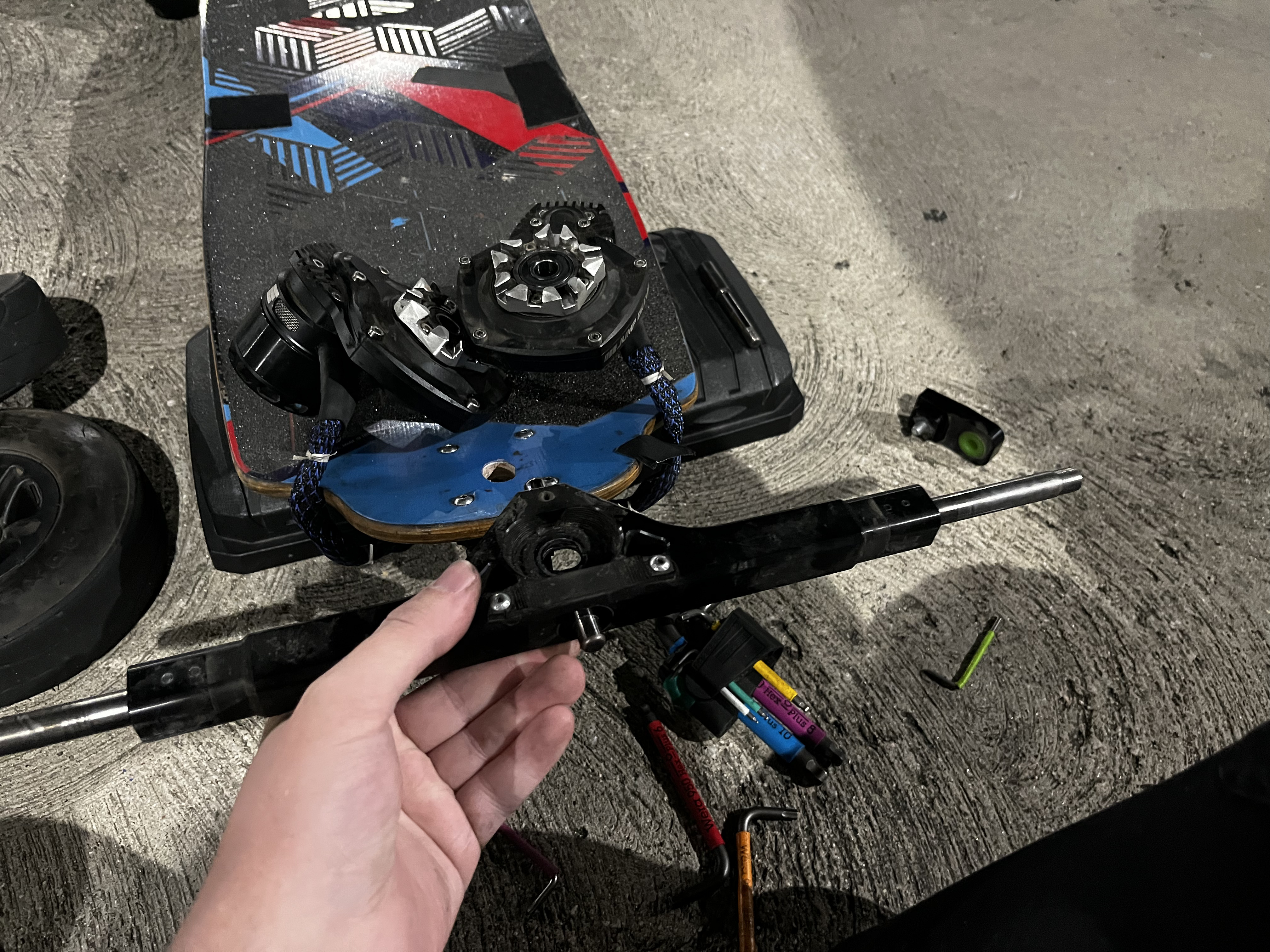

For those that don’t have duality trucks, changing both bushings requires pulling the queenpin up through the truck baseplate. So I could swap bushings easier, I drilled a hole through the deck in the front and rear. This lines up with the queenpin, so I’m able to remove it to change bushings without needing to remove the trucks from the deck.
Louie likes the plan

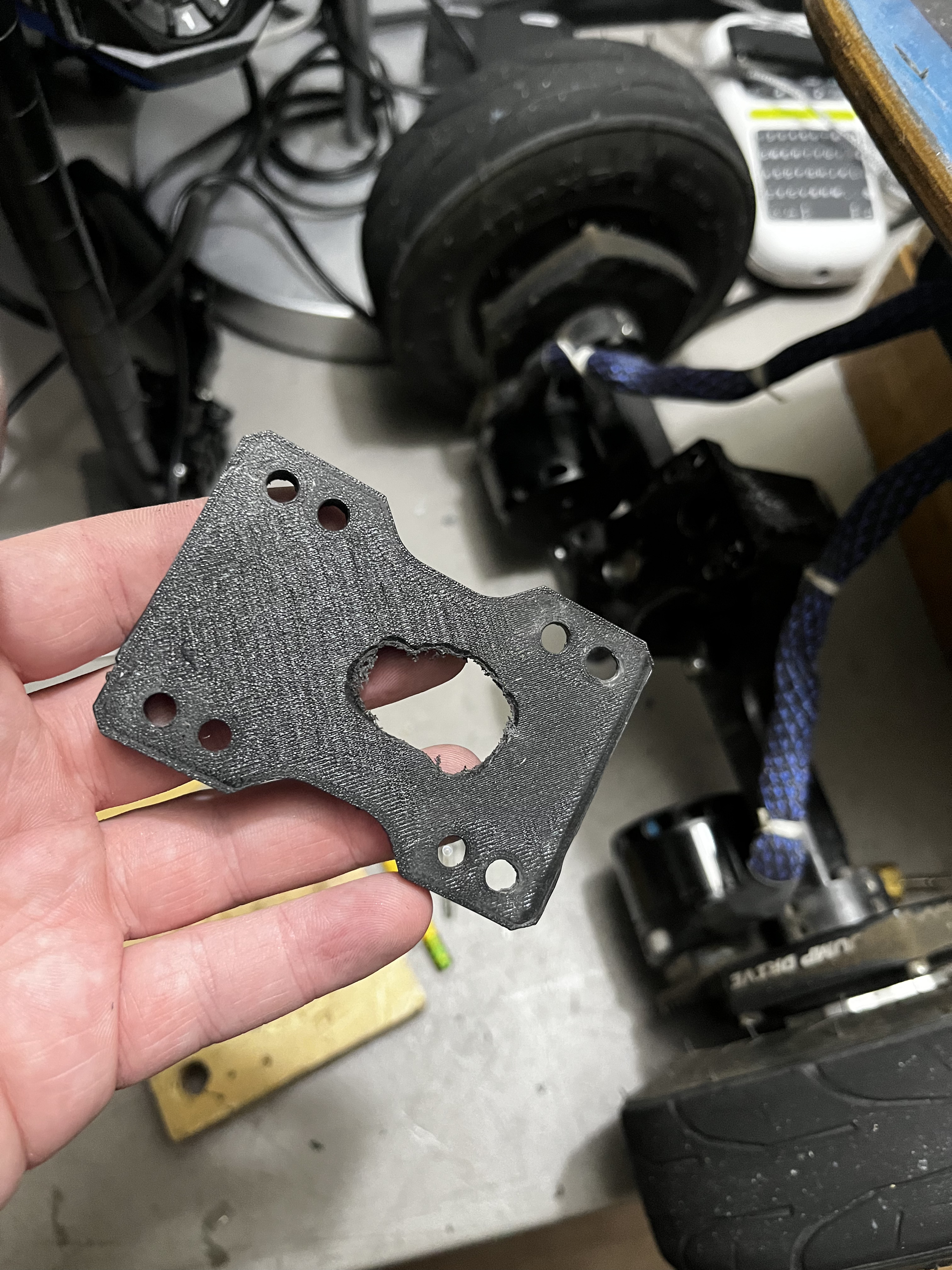

In the rear, I had to take a drill bit to the 3D printed 5 degree wedge plate. Not pretty, but it works.
[REDACTED]
The queenpin holes were very useful when playing with REDACTED at an i2g night which involved removing the gear drives from the hanger

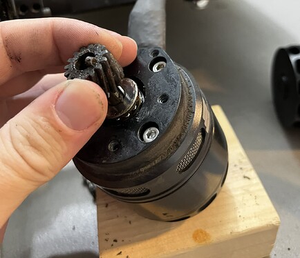

Removing 6455s

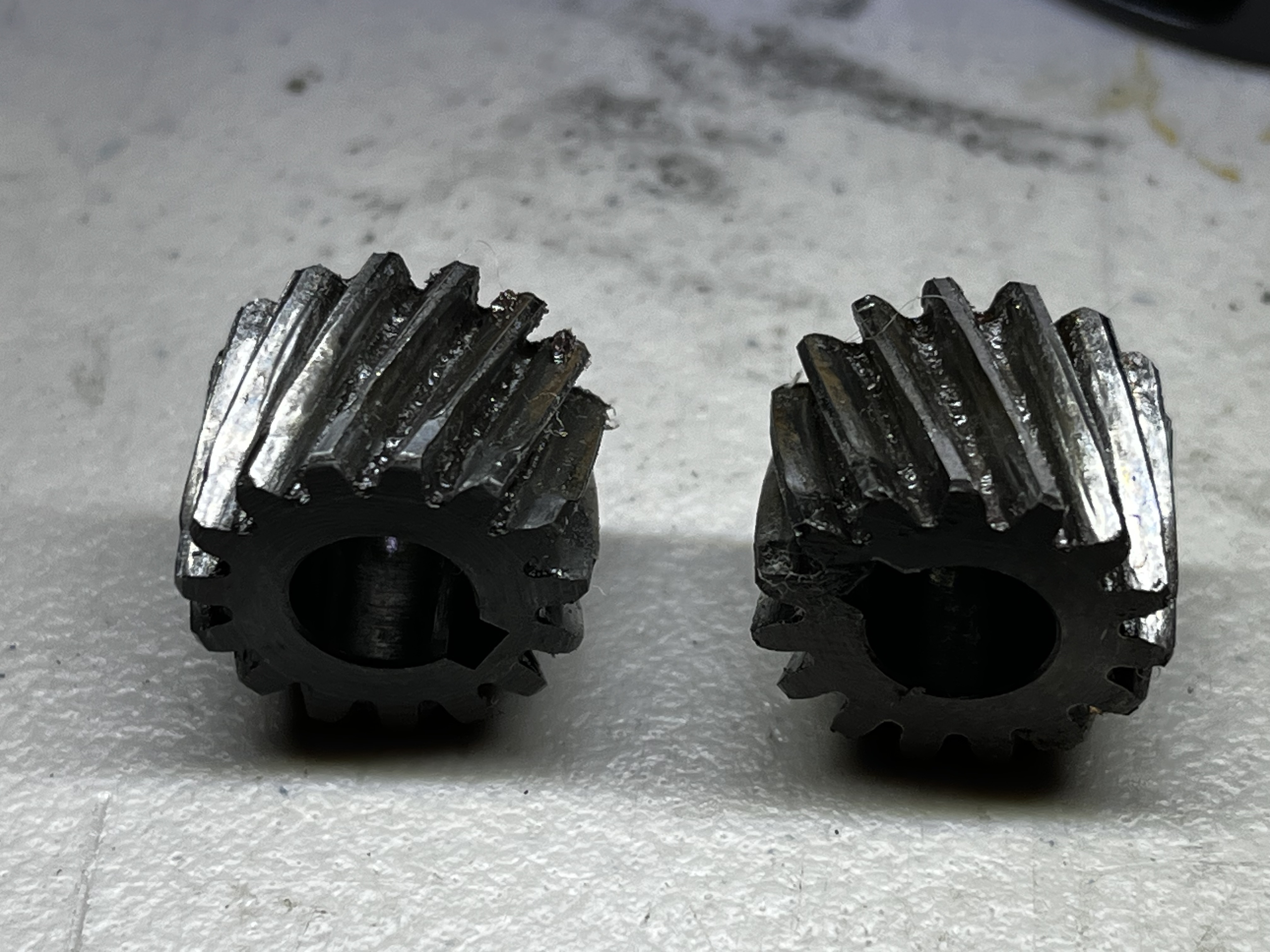

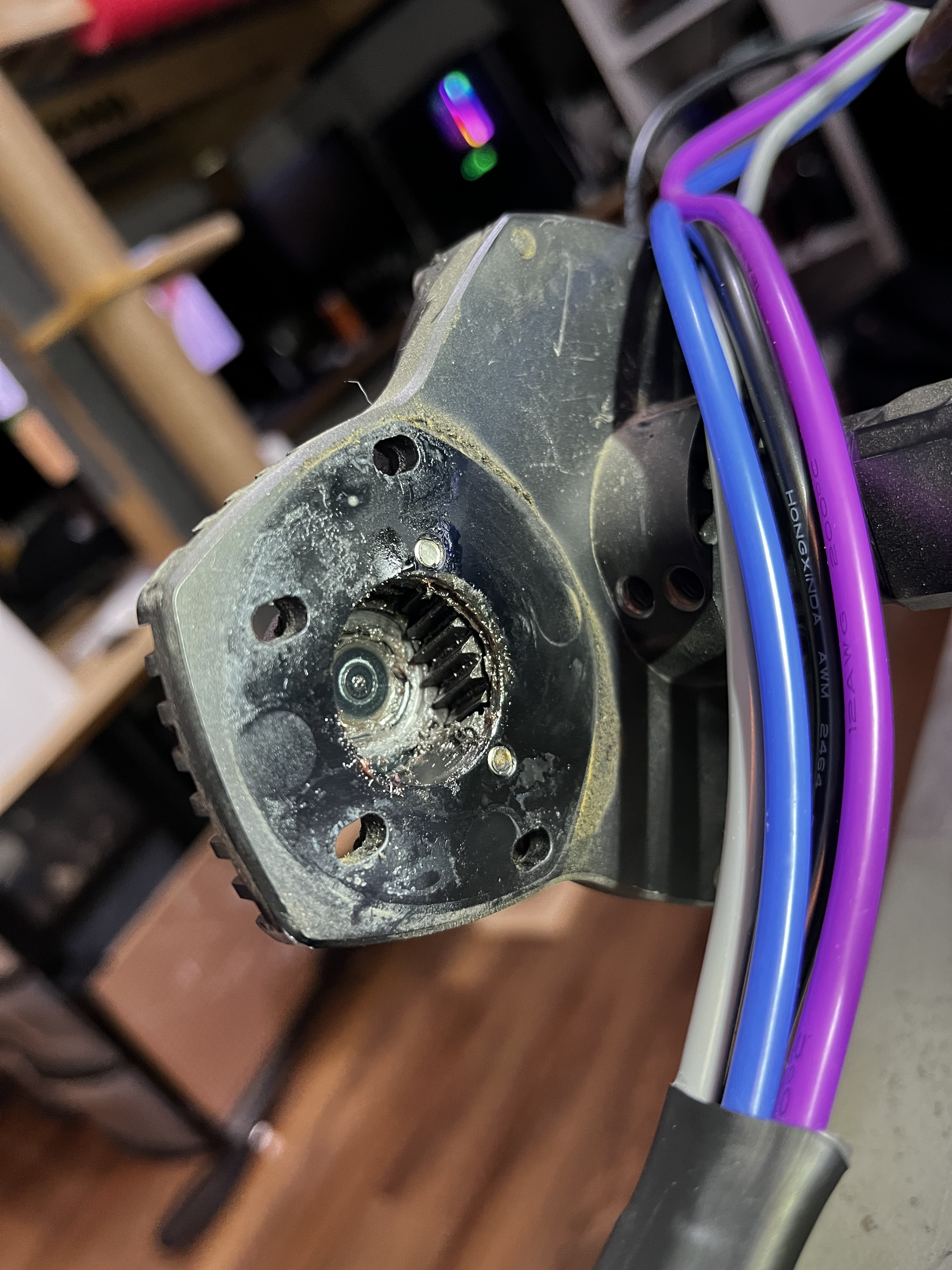

So… the locktight didn’t hold. both pinions slid right off, no heat needed. Guess that’s helical for you..
Looking inside the drives, there is visible wear where the pinion was rubbing on the inside of the casing. (Interesting, this wear only exists on the left side, the right seems fine).
I think this explains the braking cutouts…The pinions are pushed outward into the casing, locking up, causing a vesc fault, which would then releases the brakes.
The pinions are definitely starting to show their wear, but should have some life left in them.

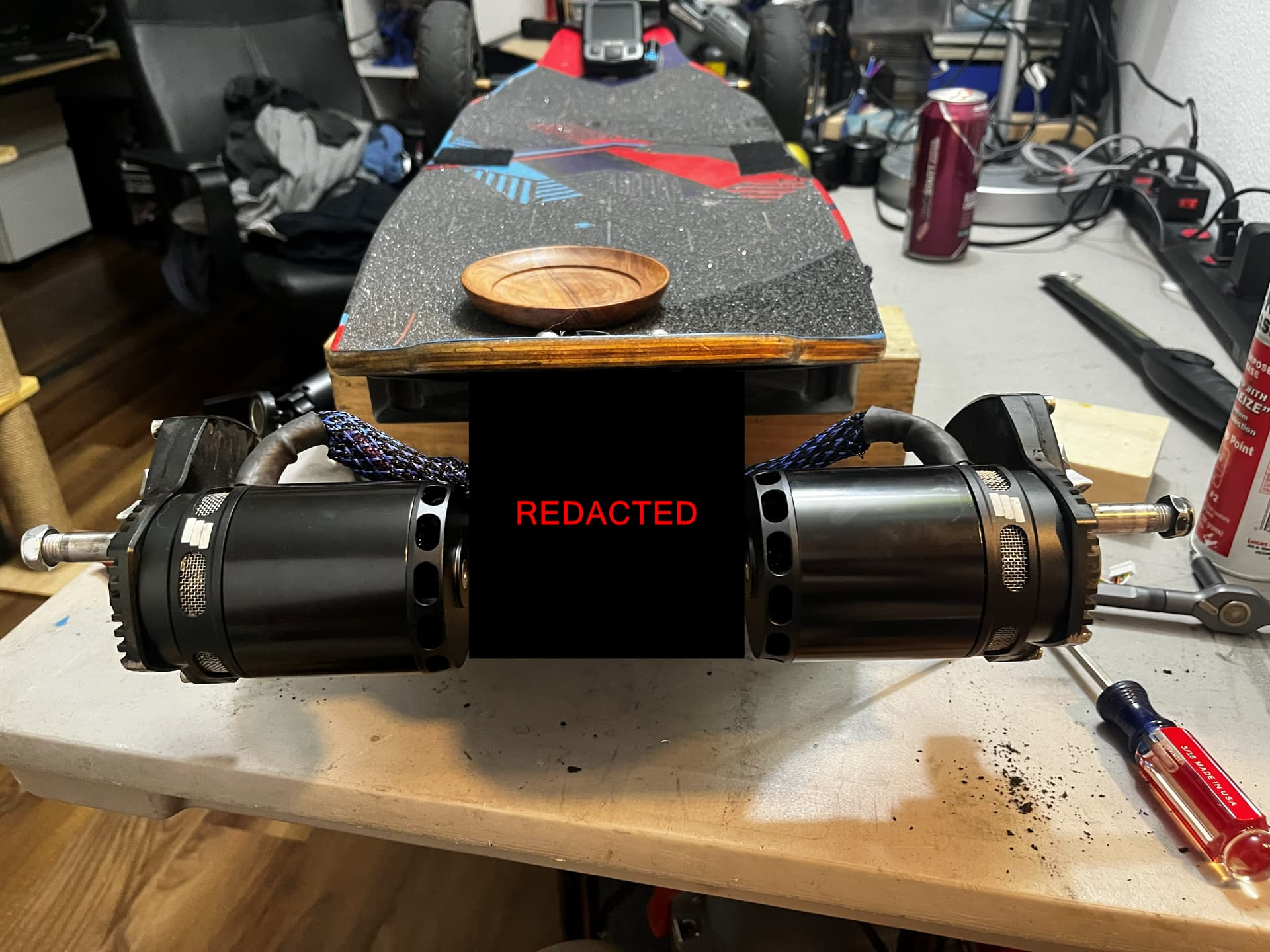

After some casual 8pm angle grinding to cut down the motor shafts,
I loctited the pinions on. I used way more green then previously, and gave them 48 hours to cure.
Bish bash bosh
Internally, I was a lot more intentional with my strain relief. There should be a lot stress on the motor cables now.

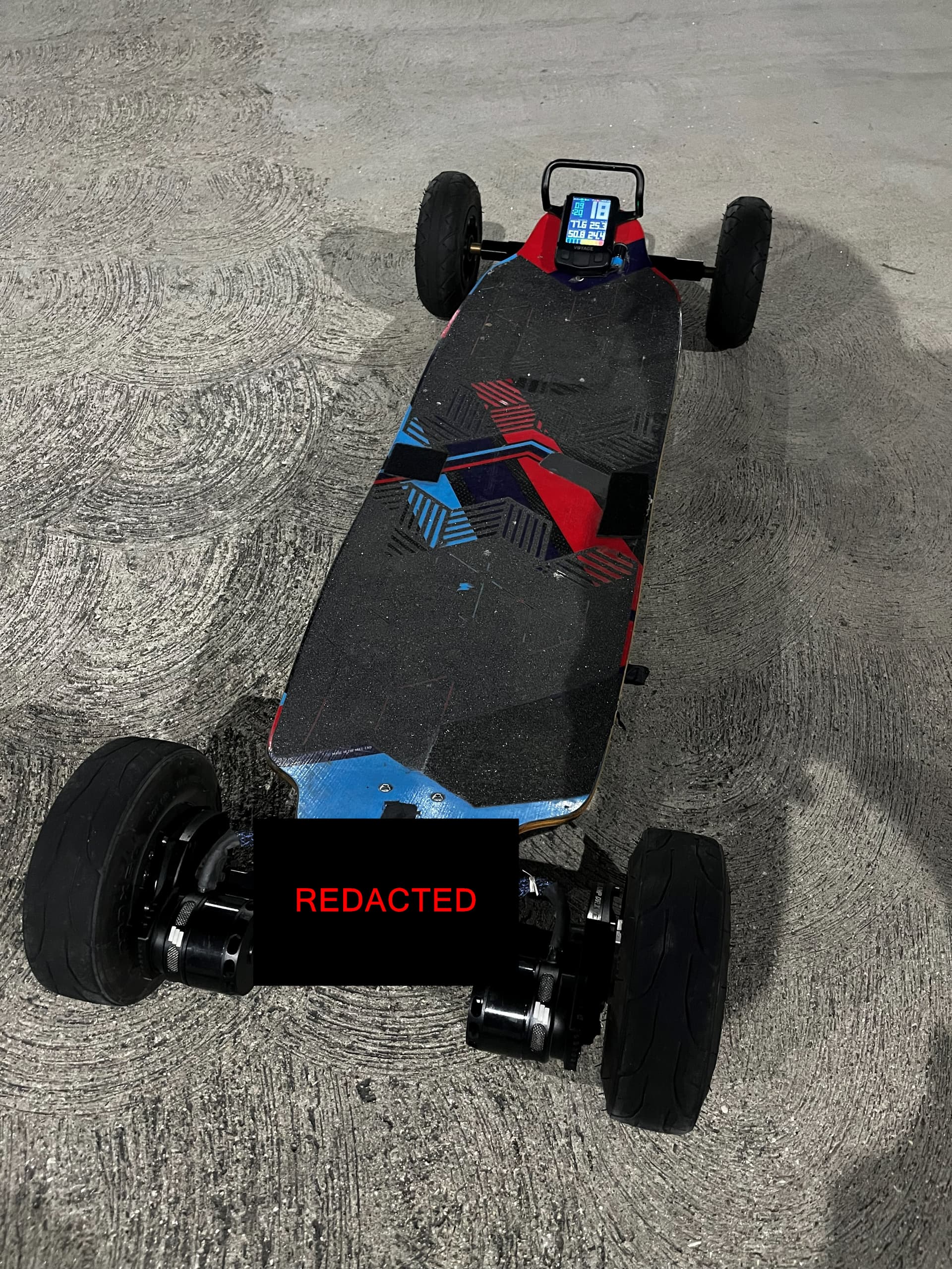

Vesc reprogramming went without issues. I updated the vesc firmware from 5.03 to 6.06, and increased motor current to 120A (lot better then the 60A on 6455s!)
Looking great, hoping she doesn’t throw me at garage tonight.
Smaller motor will throw ABS Overcurrent Fault if pushing too much motor amps. My 6465 Reacher would throw a fault if I accelerate too hard.
