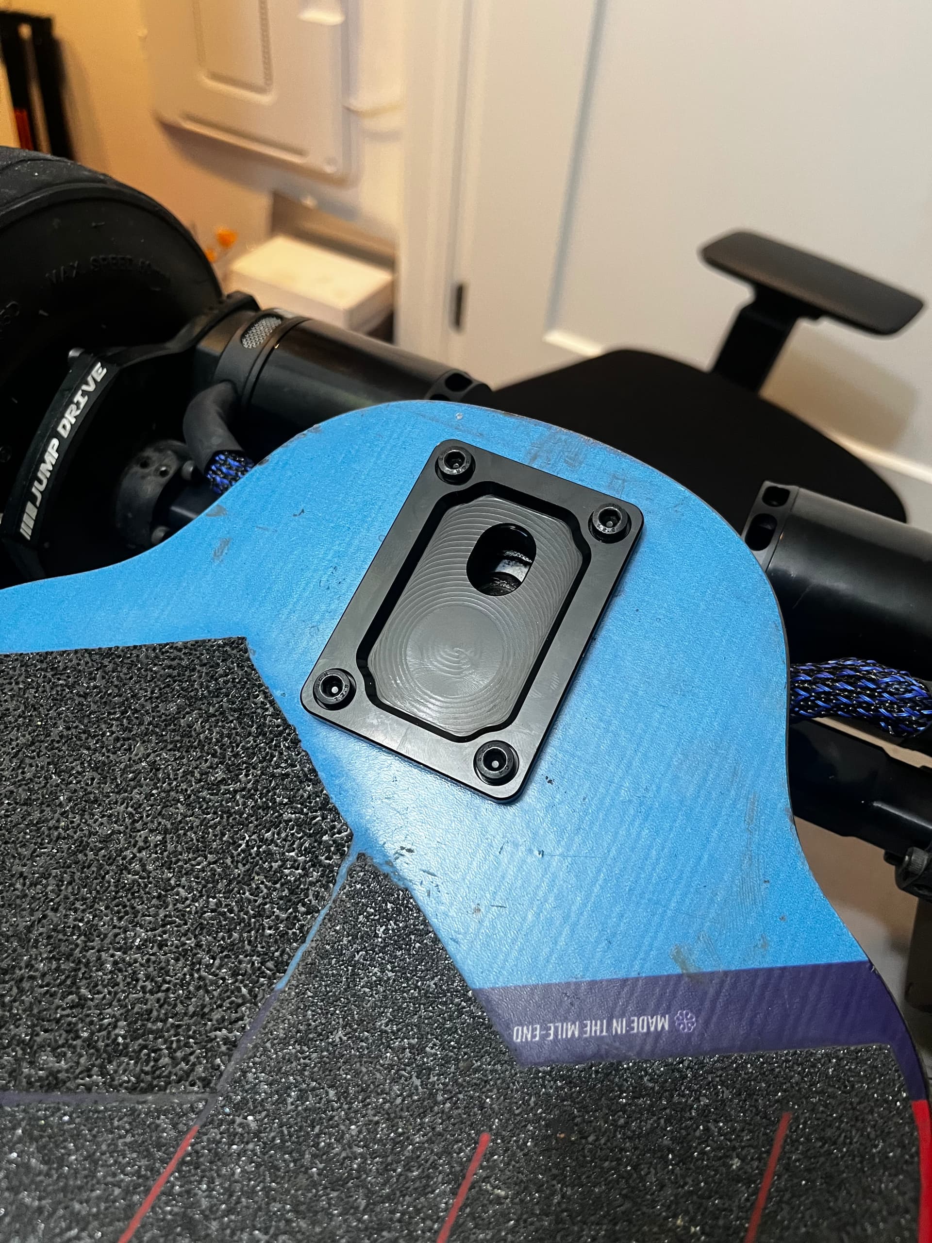

Antisink Plate
@Titoxd1000 graciously gifted me an antisink plate to cover the ugly taped bushing hole in the rear
While I had the truck off, I made the hole… less shoddy. Using a Dremel like a router with a single-flute milling bit.
Then, in favorite technique for covering up bad workmanship, I went to town with a black sharpie.

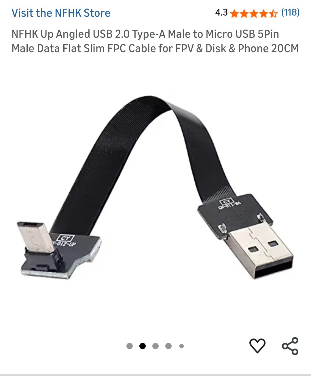

I bought this ribbon USB cable for it’s super low profile micro USB connector
However, it clashes with the CAN connector for the MEGAN.
(additionally, it’s hard (impossible) to mount the USB-A to the outside of the enclosure)

I’m thinking of doing a USB extension like that for my build. Any links for the one you got?
Edit: Nvm, found it.

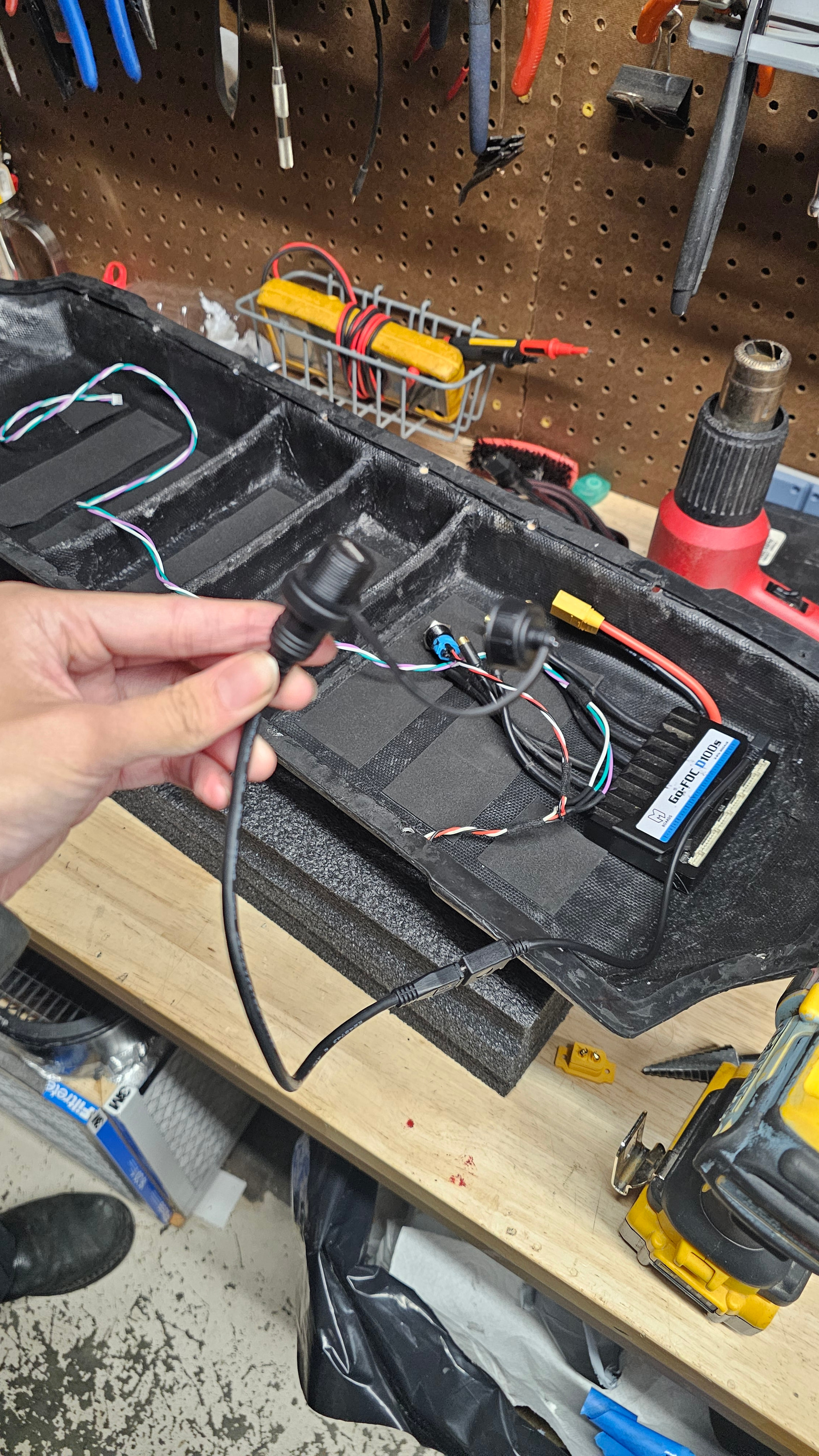

I have External USB’s on most of my Lacroix Boards. External USB’s make it so easy to connect the VESC to a computer for tuning. I just use a regular (cheap) USB Cable and sandwich it between the foam gasket and the enclosure. Never had an issue with water or anything else.

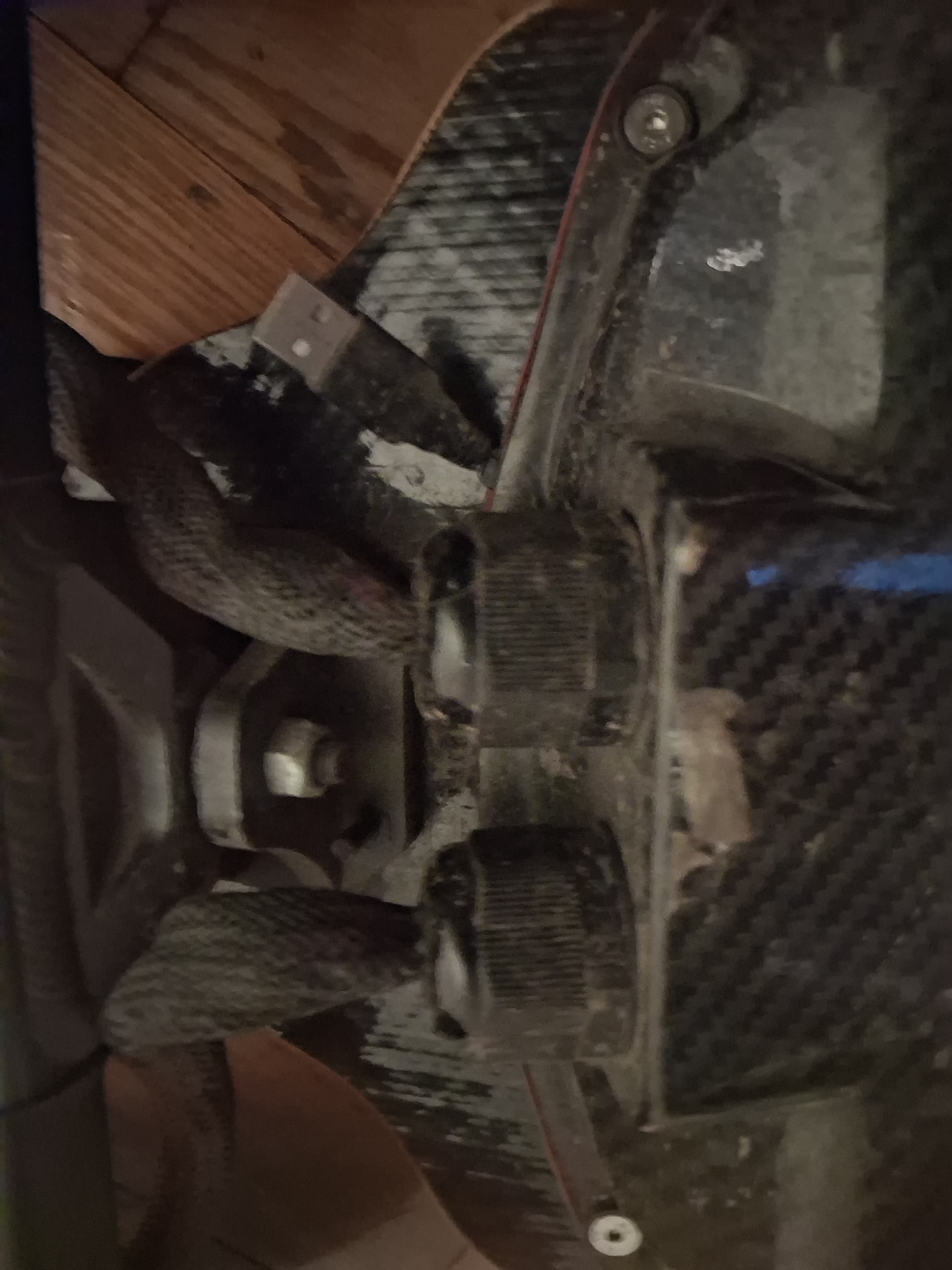

I just ran an extension cable out witht he phase wires.

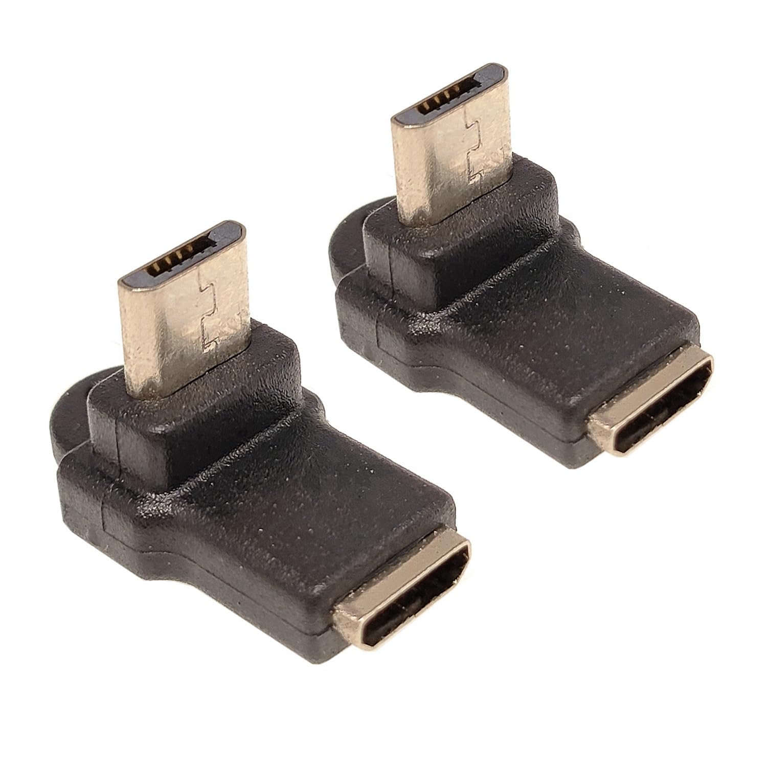

@tuckjohn thoughts on daisy chain this to another extender? There’re multiple version of this.
That’d work, definitely! Used something similar on a drone like a decade ago.
I started looking something like that for nothing fancy, but all the ones I could find would clash with the vesc and/or the enclosure (because of how tight it is in Nothing Fancy)
I’m gonna try to see if I can make these works on mine. My new build is also gonna be tight.

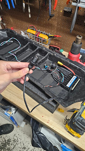

@tuckjohn Update. Found something better.
Panel mount with a threaded cap.
Needed more length so I got a 90 degree cable that works perfectly, does not interfere with the ports, also pretty low profile.
Also have this cable ready fom my new build. Happy to see that somebody already tested it :slight_smile:
It works. I have one in my flux. Saves so much time from having to open the enclosure
Yep I had one on Zelda too in case Bluetooth derped out. Worked great.
Had to test mulitple cables. Some of them only for power and does not transfer data. The symbols are hit or miss if you buy cheap stuff, I’ve tried some cables that has a symbol that it’s good for data but doesn’t work.
