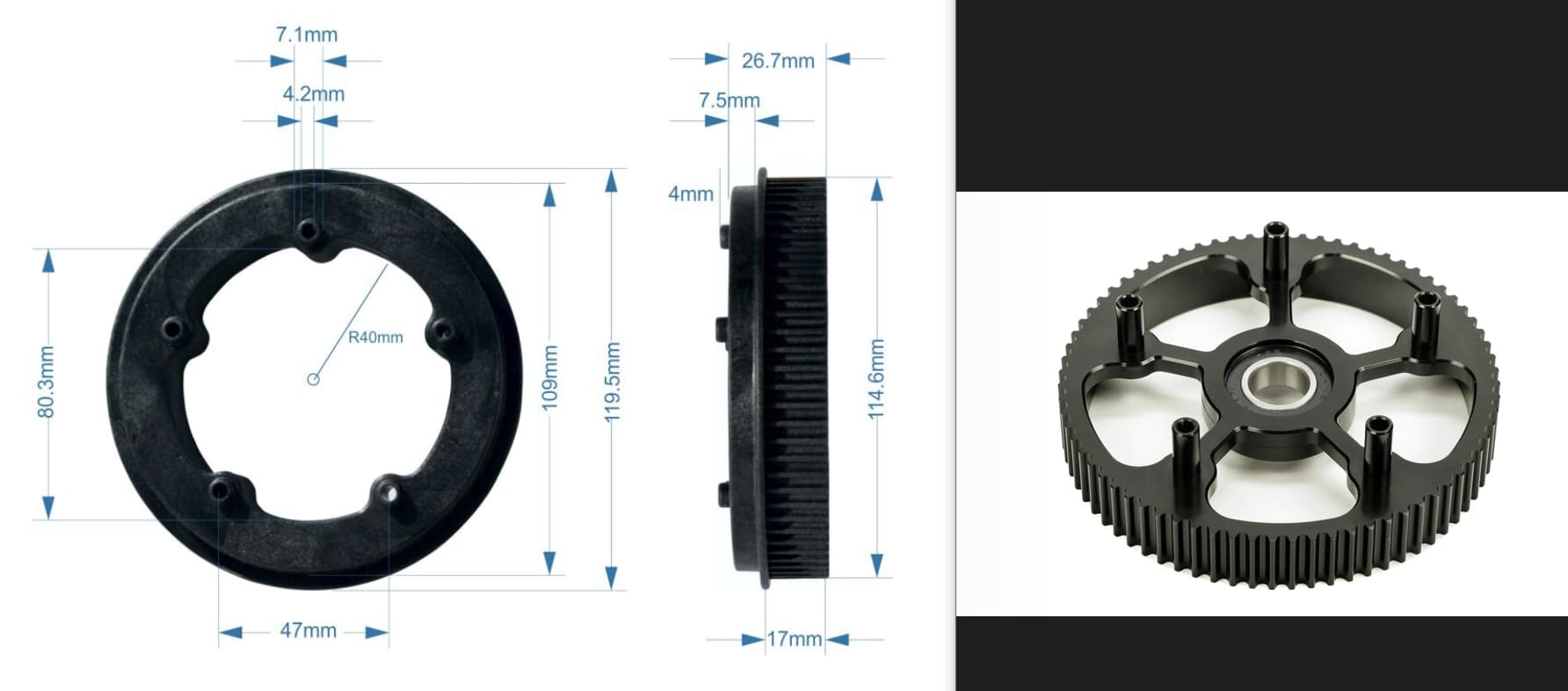

not enough axle length - mbs matrix 2 + rockstar hubs
I suspect it’s the lacroix 72t pulley that has built in spacers that’s making it too long to screw the nut on.
Still purchasing what I need, had these pulleys on hand I guess they don’t work. I was going to buy the $20 MBS 72t nylon pulley with the spacers that don’t come out as much, but I wanted to use the aluminum 72t.

Just move the mounts further in? Or does the lacroix pulley have a bearing?
Usa a pulley that doesn’t have a bearing. That frees up a ton of axle length.
Can the bearing be removed?
the bearing can be removed but I don’t see how that’ll free up any room as the pulley slides all the way down the axle. I guess its the length of the built in spacers that messing it up? I realize im basically asking if MBS stuff works with MBS stuff, but just want to make sure before buying the wrong item

Maybe my caveman approach isn’t for everyone but I would use a cutoff wheel to cut the spokes holding the bearing assembly in place. Then again those do look like nice pulleys and damaging them might not be for everyone.
This way no need to buy new pulleys.

You are supposed to remove the bearing from the 72t pulley if you are using it on matrix ii. You also need to push your motor mount farther onto the truck hanger.
That’s how it is setup on lacroix jaws 1.0 boards.
