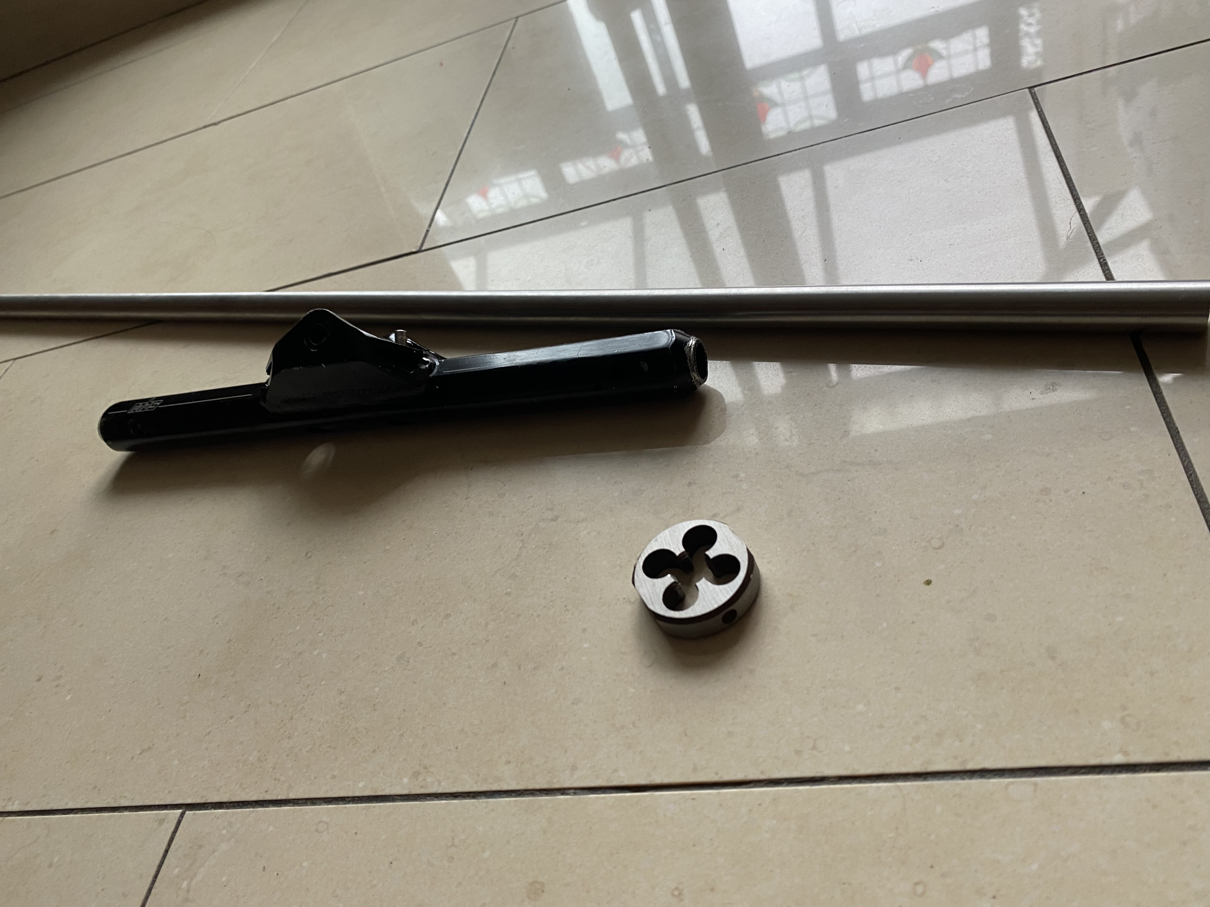

Sorry it’s an old thread but where did you get the longer axles?
I could also make axles and if people were desperate I might be able to ship a set or 2. What is ideal? A couple mm longer shoulder + axle and M12x1.25 threads instead of imperial?

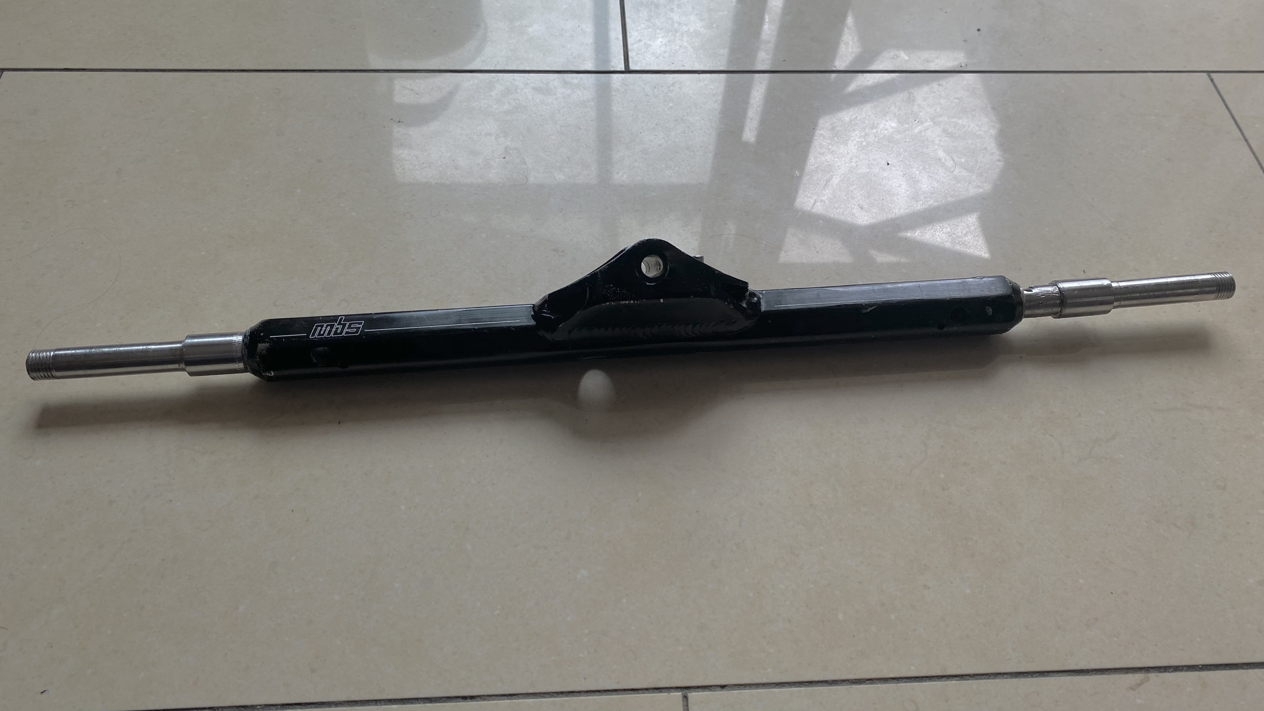

The stock axles look like 9.8mm shoulder, 33mm axle + 12mm of threads. What is ideal?

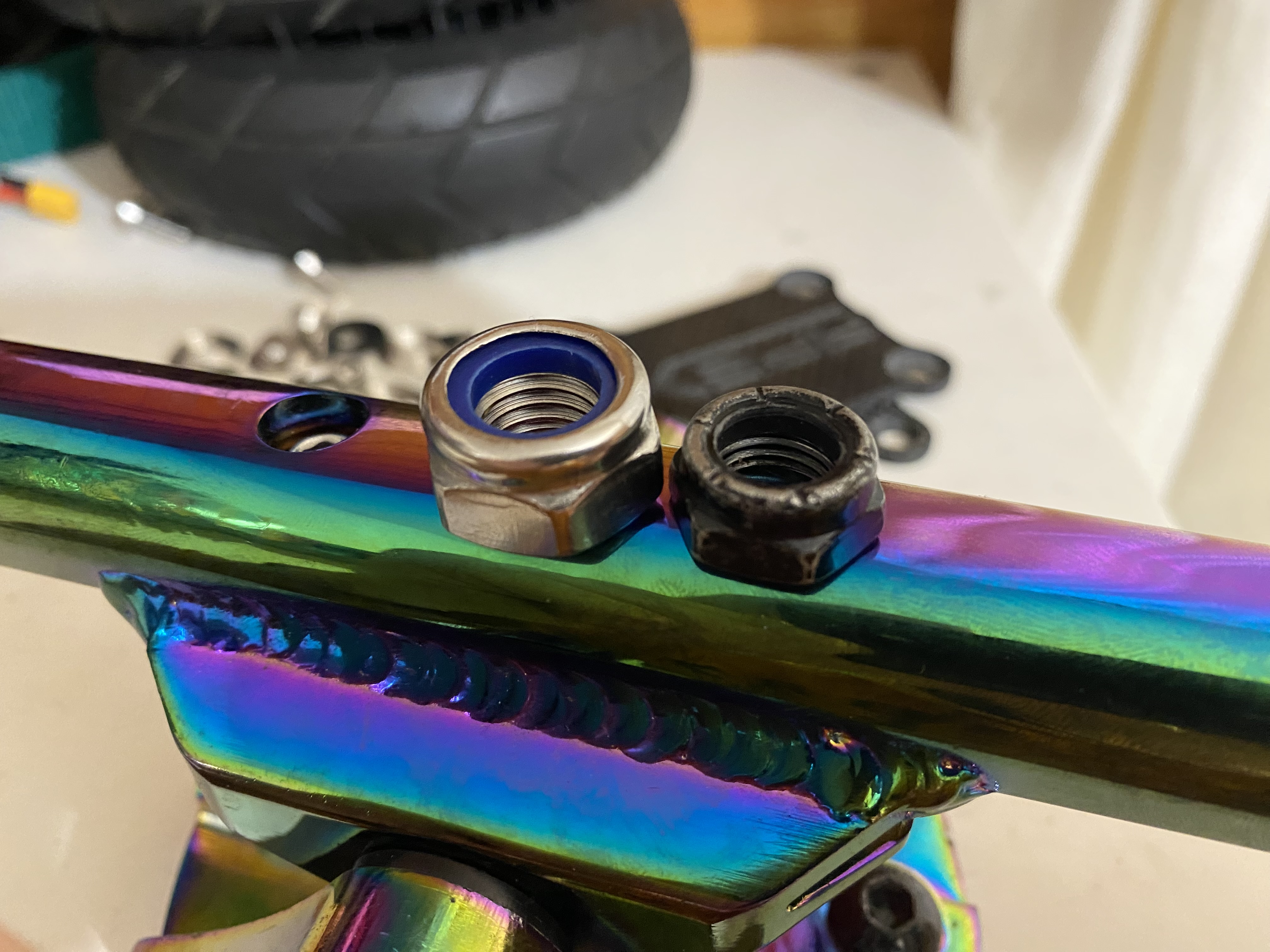

Standard M12 is a pitch of 1.75, I’m planning on M12x1.25 since more turns holding on the wheel is nice. Pictured is standard M12 vs stock Matrix 2 nut. I could try make thinner nuts on the lathe as well.

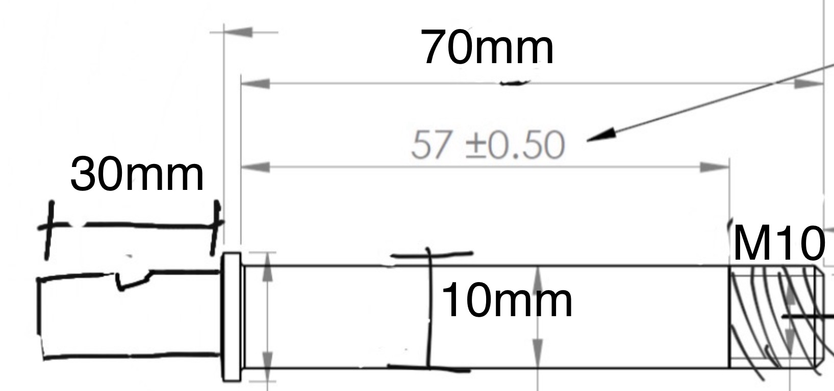

The Matrix 3’s Extended Option is 70mm. I would be up for a set for the Matrix 2’s / even more so, if you could turn them down to 10mm ? I’ve abandoned all hope of MBS actually releasing the 70mm variant in that diameter - I’ll mail you all the specs to not clutter up this thread

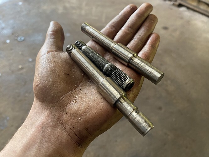

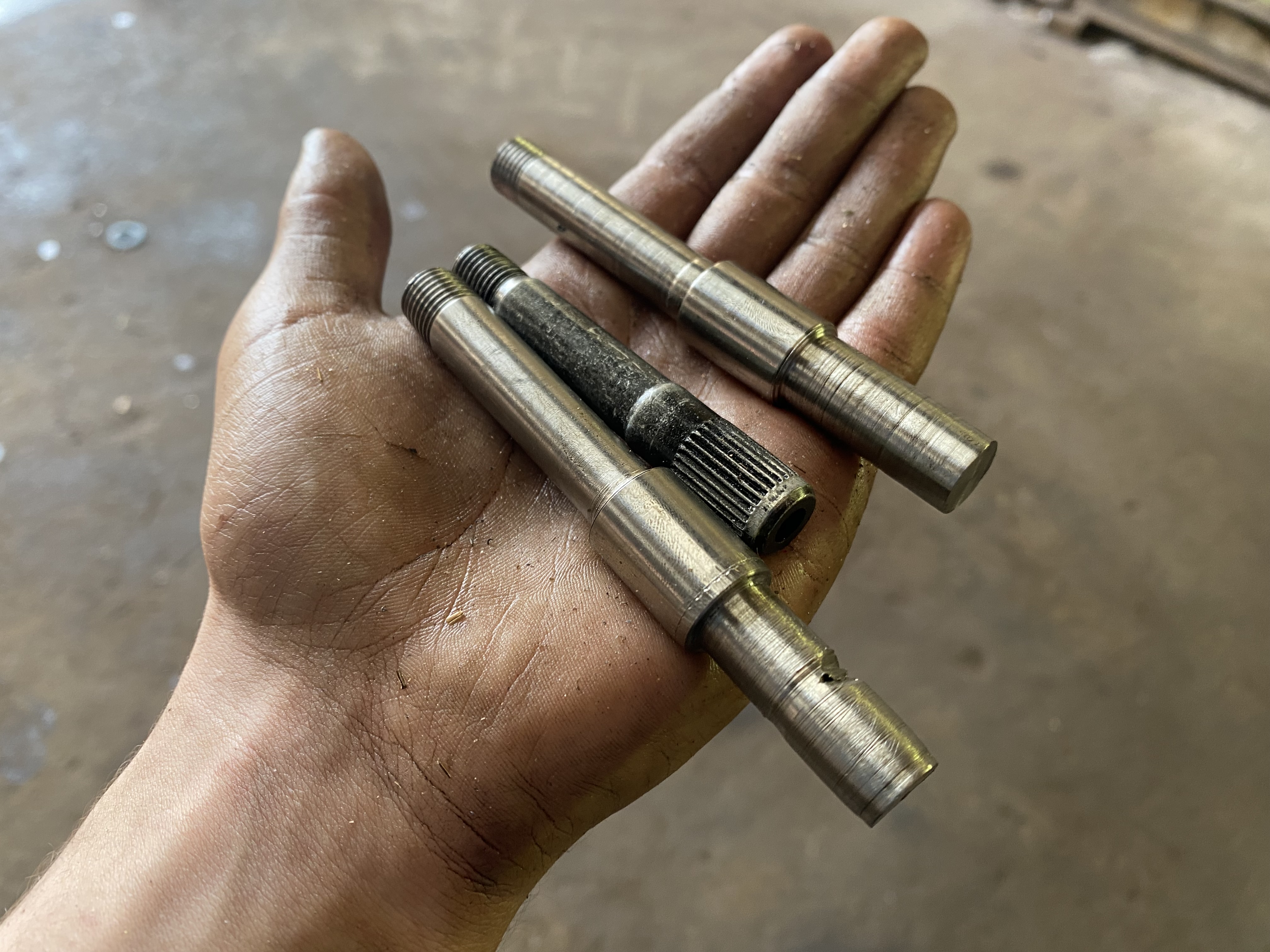

I harvested the longer axles from a set of trampa trucks. barely longer.
They were already cut in half and it made sense. Otherwise, it’s a diameter and thread you could source and cut yourself I bet.

I’ve tried to hand cut threads into hardened shafting and I had a bad time…. Did this work out?
Thanks that actually makes loads of sense for getting the longer axles, no wonder I couldn’t find them online.
I haven’t made threads both that large and on such hard steel but I have some ideas and if I can’t I know a few machinists who I’m sure can help. Last I did was M10 on carbon steel.
