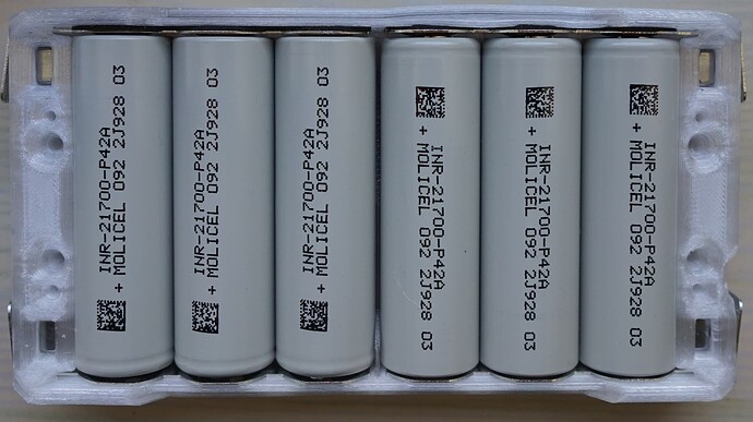

@rusins, have you checked your cell dimensions? Those 21700 are all over the place but all i know off are slightly longer. This is the first time i see this issue. I sold probably in thousands of modules and have nothing like this reported till now.
Could you post a photo with cells inserted of one module? Could you judge how much the black foam is compressed?
Well, I took a closer look at my modules, and noticed something crazy – 4 of the 6 modules are partially deformed! I’m guessing the heat from the arcing might have caused them to expand on one or both sides! ![]()
Here’s a non-deformed module, so you can look at the foam squish:
I measured a few of my cells – they’re 21.4mm wide, and 70.1mm tall. (although maybe they are exactly 70.0mm, since I had to put a piece of kapton tape on them to avoid shorting my cell as I measure with my calipers, lol)
(For the record, my brother’s 18650 nese pack also has what I think are small burn/arcing marks on the cell holder tabs. Just not as extreme. And no warping, or cell disbalance as of yet, thankfully)
The arcing creates excess resistance on the contact surfaces and you get ohmic heating during high amp draws. In time the gap will widen and arcing will increase.

you might think theres a universal standard in tolerances for cells. Theres not.
Dimensions differ alot between manufacturers. Think we have three versions of cell holders for 21700 atm just to pass shake and vibration tests.
Your company has 3 different cell holder versions? Or are you suggesting NESE should do that?

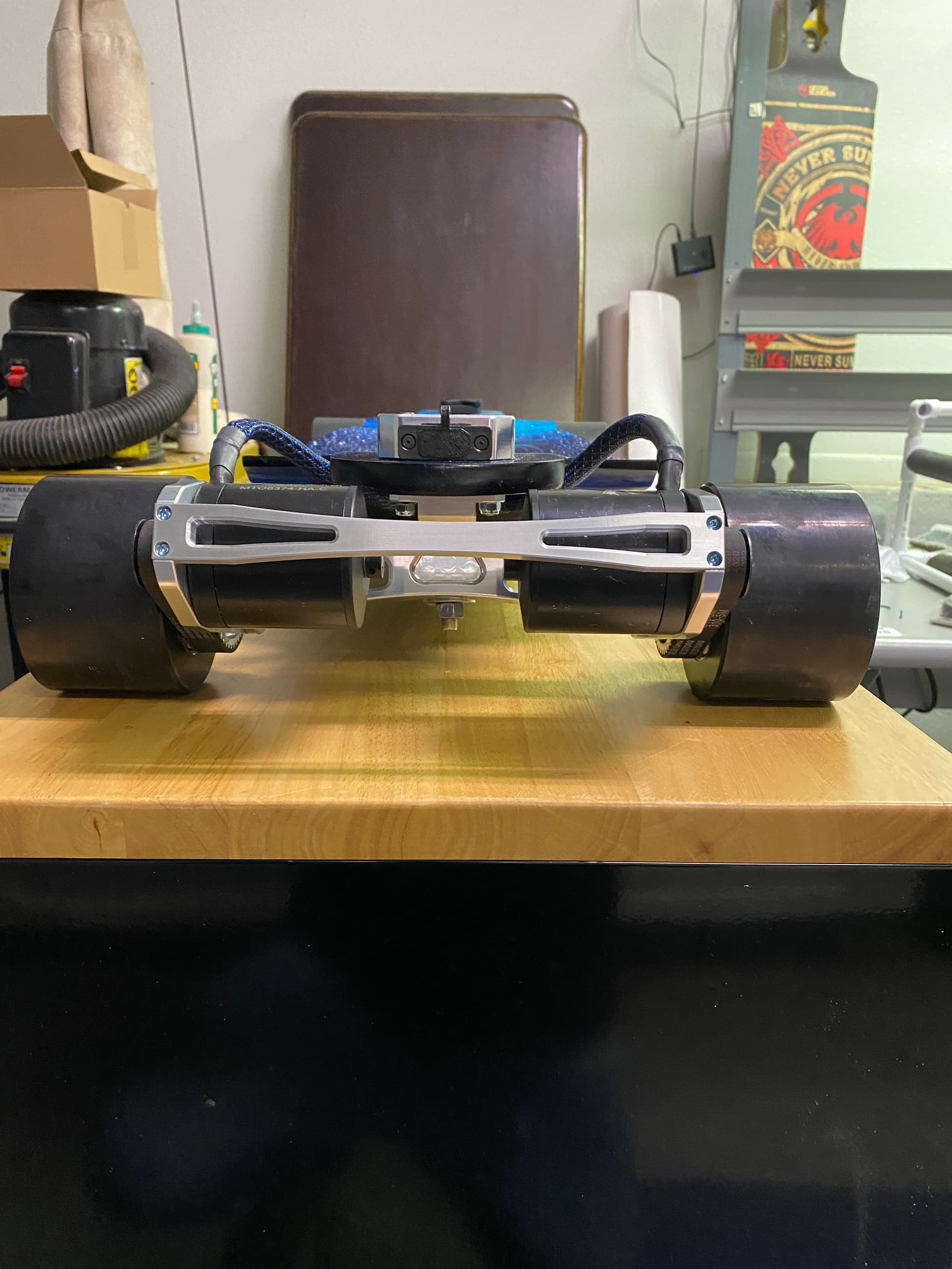

Welp, I hit one of my motors on a small curb and it seems like a magnet has come loose. I think it’s time to call it quits for these gear drives and switch to a different drivetrain.
I think I should be able to drill through the wheel adapter and manage to salvage these green wheels, so I think I’d like to keep this a urethane setup. (God knows I won’t have enough range for group rides otherwise)
Question is what drivetrain do I go for. I’m currently highly leaning towards Savage’s trucks and mounts for belt drive, but I also should test if my regular surf rodz trucks might work as well.
I could also go for an exotic option like direct drives, or maybe Artem’s 3DS drivetrain on 5" Hoyt tires. Although that will likely have the same clearance issues my current setup has. I’d also like to use bigger motors, because I’m pushing my current ones to their limit.
Any and all recommendations welcome!
P.S. Also the LED strip fell off in most places while the board was sitting at home. Need to figure out how to mount it better, because I need that sexy underglow.
@Savage1 Is that the furthest you can angle the motor mounts on a Switchblade, or can they go even higher? Ideally I’d rather not hit a curb ever again
