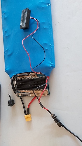

So I have a brand new build 12S5P battery (samsung 30Q)
With voltage screen, BMS and ON/OFF switch.
I just received my brand new charger and the battery does not charge.
Also on the voltage screen nothing comes up.
The cells were bought brand new from NKON and all part are also brand new.
Any idea why the battery doesn’t charge?
@pjotr47
Switch it on when you charge it.
Yes the switch is in the “ON” position @Dareno
Still not firing up hey? May need a few more detailed pics of the wiring then. Do the obvious and check your charger is good first though. Get a multi in there
I am talking about the board not the charger when I say switch it on in case that was unclear and you thought I was being a dick. That bms needs to be switched on when charging
