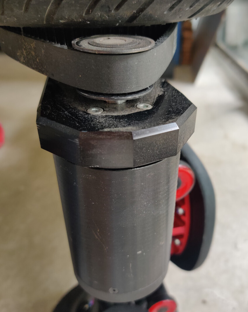

i have a belt slightly to tight (not much free roll) and squeeks a little when turned
but still has some flex and can be got on and off easily
best solution
bolts loctited in place so a bit of a pain to remove

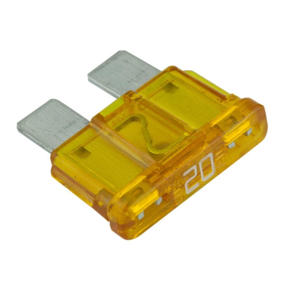

found a pack of these in my car, is this an acceptable way to fuse my charge port?
yes, those are pretty common. Just make sure it’s specced properly for your charger/battery
