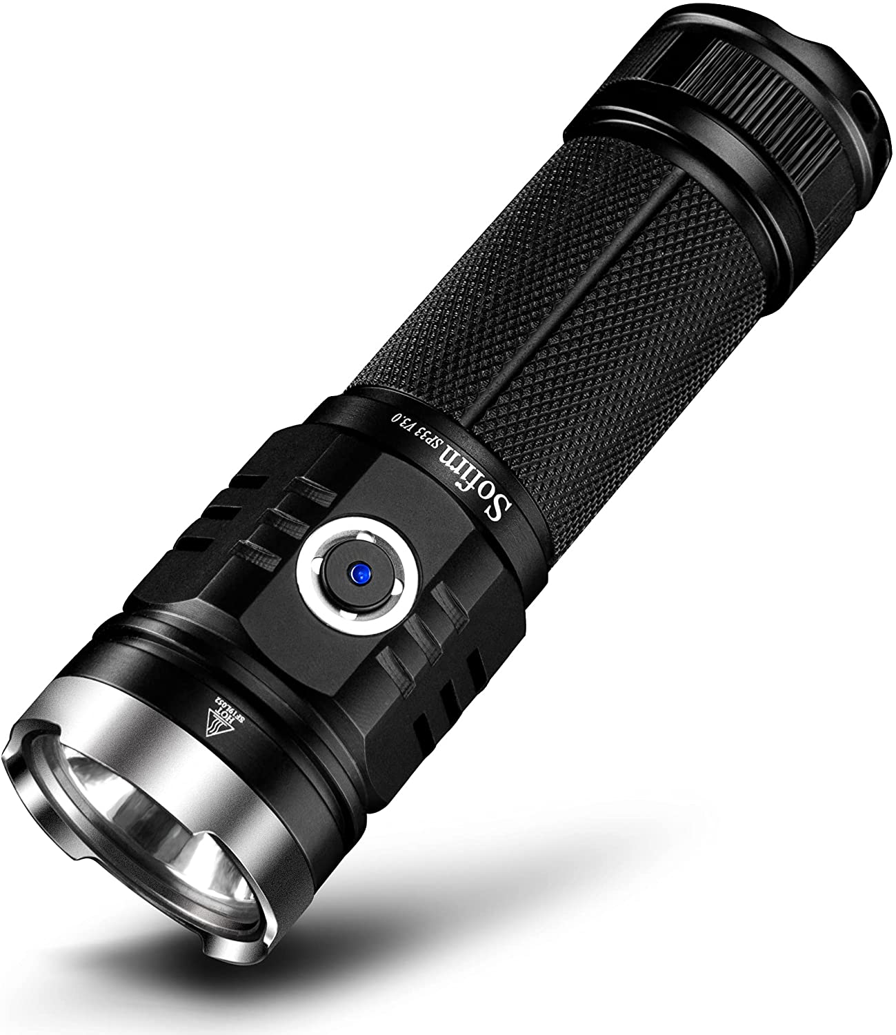

convoy s2/s2+ or s21A for use of 21700 cells.
If you want it brighter get the astrolux ec01. (can take both 18650 and 21700)

I run this guy just in my hand, but is as bright as a spot light. Small enough to handle, but quite powerful.
