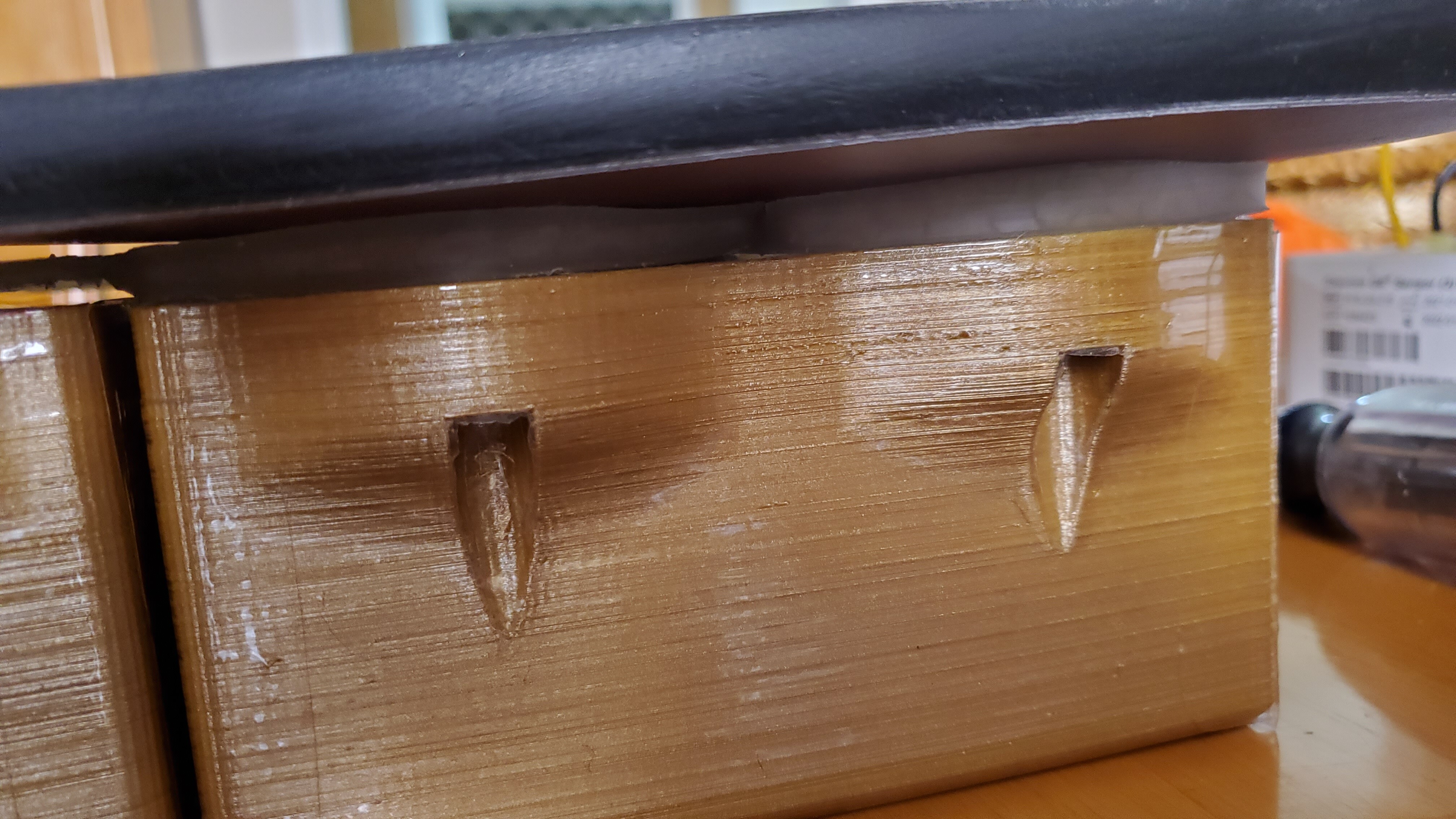

I testfitted the parts on my board while waiting for my battery. Found out i needed a riser.
Took of the rear truck. Then tried the front. But one bolt was fucked. The nut didnt move. Like it had seized completely. Had to use wisegrip and small ratchet. when the bolt finaly got sheared right of i could see this banana bolt. It was completely fine and brand new when i mounted it. Wtf could have made the nut to seize on the threads, and make the bolt bend like this. I didn’t overtighten as this was only test mounting of the parts.
Stainless steel is notorious for galling and micro-welding itself together.
Firstly, I usually recommend not using stainless fasteners, because they’re softer and weaker than their steel counterparts - more likely to strip.
If you MUST go stainless, then I recommend adding some kind of contaminant to the screw before installing it. Just about anything works - Loctite, oil, grease, cheez whiz, you name it. It will keep the two stainless surfaces from bonding together on the microscopic level. It only takes a tiny amount - I’ve even just rubbed a finger on my nose and used that skin oil in the past when I didn’t have anything else on hand.
Thanks. Didn’t know this.
I’ll get new bolts tomorrow. These were too short anyway now with the 1/2" riser.

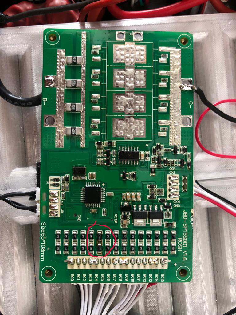

hey guys, i just blew my second smart bms with some Front IC Error shown in the app.
any idea what would be causing this ?
the wiring is correct, both worked for a while and then went out during ride
there are maybe two reason which caused this unexpected problems : 1) with wrong connection order with balance wires , you said it works normally after a few week , so the connection reason can be excluded . 2) your cells connection has meet problems ,such as the nickle strip broken with your battery ,or cells group meet a weak connection problems . this will has the possibility to damge these resistor . please check it carefully and let me know the result

Mentioning that it happened while on a ride would tend to point me towards inspecting how the wiring is run
It seems like possibly a short across some groups happened. How good is your balance wiring? Can you share some pics?
