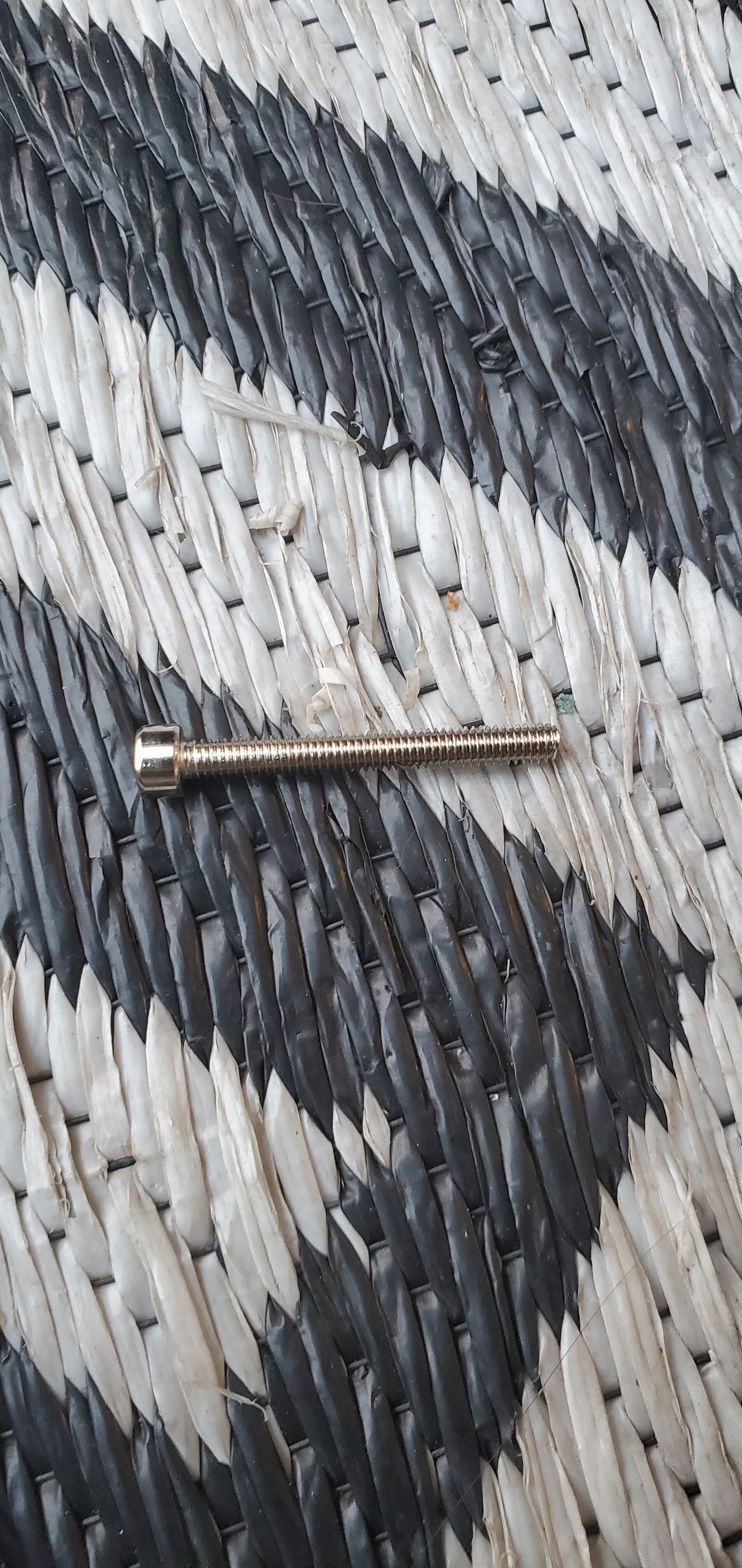

I’ve got a blank. What size are MBS hub screws?
VESC 4.12 are difficult to heatsink because the FETs dump most of their heat into the PCB and not the accessible part of the packaging.
Somewhere around 25A battery max is a sweet spot for those, I personally wouldn’t go beyond that
Search keywords Hoyt puck firmware update upgrade
If you have calipers you could measure
Don’t 100% quote me on it but I think the default ones are M4 x 45?
Either that or the english equivalent
I agree @Cyanoacrylate measuring is a better idea

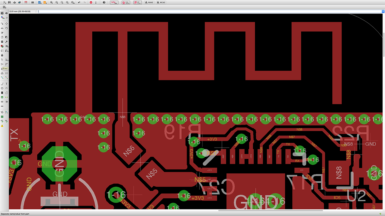

What are my options for external antennas? How do antenna wires work? He’s currently using a mini remote, so could I just solder an extension wire to the already existing one, and route it to the outside, above the deck? Or do I need a special antenna / short wire / certain wire length to be able to catch the required radio frequencies? Maybe I should just place the whole receiver on the outside in a 3d-printed box?

The two most common types of antenna you will encounter in consumer electronics in the 2.4GHz range (wifi, bluetooth, our remotes, lots of things) are PCB patch antennas like this:
or an external dipole antenna that looks like a simple wire, either with a different-colored end, or maybe a little fat thing, like this:
You can’t really do anything about a rx with a PCB patch antenna, unless you get lucky and it also has a plug for an external, or you feel adventurous enough to sever the antenna trace and add your own.
Unfortunately, you can’t just extend the wire on the external antennas either. The black (or dark gray) wire is actually a miniature coaxial cable: One central wire, with another tubular conductor around the outside of it, with insulation in between, in a carefully tuned arrangement.
You can’t just extend the little light-colored wire on the end either, because it has to be a specific length to work - 1/4 the wavelength of the frequency being used, to be exact.
Some receivers have a little connector on the PCB that the antenna mounts to, and some have the two coax conductors just soldered right on to pads. In either case, you can order an extra-long antenna premade from the usual scumbags, with or without a connector, and swap the short one with it.
Another option is to get another piece of micro coax cable (dead laptops are a great source, they generally have two pieces at least a foot long each going up the screen), and carefully splice that onto the existing antenna.
