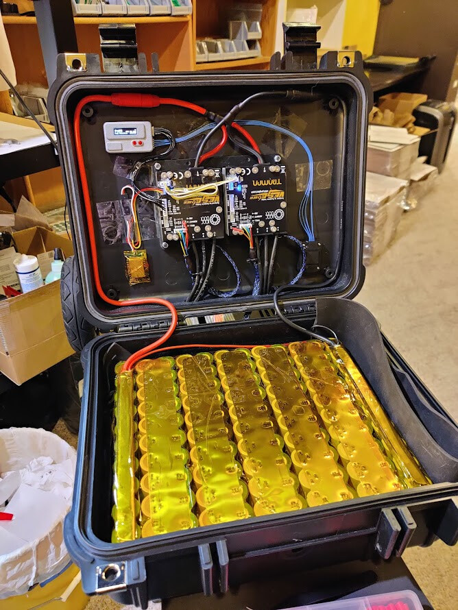

How do people typically secure their vesc’s inside of their top mount enclosure on MTB’s?
Is this amount of wiggle room too much for truck screws?
I used Velcro. Dual Lock is probably a better option since that should have no flex, but Velcro absorbs vibrations a little better.
If you aren’t able to use velcro due to mounting surfaces, or don’t want to use screws, you can also use the compression of high quality foam to keep it in place as well.

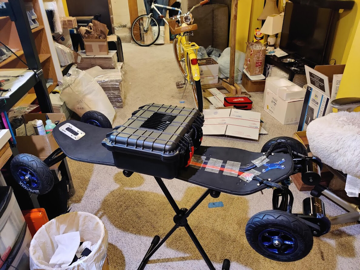

So do you just stand on the cables?
Also why is everything you build so neat and organized.
The only thing I might worry about would be heat if it is mounted with compressed foam.
Yeah, it depends on what type of foam it is
For neoprene it won’t start to melt until like 260C
It’s a fire-resistant material to begin with

Not everyone owns a router with a 1/2" bit. Just wondering what holds a 20lb battery in place when the board is upside down.
