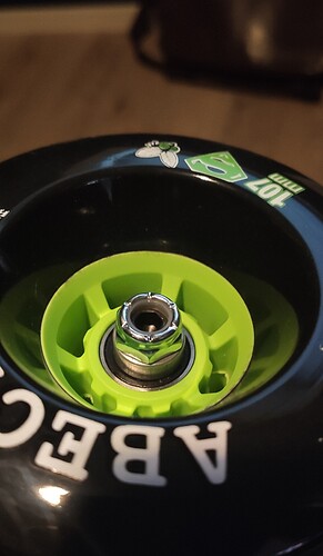

Can i use a spacer like this behind the wheel nut? Or is this a nono. Also. Do i need washers? Or is it ok without. :slight_smile:
You can, but there’s no real reason to use such a thick one on the outside, just use a small shim/washer between the outer wheel and nut.
What’s more important is that you have to make sure the axle is threaded fully through the nut.
There is, because when i use 8mm spacer towards my geardrives, and try to tighten nut, i get to the end of the threads, and theres still a good gap between bearing and nut.
i’m out. Not messing with someone elses Geardrives. No idea what spacing is needed or required to not cause a meltdown.

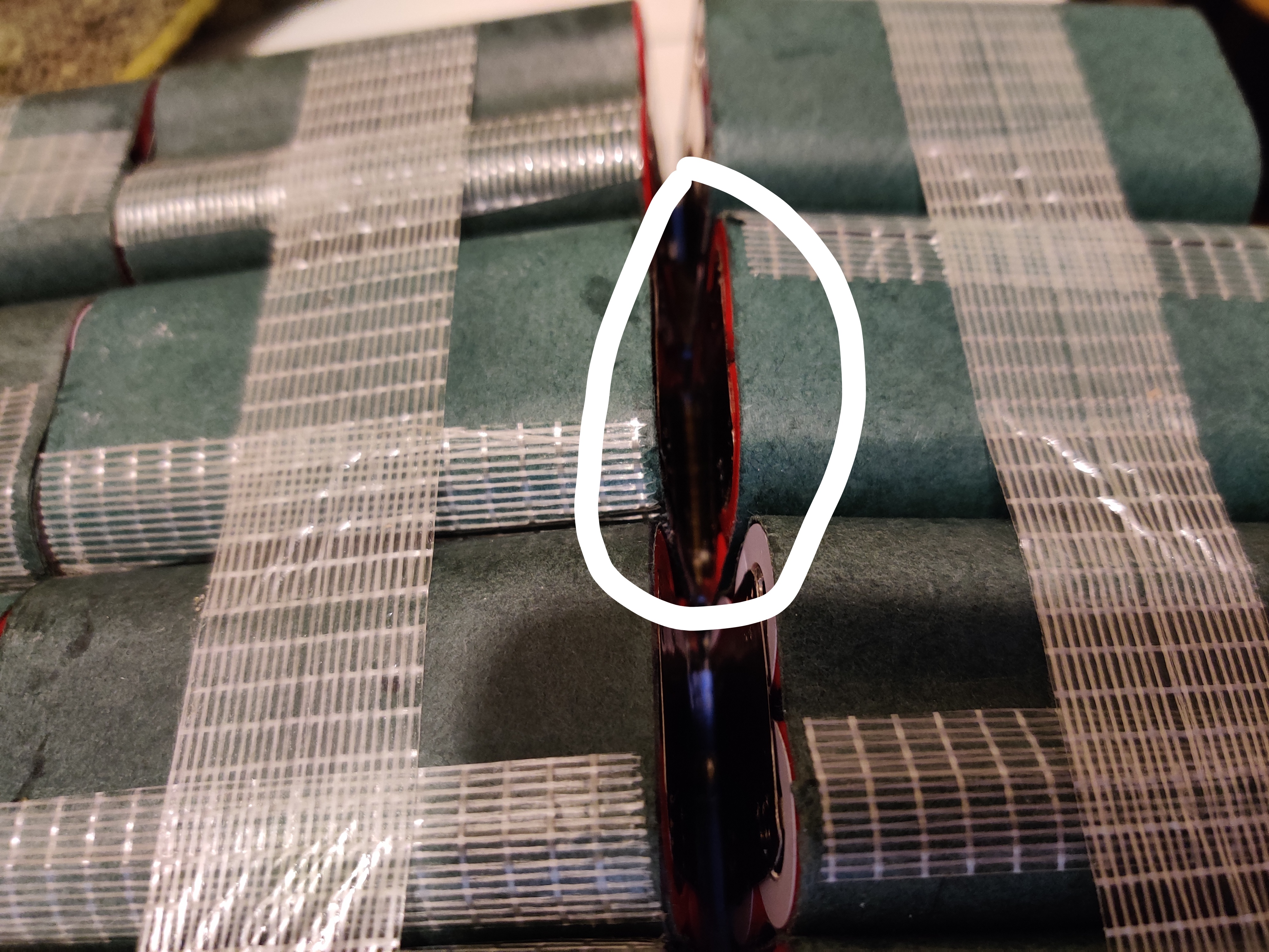

When I have flux stuck in the buttcracks of my pack, is it something I need to clean out? I already got as much as I could, but the rest just doesn’t want to come out. It’s hard to see the flux here, but I’ve circled where it’s located :
*Im using SRA soldering paste
I believe you might have to. I’m not entirely sure myself though. But a cleaner pack would be the ideal.

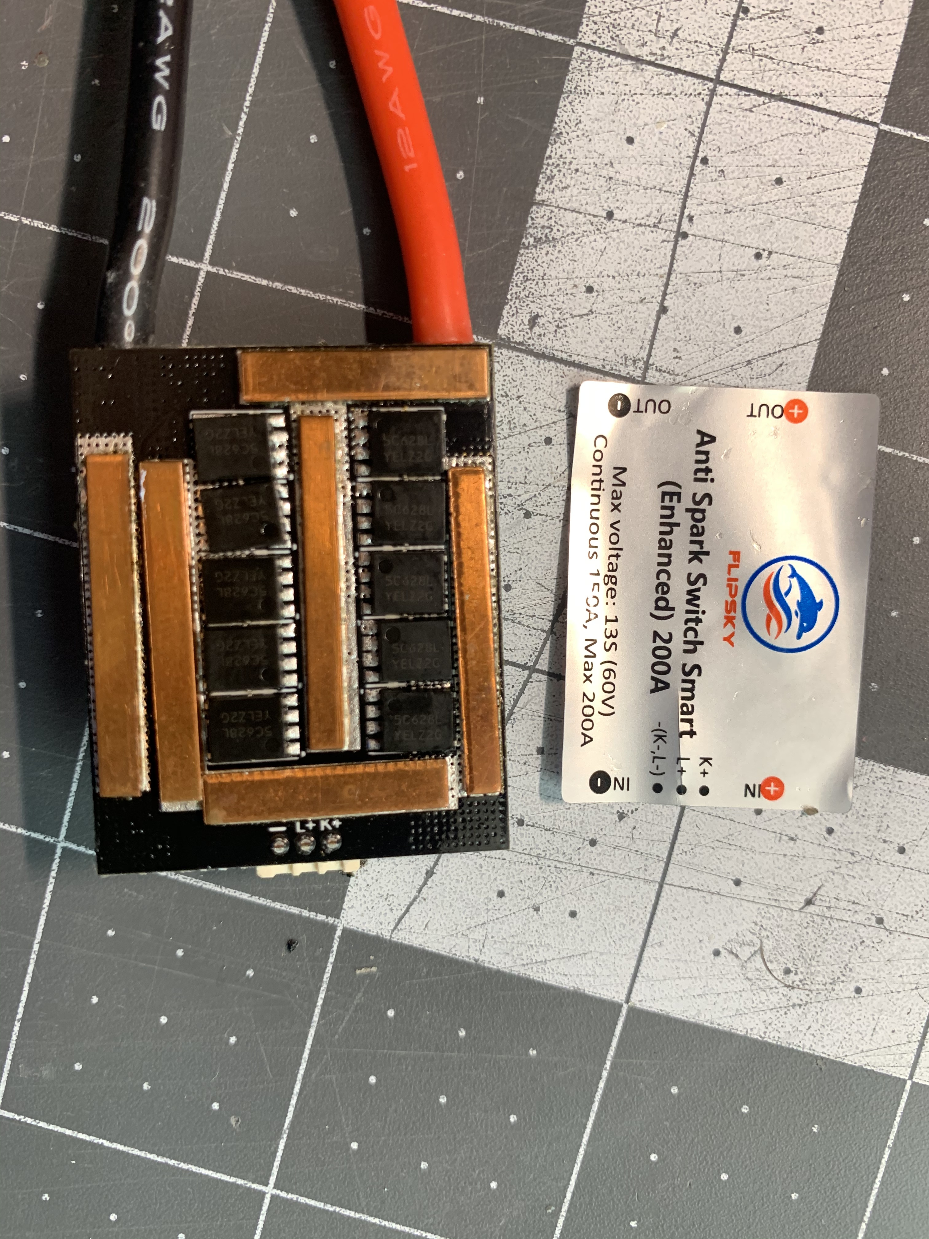

Should I reflow these FETs? Those two on the bottom left are mega crooked… I haven’t turned it on yet, I was just swapping power wires and I discovered it.
@Gamer43
Yeah you might want to reflow that lol.
