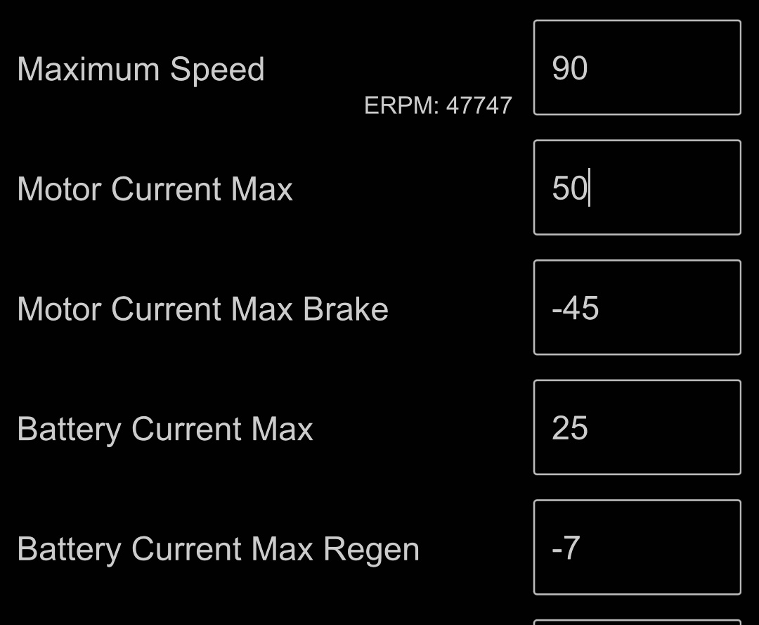

So i just had a potentially dangerous behavior happen to me. I was going down a hill quite fast, on the end of the road i applied the brakes but they were suuuper weak basically doing nothing up until i hit a certain speed where they then kicked in.
Any ideas?
Did i maybe surpass the regen amps?

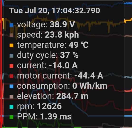

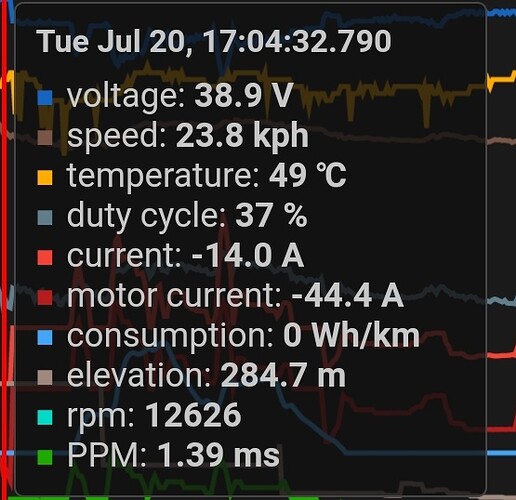

Will post a metr log when I’m home.
Update: seems like it was the regen amps. I just reproduced it on a steep hill. Once the battery amps hit -7 the strength of the brakes weren’t increasing even if i pulled further.
Edit: As it should obviously (just to clarify)
i thought that’s normal? since the regen number is the highest amp the esc allows current to flow back into the battery
I had this issue as well. It’s the regen amp unfortunately. Certain esc makers will limit their regen according to battery’s max charge current to avoid over current. I learned that after using hobbywing escs.
Yes it is. I just wasn’t aware that I’ve already hit it so i tried to figure out what it was.
Gotta be honest, that sucks. When pumping 14 amps into your 2p pack isn’t enough to bring you to a stop in a dire situation. :exploding_head:
