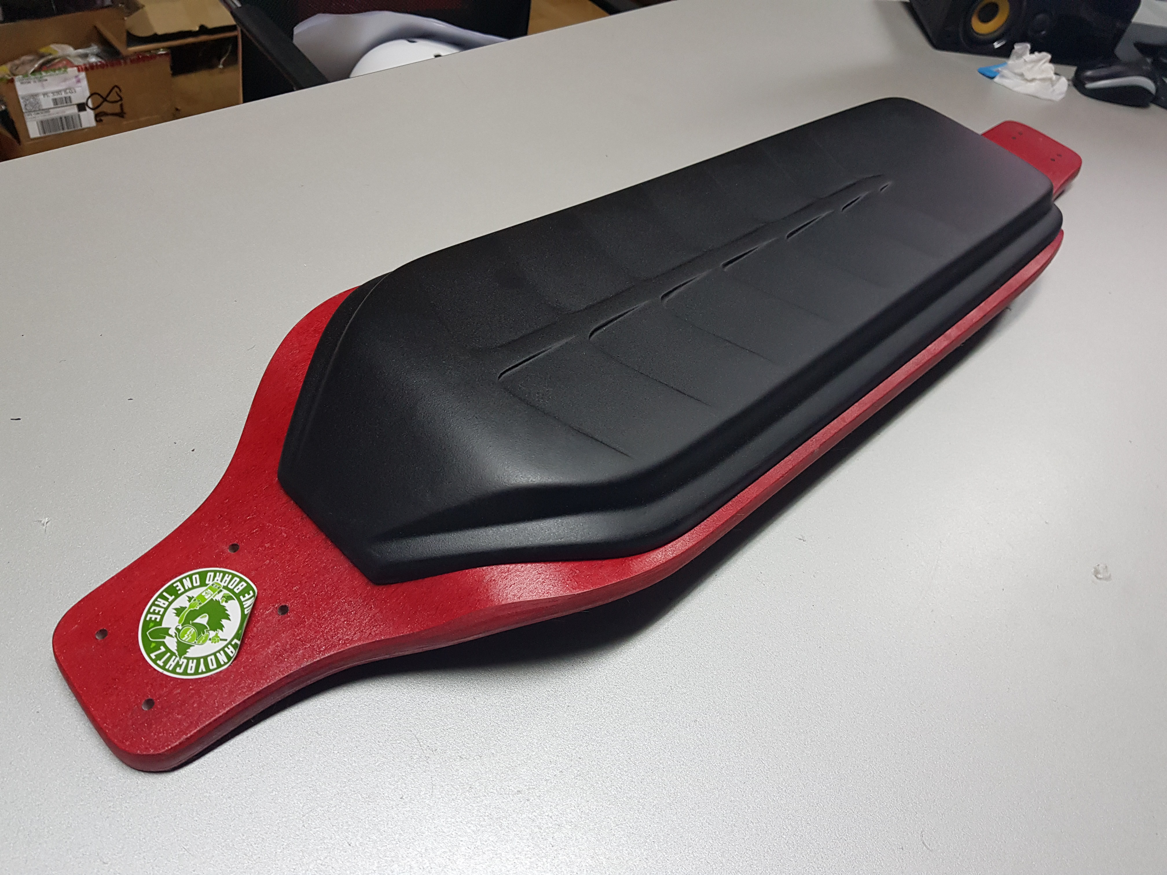

For battery I would suggest getting this commissioned from someone reputable on this forum. You really don’t want to skimp here at all for safety as well as performance. For enclosure, you could also look into Eboosted - https://www.eboardsperu.com/product/landyachtz-evo-falcon-enclosure/
check this thread for battery builder: [WIKI] Trusted Battery Builders (Serious)
and for enclosure, what @DKAY said, or if u want, @tomiboi also makes beautiful integrated decks

I’d recommend the Evo 40 so you can get this enclosure. I have an evo 40 and this enclosure, and its great. Deck and enclosure are the first two things that you gotta figure out, and cheaping out can screw you over bigtime.
Single stack enclosure (12s4p max)
Double stack max 12s8p
Eboosted has an enclosure for the 36" too, no?
not sure if the evo falcon is the same as the spectrum 36, so I didnt mention it. If theyre the same deck with different finishes then yeah
